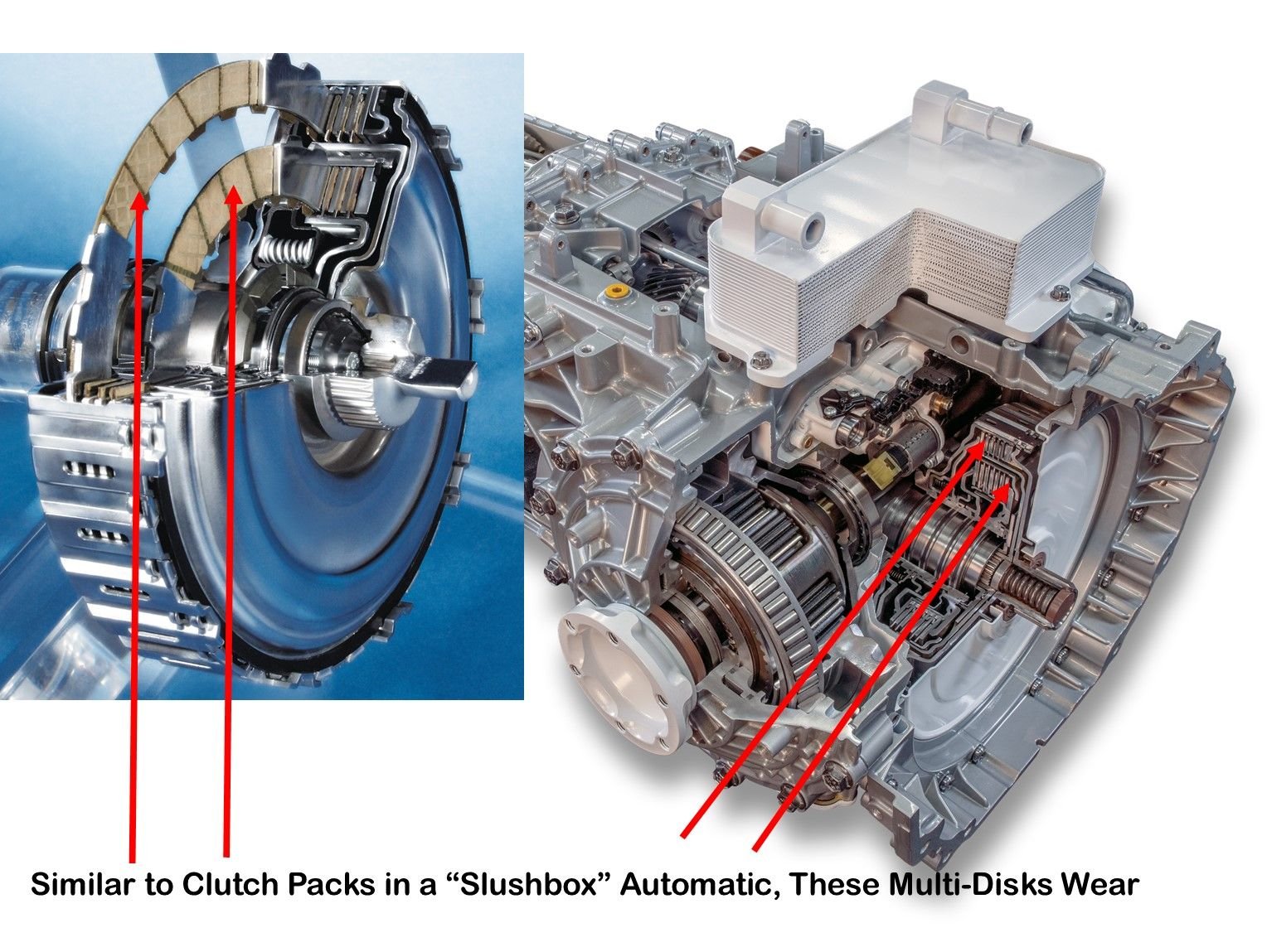

One of my key reasons for changing was the somewhat jerky motion (not that bad but noticeable) when crawling at <4 mph up to about 800 miles when I crawled into my garage. Did that with my C7's (standard shifts) and was careful with my last a Grand Sport as the rear fenders are wide and I often am not pulling in perfectly straight as I have to turn 90 degrees from the driveway and make a "K" turn to do that. Rear fender even on the C8 can get close as I control the driver's mirror tip to wood garage door molding from 1 to 2 inches so there is plenty of room on the passenger side that is harder to judge. I often stop before proceeding at a crawl.
But after that 800 to 1000 miles, it's perfectly smooth. Lots of disks on that multiplate 1st gear clutch to wear in. It's also slipping at Red lights etc, but suspect with less applied pressure. Expect most wear on gears, synchro cones, **** forks sliding on rods etc is probably over at ~1500 miles. Don't know what's magic about waiting for 7500 miles BUT since GM say I'll do it. But lots of folks tripping CEL's and dealer doing a flush per GM recommendation. Some doing it 3 times and it often solved the issue. My "guess" is GM is realizing the DCT has some initial wear issues. Expect them to still say change at 7500 miles as well. I'll have about that year 3 on my then 2-year-old filter.
