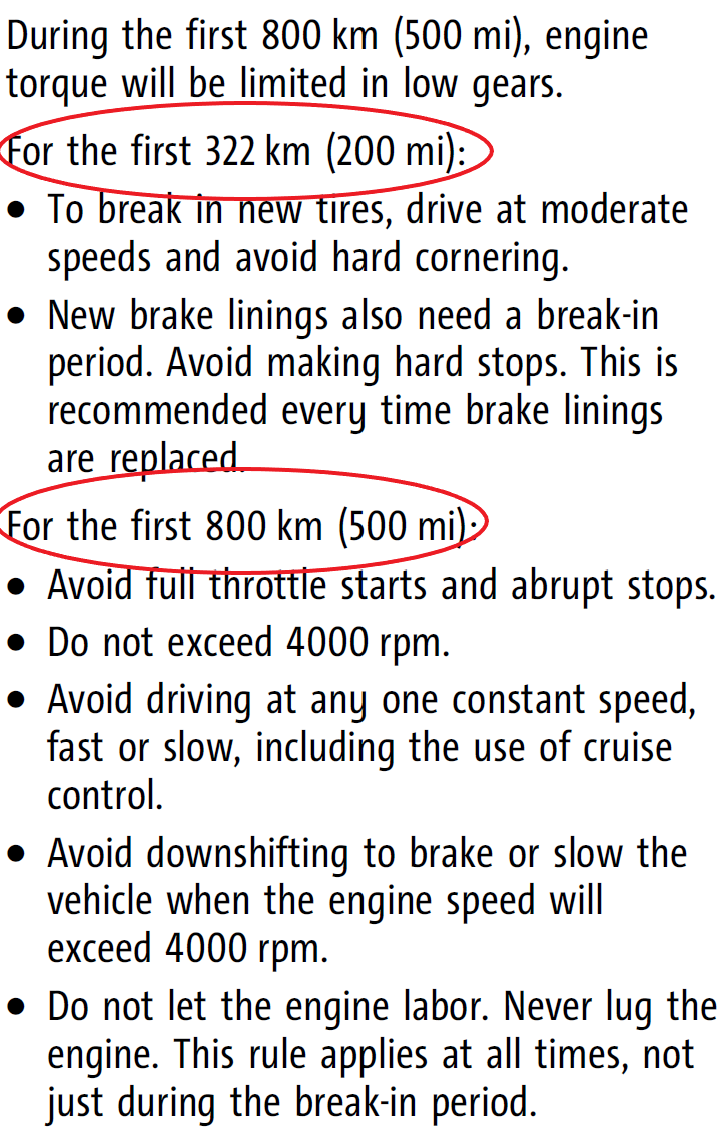

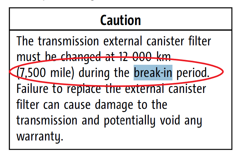

As for "how far outside the break-in peridod" it depends on which break-in period you are thinking about. The break-in period sections starts with a statement that the period is 1500 miles (see clip). Then it breaks it into 200, 500, and 1500 mile periods (as most know). But it also seems to imply that 7500 miles is the break in period for the transmission, in the context of the filter change (see clip below from the 2023 manual that says that).
First, here is the mention of the 7500 mile period:
And, here is the first sentence in the section on break-in, that appears to say the period is 1500 miles.
Here are the 200 and 500 mile periods:

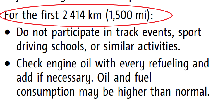

And, finally the 1500 mile period for "track events" and "similar activities":

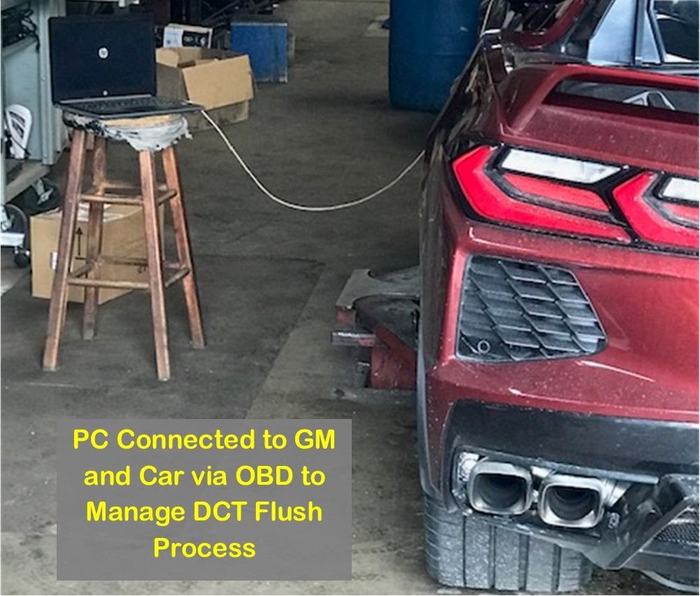

Not confusing, your tech is right! My tech showed me the GM procedure on his PC when he changed my DCT Filter last August. It said before removing filter do a DCT flush. It will wash any debris (in the ~14 DCT valves etc) into the filter and filter housing before replacing the filter and removing fluid from the housing.
He connected to my C8 (with engine running) and the GM Service Computer with his PC via WiFi. Program did all the work. Heard "things" happening as we watched for ~10 minutes then screen said "Flush Completed."

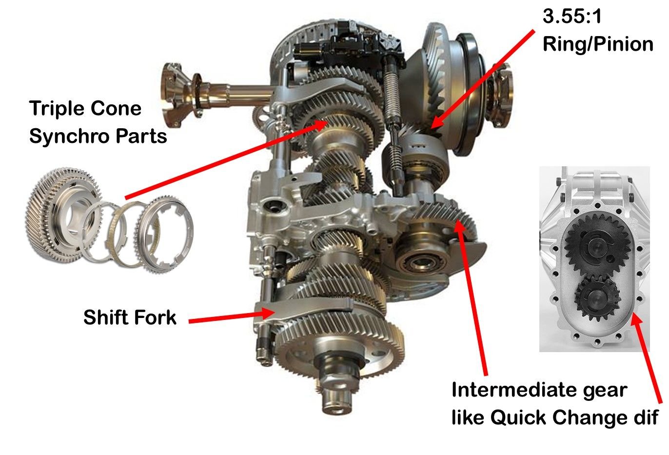

In addition each of the 8 gears as synchros. Some, if not all, triple cones like most in my C7 M7s, some carbon faced. They take time to wear in. More of a wear issue than gears IMO. So I would wait min 1500 miles BUT THAT IS ME!

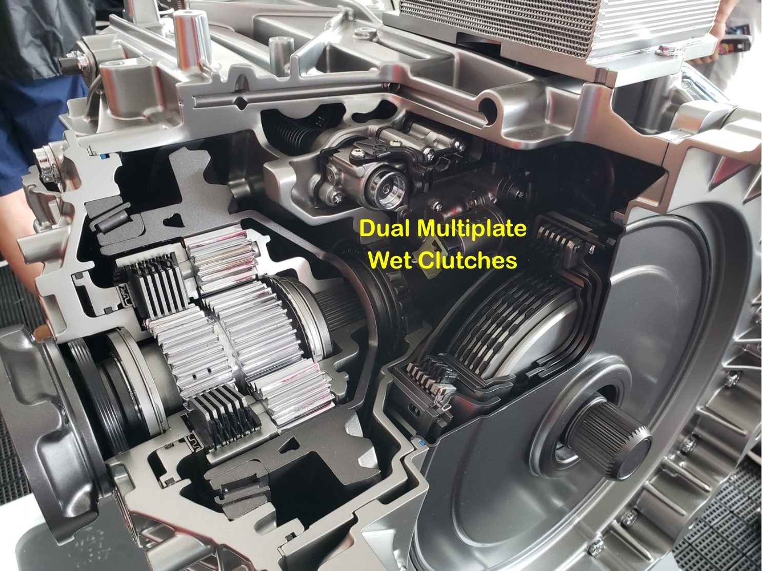

The 1st gear clutch (larger external shown below, also the clutch for 3rd, 5th, and 7th) slips when going less than 4 mph. Has to or the engine would stall! It also slips when stopped for a Red light etc. It does NOT disengage.
I crawl into my garage (as I did with my 2 prior C7 Vettes that were standard shift) to keep my driver's side mirror tip within 1 to 2 inches of the wood door molding. It's easy to judge and know if less than 3 inches have plenty of room on the right passenger door mirror that is harder to judge. Occasionally have to stop and creep forward. For the first ~800 miles felt a bit jerky. No doubt those 1st gear multiplate clutch disks we are wearing in. Wanted to get rid of what may have accumulated. Also, most gears have triple cone synchro's that will have higher initial wear. Perhaps why GM is now suggesting change the filter and have a flush together at the 1st oil change!
DCT is really two 4 speed standard transmission with shift folks and 8 sets of synchro cones. Most, if not all, are triple cones, one carbon faced as were those on my C7s. Initial wear on those, shift forks and gears usually is higher in that 1st 500 to 1500 miles. GM says change the filter at 7500 miles so do that year 3!
