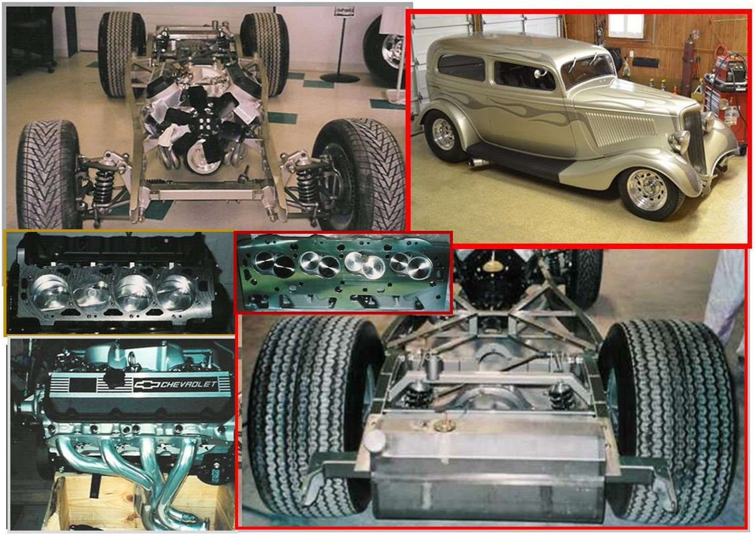

An example is my Street Rod with 16.5 section width (420 metric) Mickey Thompsons, 53% of its ~3000lb on the rear, 4 bar link rear suspension set with instant center in front of the car for max weight transfer and heavy battery in the far-right rear with adjustable coilovers set for even right left load.
Below ~70 F don't even try for max "g" off the line!
8.2 Liter BB set back in tubbed chassis provides 53% weight on rear. Need ~70+ F temps before trying max acceleration off the line!
