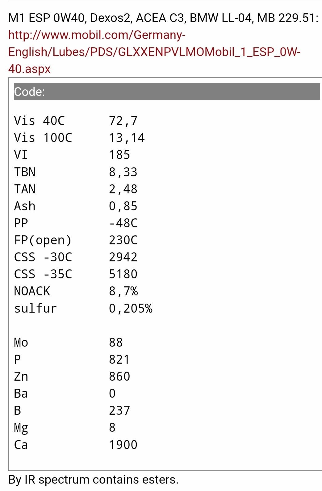

Does one or more of these numbers capture the higher temperature protection of the ESP X3? These are from the product data sheets on the Mobil site. I realize there is more to an oil specification than just these parameters.

No and both oils are very close in chemistry based of the data released by Mobil. Definitely not “much better”, but maybe a little better.
I have had some dialog with Mobil via email. I will inquire more about the two options. Mobil has not re-added the C8’s to the application guide since the change. What is most important is the noack volatility and phosphorous content.
The high temperature viscosity is the number to look at for high temp protection.
3.8 is significantly higher than the 3.53 which just barely skates by the minimum required 3.5.
as far as virgin oil analysis, these were done at different labs so take them with a grain of salt. I use three labs and their values are regularly off by around 10 to 15 percent. Nothing jumps out from them ...
Thanks! That's what I was wondering. I can see the difference, which was a little over 7.6% higher, but don't have a feel for whether or not the difference is significant.

Those oil analysis’s are very close. Viscosity is a very straight forward measurement. Based on the tests the old esp was very close to the x3. There are manufacturing tolerances, it is possible that they could overlap when in the min and max condition. Based on the information so far, the difference is small and the overall benefit might not be measurable. I’m not trying to be a naysayer, but just practical or realistic. There is always a possibility that there are economic reasons behind the different versions. Would not be surprised if GM profits from the dexos labeling or Supercar product.
I wouldn't call it a massive difference but definitely significant. To put it into perspective generally oils from 0w20 up to 15w50 have from around 2.5 to 5.5 high temp high shear viscosities
