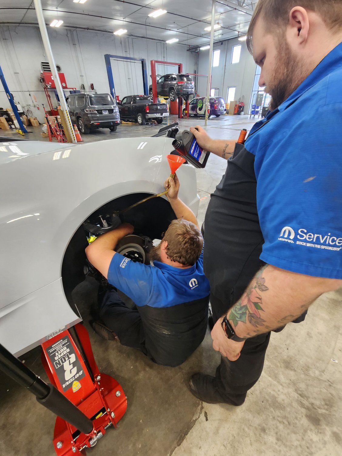

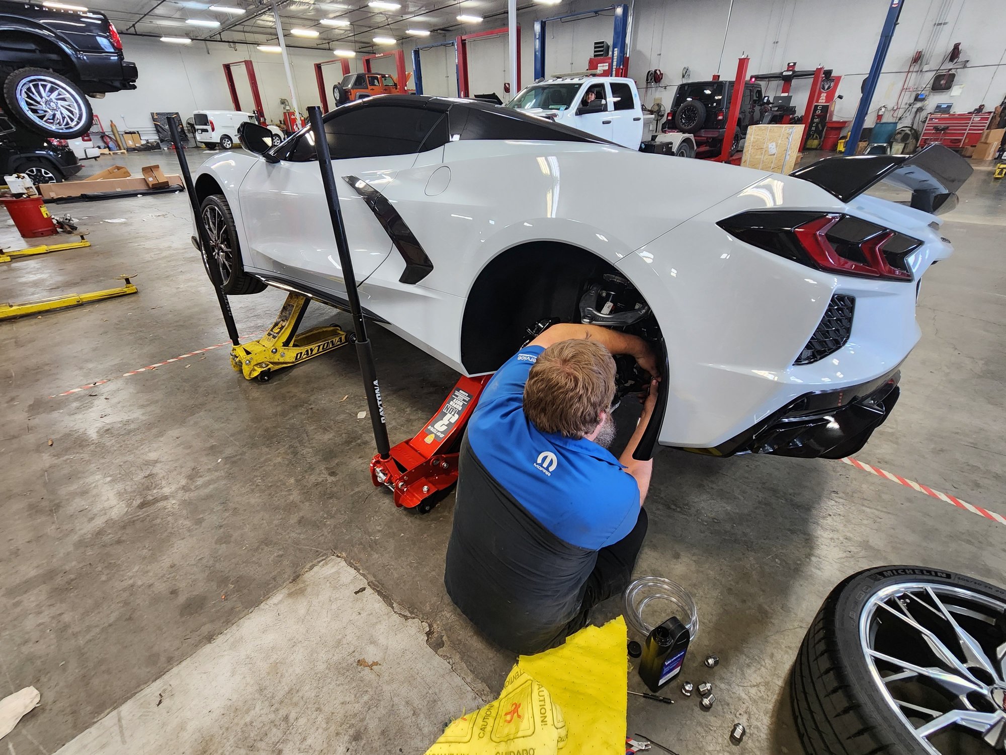

The one valid point they make in that fill video, is how to jack up the car. My standard has always been two supports, a floor jack is not enough. In the pictures above I see that they are using two floor jacks.
I would have two jack stands under there also. You cannot be too careful.
Yep all that's stopping a floor jack is a valve, which can leak. I always use jack stands for redundant support. But the method these guys are using to add two quarts sure looks pretty simple.
