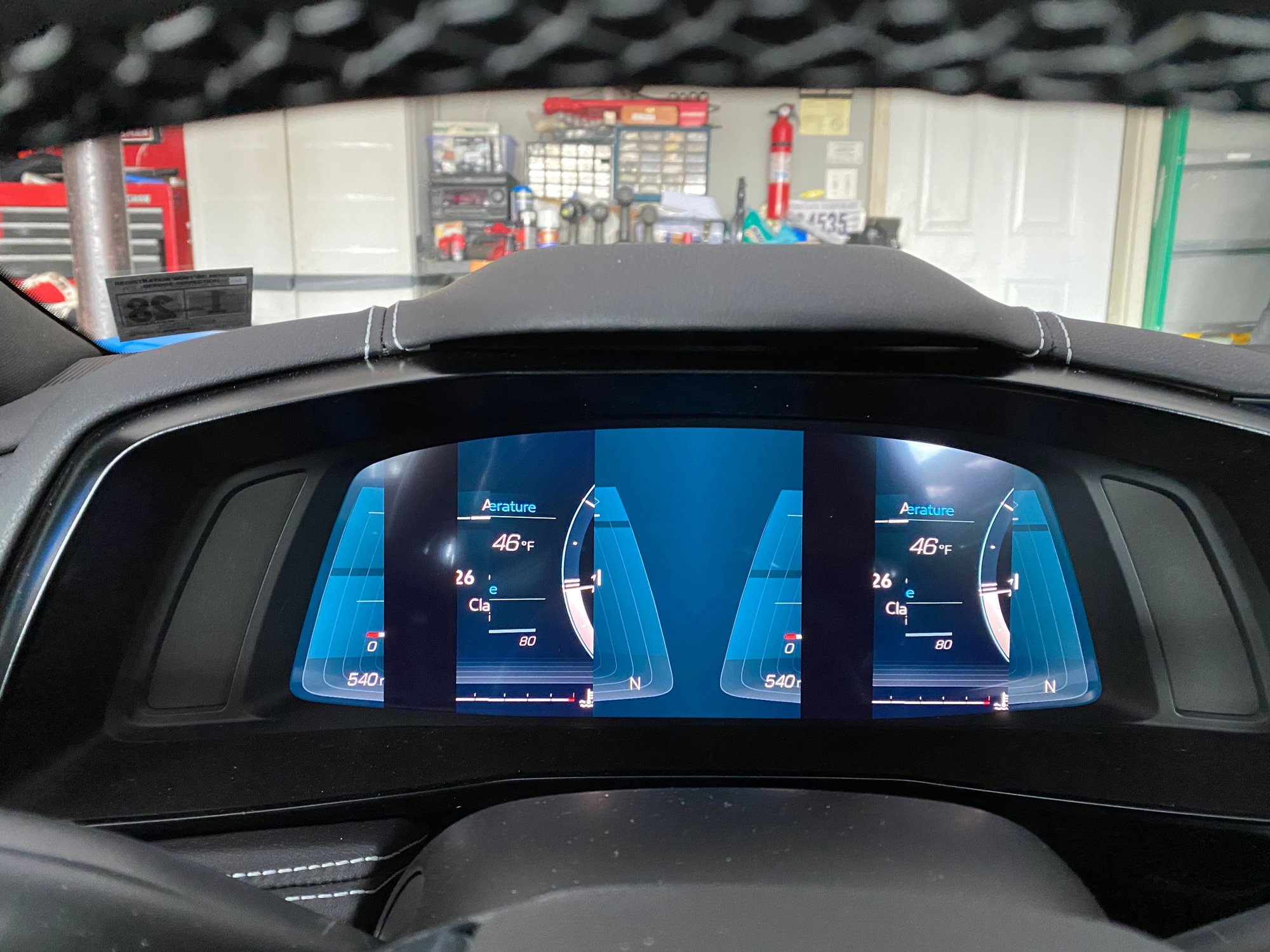

I've had it happen three times in 7k miles. Start up...blank screens. Shut down and startup..same issue. Drive for wherever im going...come out and display is back.

I just picked up my 23 C8. It has 52 miles on it now. My dash is doing the same thing. I shot a video and it is identical to the one that kjlive posted. Has any actually had this problem addressed yet? I was just wondering what to expect from my local dealer. Like what excuses or weird stares you've been given?LOL

Originally Posted by KJLive
That's what is so was unusual. After the car is running, it is fine? See the video.

With the winter/cold weather in the northeast, I haven't taken it to the dealer yet. I was hoping someone would reply to my original post that experienced the same issue and had it resolved.

I have an appointment for Wednesday morning (15th) for dealer to look at my dash. I did show them the video that I shot of what the dash was doing. I also showed the video of kjlive's dash. They told me that they have not seen the issue before. I think it helped that I had video and was also able to show that my car wasn't the only one doing this. Hopefully they can fix it easily......and without taking the dash apart!!!

I am glad my video was beneficial and proved that there are others out there dealing with the same issue. I am anxious to see the resolution. Keep me posted.

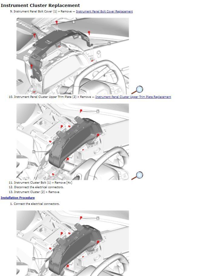

I wonder how invasive it is replacing the dash display? Is it difficult to replace?
there is not difficult
thats how to replace, but need programming and configuration after that.

Thanks for posting that Madcat. That looks easier than a C7 cluster. I replaced a lot of clusters, but mostly on Chevy/GMC trucks. The stepper motors in the early to mid 2000's were awful. I am taking my car to the dealer in a couple of days to see what the deal is. It only messes up when it's cold, so hopefully it is just a software glitch. It's under warranty, hopefully an easy fix....
