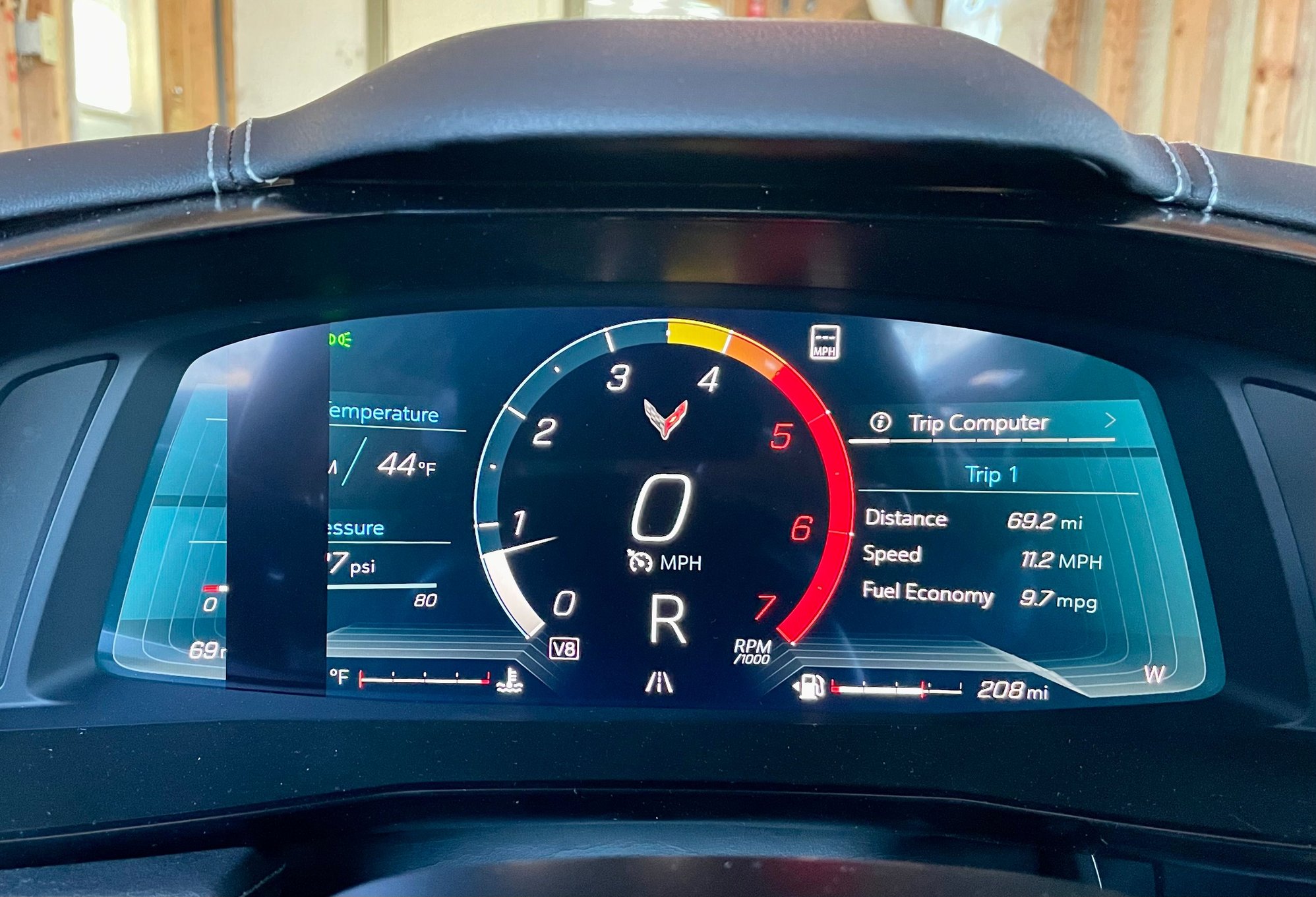

I got the car out yesterday for the first time in about 2 weeks. I have been using a tender for a few weeks. When I started the car, the corvette picture came on the screen with a portion missing on the left of the screen. Then, the gauges appeared with the same missing section. (See photo). It flickered, lines through the display, all black for a second and then was fine the remainder of the day?
Old Jan 17, 2023 | 04:45 PM
C5C6C7C8's Avatar
C5C6C7C8
Joined: May 2021
Posts: 519
Likes: 342
From: Central MA near 495 and The Pike
Default Good job on the picture.
That looks like a bad “driver” or connection, either in the controller electronics box or the display panel itself. Clearly an item that the dealer should address.

Just thinking, if that the case wouldn't it do it all the time as opposed to just for seconds at cold startup?
Old Jan 18, 2023 | 07:05 PM
KJLive's Avatar
KJLive
Joined: Apr 2005
Posts: 122
Likes: 48
From: Lebanon PA
That's what is so was unusual. After the car is running, it is fine? See the video.
