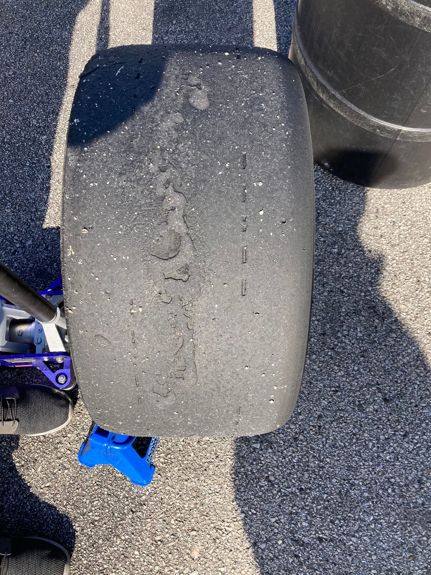

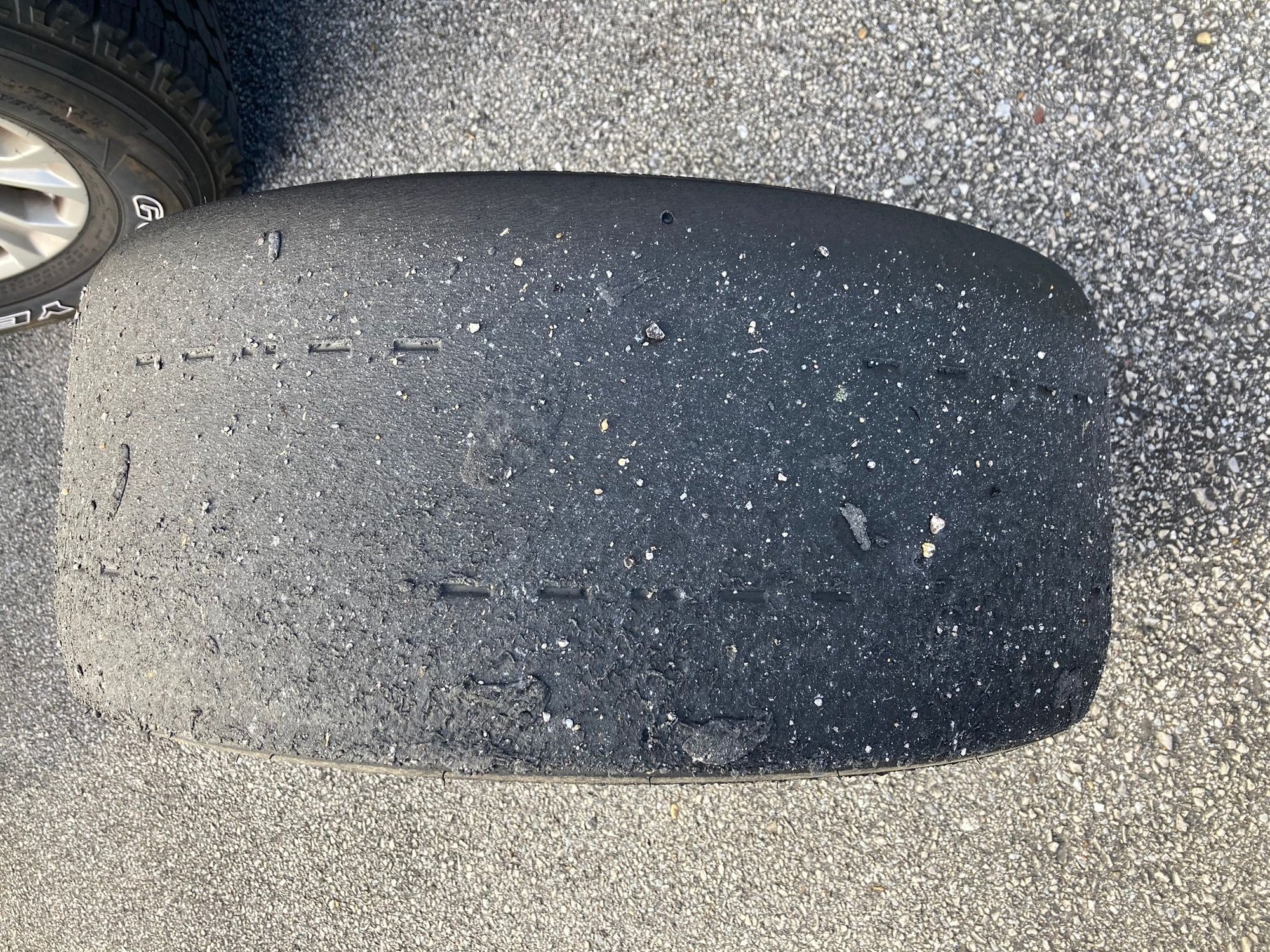

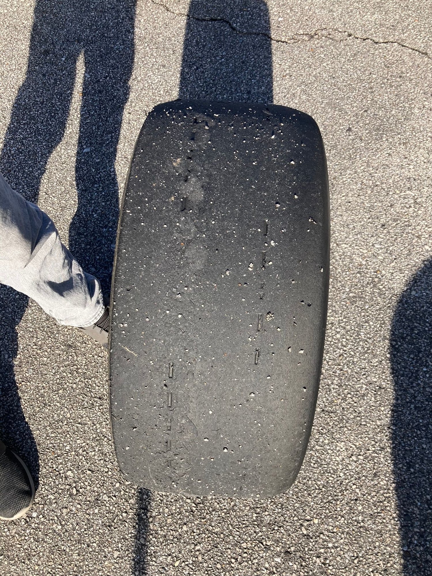

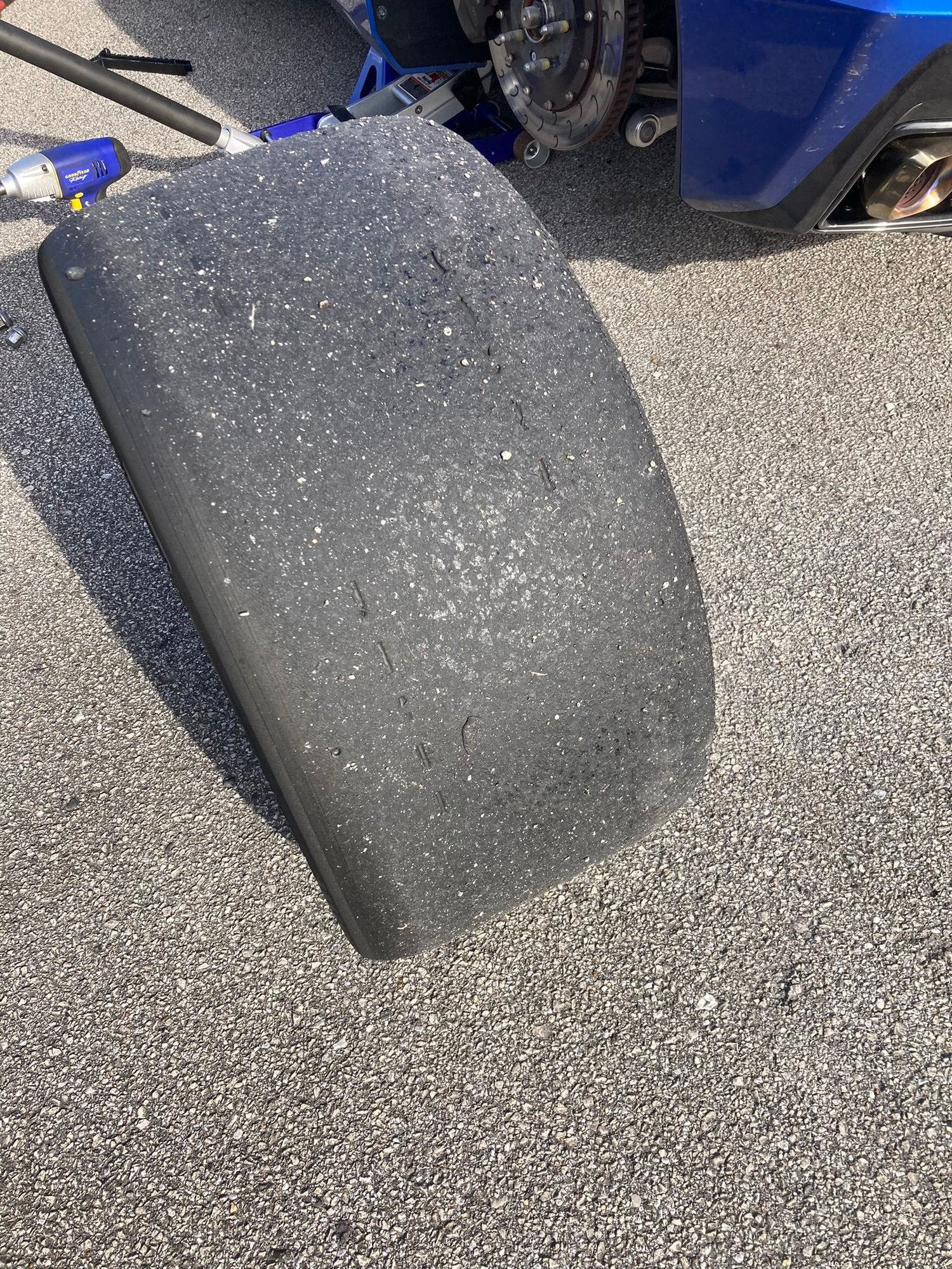

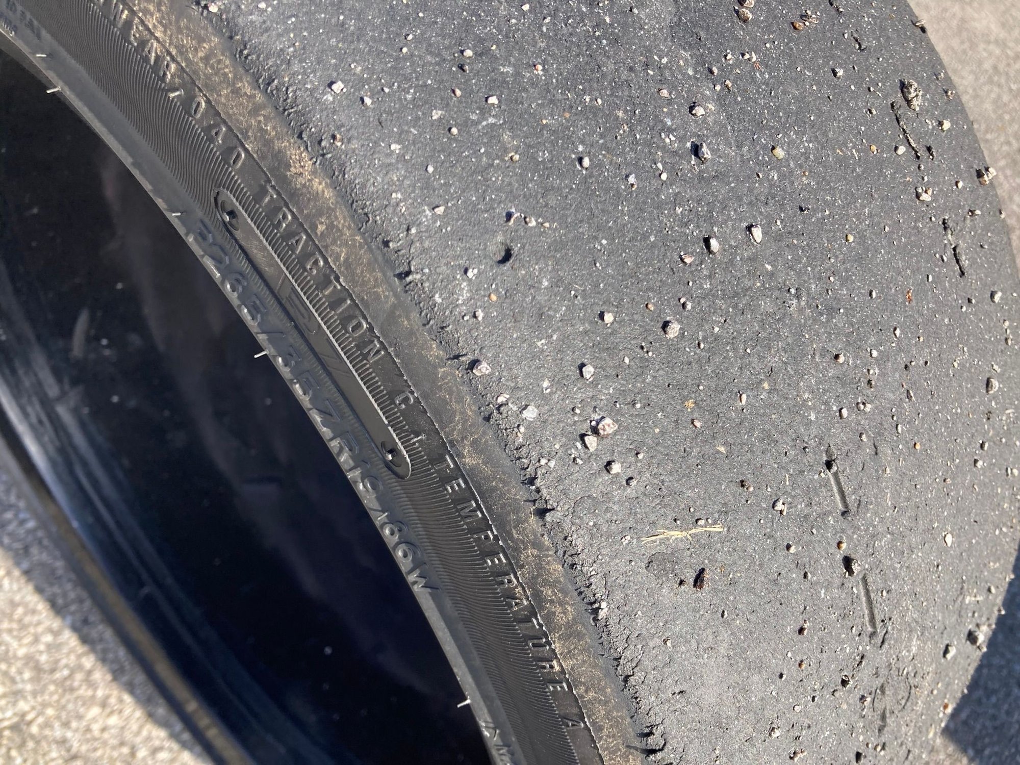

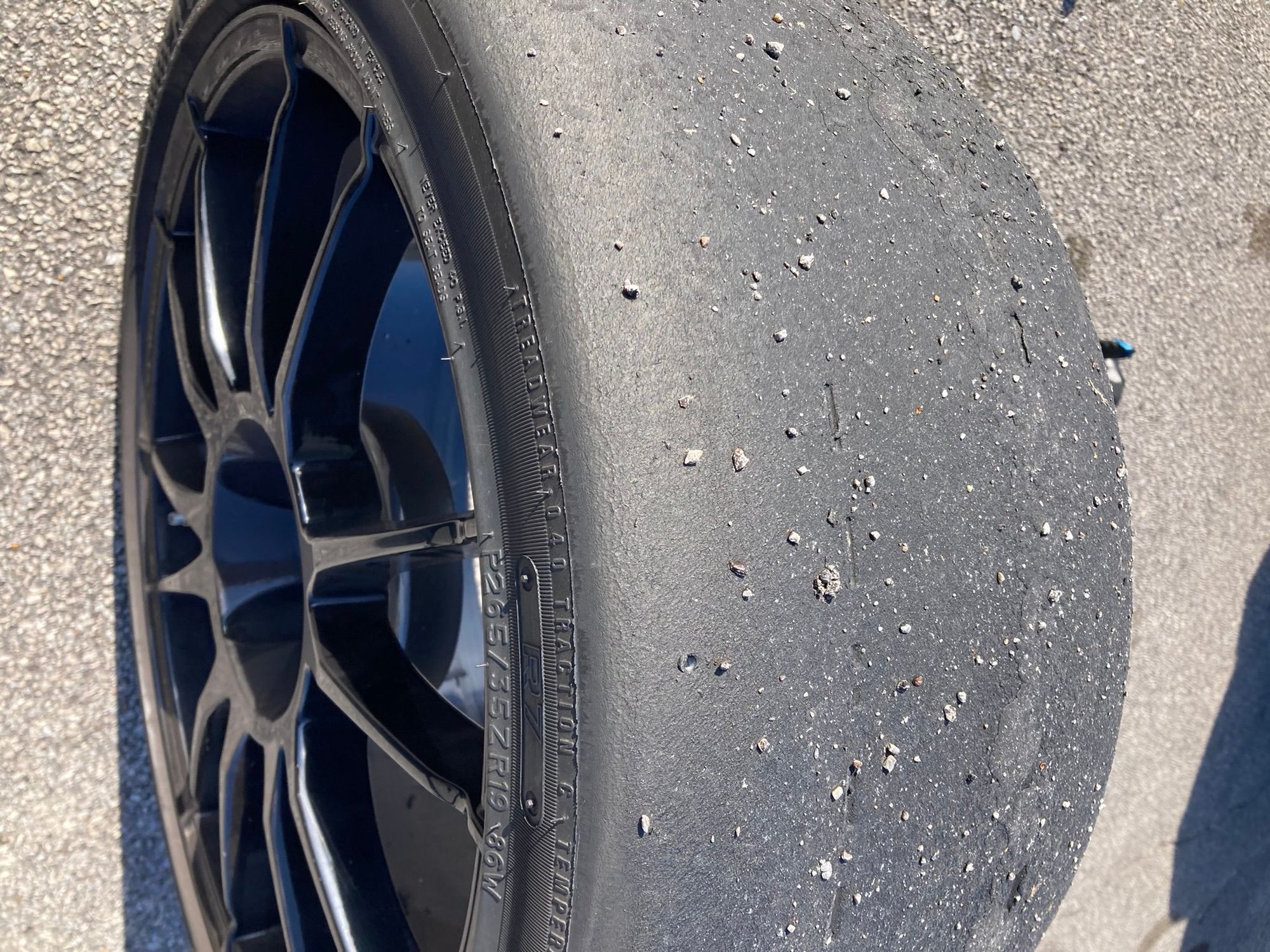

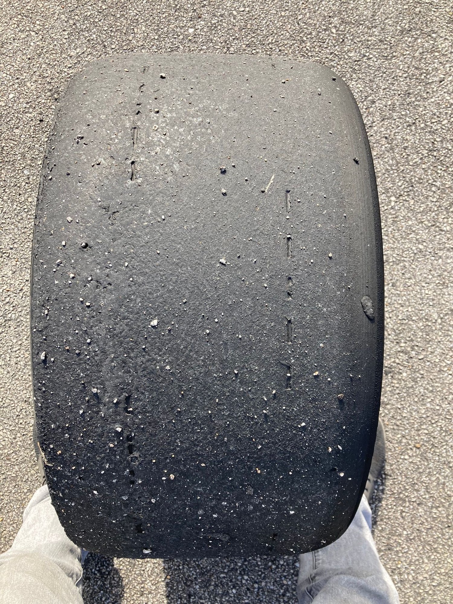

these are Hoosier R7s with -3.0 front-2.5 rear , GM’s recommendation, ran at 34-35 psi hot . You can see the outside edges are slightly more worn than rest of the tire. Same was true with Kanang tires. I have now added .5 degree

Interestingly, my Nankang AR1's want just a tad less negative camber in the back versus the GM recommended specs. The fronts seem to be pretty spot on. I run the stock Michelins on the street.
