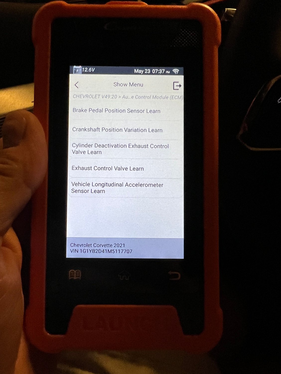

Old May 25, 2023 | 06:34 AM
mrsuds's Avatar
mrsuds
Joined: Feb 2021
Posts: 60
Likes: 16
just order this scanner from Amazon. I had the same issue after Corsa exhaust install. This has the relearn feature you need. Good luck scanner is the Creader Elite with GM software.
