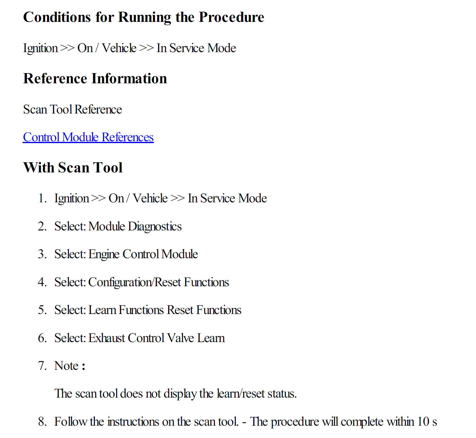

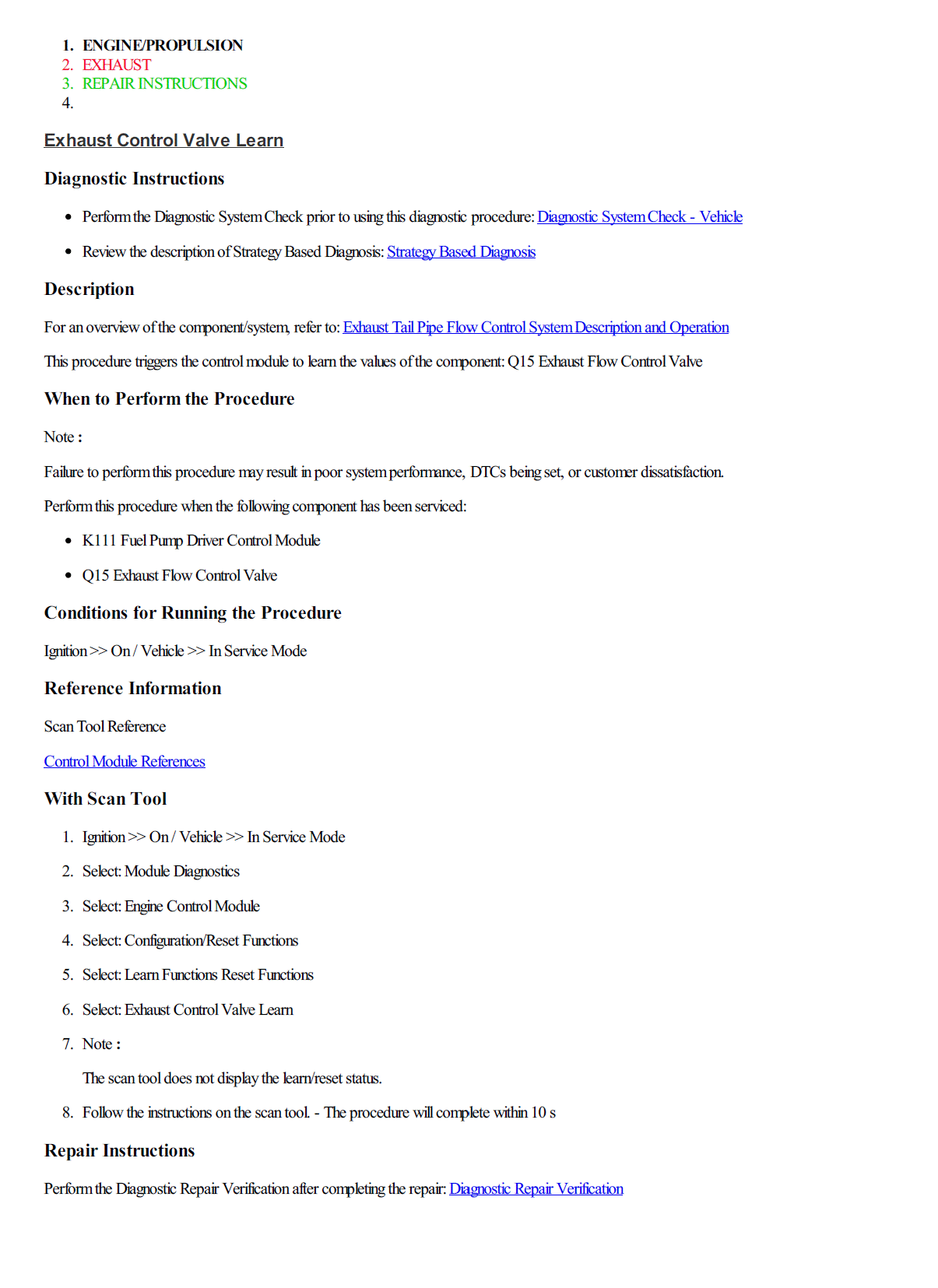

I have these two procedures from 2020 version of the Service Manual that I have.

How do we engage Service Mode? Is that done via the OBD port? The scanner tool?
Just doing some planning before I install my corsa in a couple weeks.
TY!
-Mark

Hold down the engine start button for approximately 10 seconds without pressing either of the pedals.

It would be appreciated if someone could provide step-by-step instructions to relearn the AFM and NPP valves.
So far I have the following from reading through related threads:
1) Plug launch tool into computer or connect to Wi-Fi to update the software
2) Plug launch tool into car’s ECU connector under the dash
3) Hold down the engine start button for approximately 10 seconds, without pressing either of the pedals, to access Service Mode
4) Go to (what screen?) to access Cylinder Deactivation Exhaust Control Valve Learn and Exhaust Control Valve Learn
5) ?
6) ?
Thanks!

I wish I took a quick video when I did do it, but I did have to run through the options more than 2x until eventually I got the right combination of options.
I will say that you need to put the car into service/ignition mode BEFORE you plug in your updated creator elite , and that it was under a menu that took a few tries to find.
5) ?
6) ?
Thanks!
