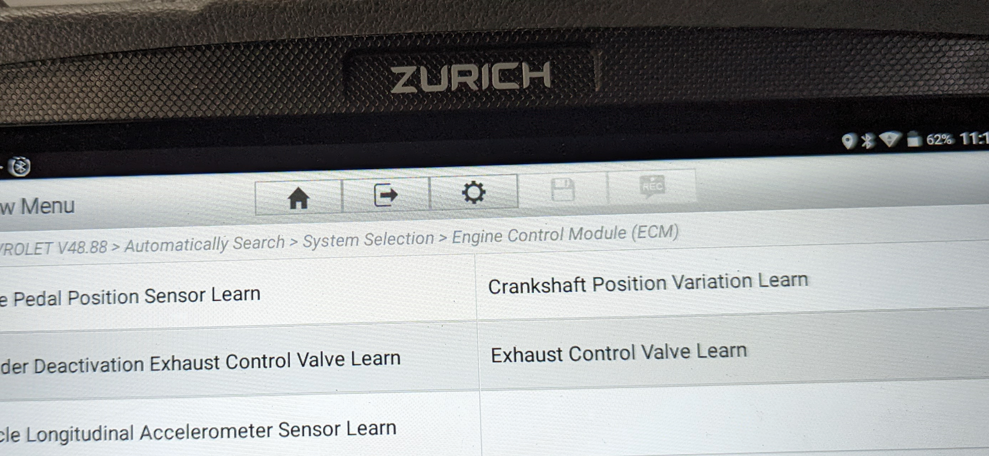

Alot of aftermarket bidirectional scanners can do it. Personally I have a Zurich Pro that I did mine with.

I keep hearing different things on this topic... would you be able to give us a picture of the Zurich pro doing this relearn ?

It's not rocket science. It actually takes less than a minute once you hit relearn. Not sure conflicting on whether the Zurich can do it or not apparently who says it can't doesn't know what they are doing. Like I said I've done it myself with the Zurich Pro.
