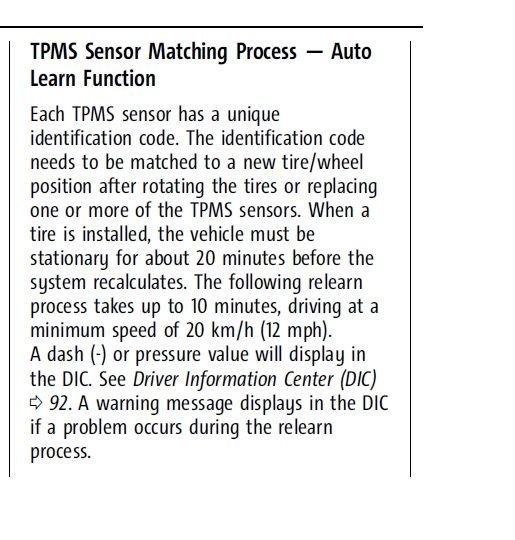

On my C5 I've tried a variety of magnets to train the TPMS with a rather large horseshoe magnet the only one that worked well. I assume the C8 is the same that you use a magnet to train when you swap wheels and tires out or change a sensor with a dead battery?
What is the best magnet to use?
How do you initiate the training?
Thanks
JT

From page 270, 2022 owner's manual (it's in the glovebox)

Thanks, that looks much easier.

Unless you're in a real hurry there is no re-learn tool needed for the C8 and no need to do the relearn in the menu system either. When installing new wheels/sensors or rotating the old ones simply drive the car normally for a few miles after installation. It will learn the new sensors - or the new position of the old ones - all by itself. Same goes for having the battery disconnected.
