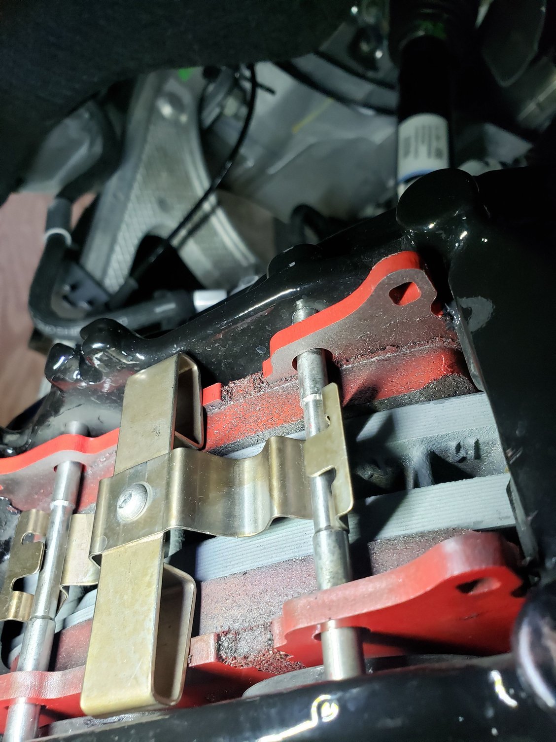

I have a 2023 Z51, after installing the Carbo 1521 Pads, CT28951, I noticed on the rear that the pad material is higher than Brembo;s, a tad above rotor surface, does that seem normal. see attached.

Yep, mine are like that too. I have Girodisc rotors on mine.

Yea it’s kinda annoying. Leads to a squeaking while driving on mine.

Looks like after install on my wifes car, put Girodisc rotors on at the same time, no issues been on 5 months

Update, after 250+ miles, still no dust everything smooth. I have Girodisc rotors also

Carbotech is aware and has been correcting the fitment.

I contacted them when I first installed the pads in question, Robert at Carbo says it's no big deal and won't hurt anything. Of course not acceptable. I sent email today after hearing rumors they were modifying future production to resolve issue, Haven't heard anything back yet.

I received a response back. They said they are not modifying them…the sound the overhanging pads make once worn a bit is pretty annoying.

Yeah, I'm pretty annoyed at that as well. They were squeal-free for a few thousand miles until they started wearing down some - I didn't know what the issue was until I discovered this thread and it was driving me nuts trying to identify what was going on.

I have 5000 miles on my 1521's now with no problems and no noise. When should I expect the problems to start? (I also have Girodisc rotors). I noticed the overhang when I installed the pads and rotors. It didn't seem like a big deal to me.
