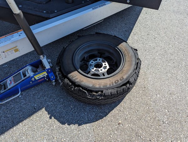

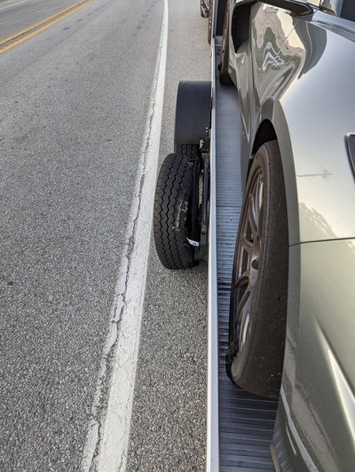

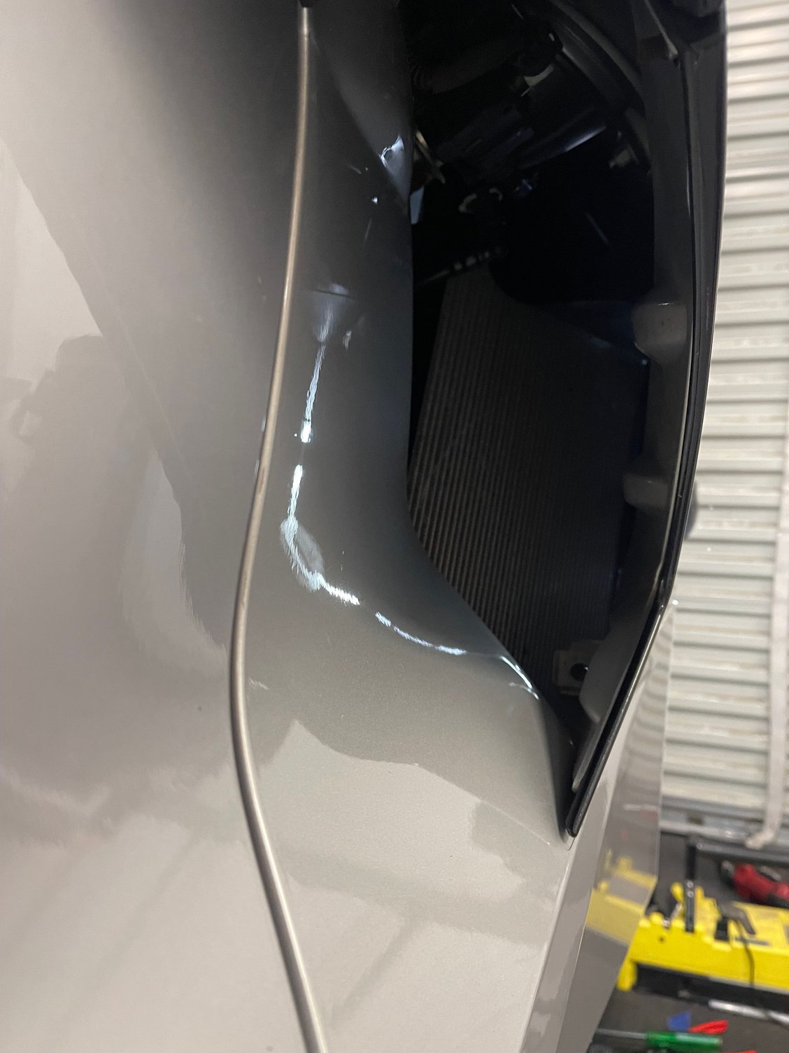

First of all, this happened 30 mins to the hotel. I pulled over to a narrow shoulder by US97, and thankfully had all the tools necessary to do the job since I had tools for the track. It was not too safe, but the traffic was also very light. The blown up tire also blew my removable fender off.
Someone pulled over 5 mins later. I was going to thank them and say I don't need help, but it turns out a driver driving a lifted HD truck hit my fender, and (lightly damaged her truck). She was very upset and shouting at me right as I was trying to change the tire. I told her it's just money, and we'll figure it out, no worries, and she took it as I am trying to negotiate. In the end, I had to say "Please calm down". She replied "I am calm!"; and then she calmed down : P

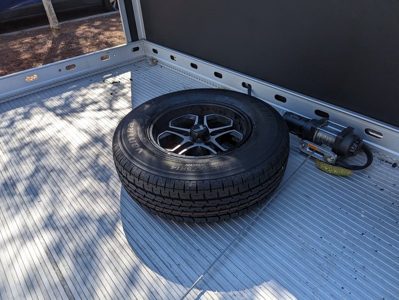

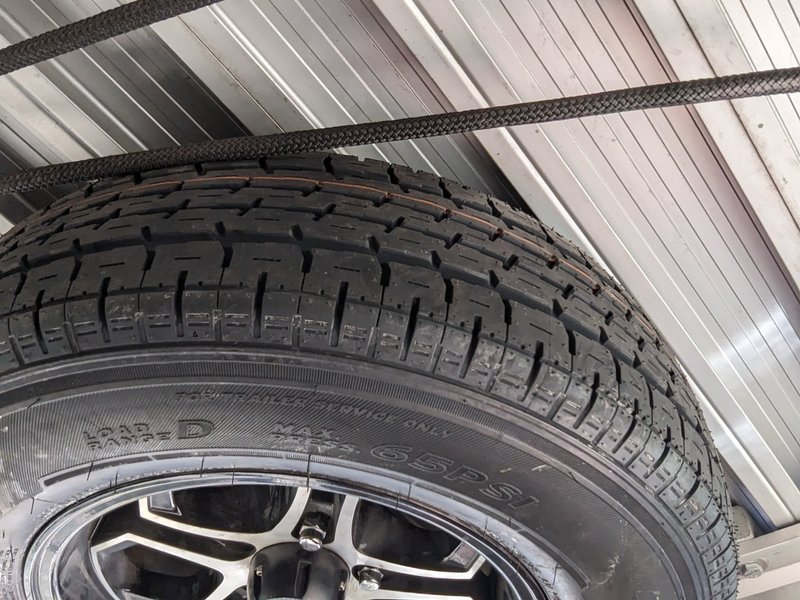

Anyway, this was very stressful! I thought these were high end tires (that come with Futura trailers), but it turns out it's just cheap Chinese tires. I always change tires on my trailers with better quality ones to avoid this, but this time I trusted the manufacturer, and had a completely blown up tire for the first time in my life! I will get all 5 tires (including spare) replaced with Hankook Vantra tires...
This is how the tire disintegrated. FYI, all tires were at 60 PSI when I left home (65 PSI max on these), and I was well below their speed limit (75 MPH), driving in 60-65 MPH range..
The upset driver brought my fender back, too; not sure if it's usable, though. I filed a request with Futura on a replacement part.

The blown tire has also blown away the removable fender, which became a road debris. She then drove on it, and damaged her truck (minor) a few minutes after I passed through there..

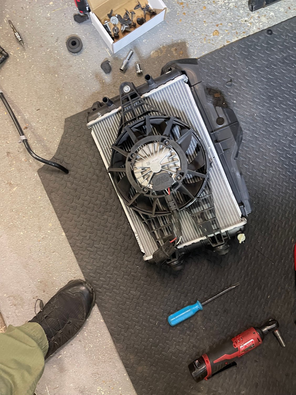

V09 install yesterday. Everything is straightforward except disconnecting the stock coolant hose, pack your patience on that one. I don't know how the OP posted those pictures but there is not that much room to work with.LOL
same parts list? Did you insert a thermostat?

Actually my stock fake radiator had the baffle so I didn’t need that. Only needed clamps, hose and the radiator. I already installed the center z06 radiator a while ago. I actually had to put a cover on the v09 radiator because my engine oil temp would hover around 150-160 normal driving in 90 degree heat

You should still get the V09 shroud ($13 IIRC; I forgot) in my opinion. it comes with a baffle to split air going to the intake and radiator, and blocks the blowback from radiator.
With the thermostat, it'd not impact anything when coolant is below 180 degrees F, which is nice : )

I have a 2020 z51, it has that baffle on the fake radiator. Probably the later model years did not have it. It's simple to check before you order it, just look in the side pod.

I may take that liner off and add the stat.

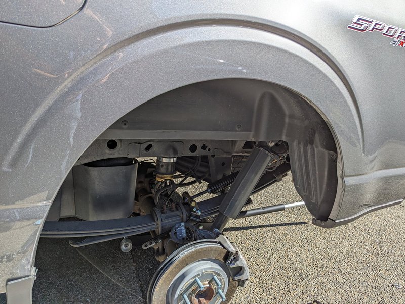

Installed Roadmaster Active Suspension (RAS; 3611-Y) on my truck. With spare tires in the bed and car on the trailer (with about 500 lb of tongue weight), I do have about 2.5-3" of sag max. The truck never felt unsafe or unstable, but I've been getting quite a bit of flashes, so my headlights are definitely not looking at the right place. I've been researching air bags, but unlike what I could easily do inside the rear coil of RAM, there's no airbag option that doesn't mess with ride quality for a truck with leaf springs. They all change the bump stop, and it makes it drive rough whenever it's not loaded. Enter RAS. This solution is supposed to not hinder right quality, reduce axle wrap and improve driving dynamics (tightens suspension, reducing float), and reduce sag. I bought the non-HD version, but installed at higher (40% spring rate help) setting. I was confused on how to install the spacer on bump stop, but the rest was easy : )
I am looking forward to trying it next time I tow my car!
My truck's rear heights:
Tools/tires + trailer with car: ~37.75"
Tools/tires (trailer removed): ~39.3"
Empty: ~40.125"
After RAS installed: ~41.25"
Yes, RAS increases rear height about 1.125" (which will create a head start as well with sag). It's supposed to increase it only 0.5" at 25% help setting. I checked front height only after install, and it's at 37". I test drove the car when empty, and it felt good. There's a section of a road on my commute where this truck feels floaty, and I'm also looking forward to driving over there next week to see how it feels with the tighter rear end.

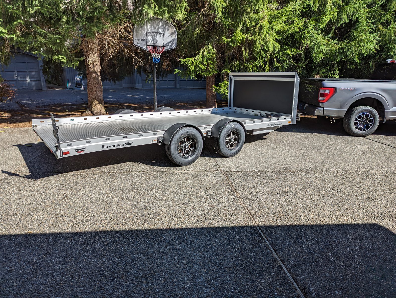

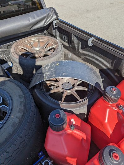

Got all 5 trailer tires (including spare) replaced with Hankook Vantra tires; yay!! These tires are rated up to 87.5 MPH, providing more headroom (over my usual cruise speed of 60-66 MPH), and should not explode like Road King mambo jumbo brand.
Of course, Futura trailers thought about this, and realized they could annoy the owners by moving the spare tire mount sooo close to the pulleys, it would be impossible to mount a tire if it's even a tiny bit taller than the original skinny (185 mm) tires. Thankfully, the mount is adjustable, and I moved it about 25mm to clear the cables under the trailer.

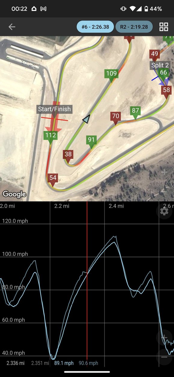

Here's the (GPS) speed graph of C7 Z06 vs. C8 Z51 (bold color) acceleration at Area27. As you can see, the acceleration seems to be pretty similar until about 70-75 MPH, at which point Z06 starts pulling away. That said, the shift costs valuable time, and gives C8 Z51 chance to stick around for another 15-20 MPH, after which Z06 just keeps pulling away. I thought this was a good demonstration of how DCT helps us keep up, especially in lower speeds. I should also point out that C7 Z06's ambient temp was 75 degrees F, while C8 Z51 was running at 88 degrees F ambient. I think this also shows that I should STOP worrying about intake temps : )
EDIT: I found a lap from C7 Z06 at 84 degrees F ambient (vs C8 Z51 at 88 degrees F ambient). The shift deletes the speed advantage, but of course it only catches up in speed, but Z06 always maintains a bit of a delta in speed in everywhere but during the shift.
Suspension settings:
I also went out for a test drive today with my brother visiting. We've immediately felt that the drive was very bumpy, and the car was bouncing around. Now that I know a bit more about how I should've tuned, I realized compression was too high (at 14/14 Compression/Rebound). I dropped the compression only to 12, but it did not help much. Then I dropped it to 8, while reducing rebound a bit to 12, and it felt much better! Considering how bouncy the ride was, I was probably losing gobs of time. Anyway, my new baseline is 8/12, and now that I know that I shouldn't need much more compression than 8, if any, I think I can somewhat focus on rebound settings and see where it can get me.

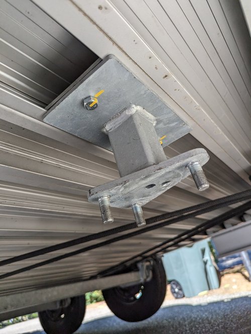

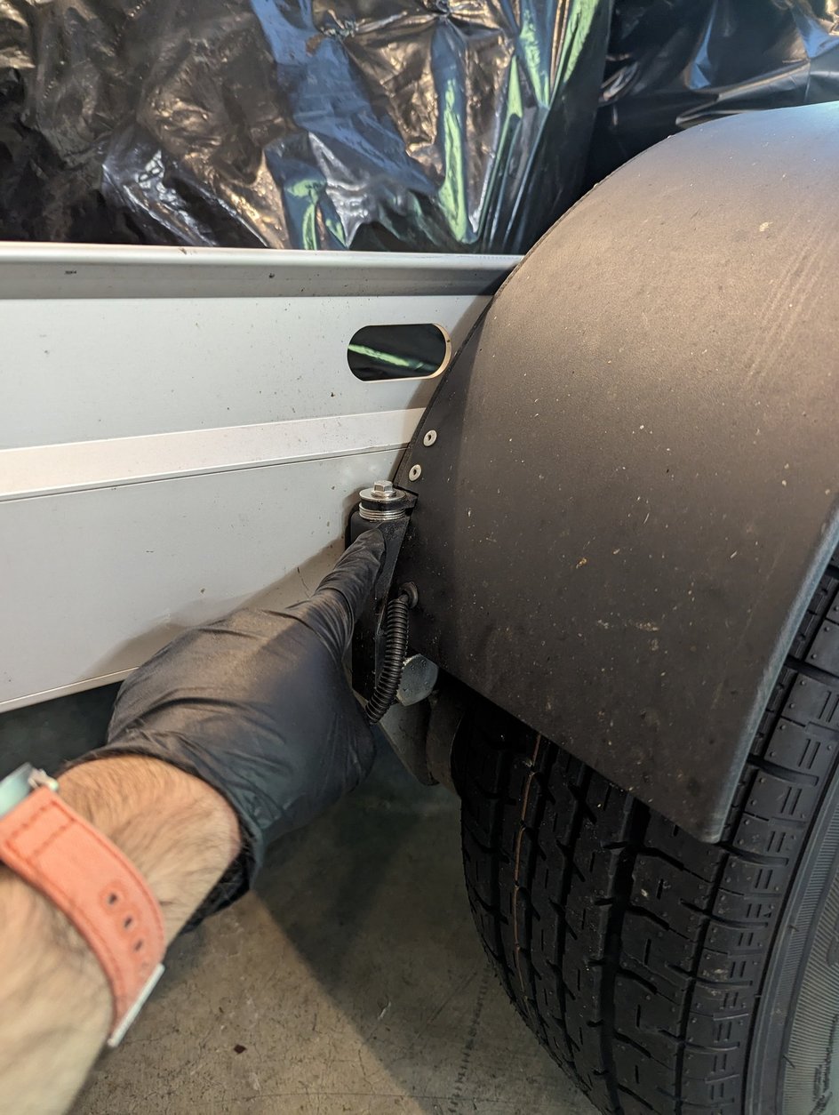

Decided not to risk it, and moved the Futura fenders higher for a bit to avoid any interference. The fear is that the fenders are not tied to suspension, and they would get too close to the tire or hit it when the trailer is loaded, and driven over bumpy roads.
With the M6x40mm bolts, the fenders are not going anywhere anymore. The washers under it add 4 mm of increased clearance.
