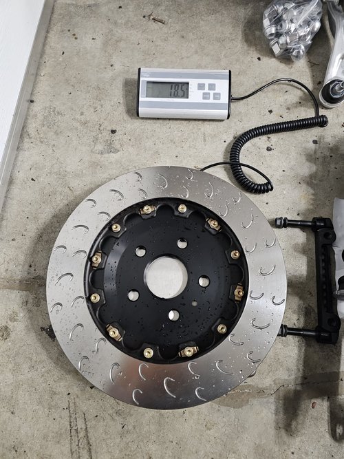

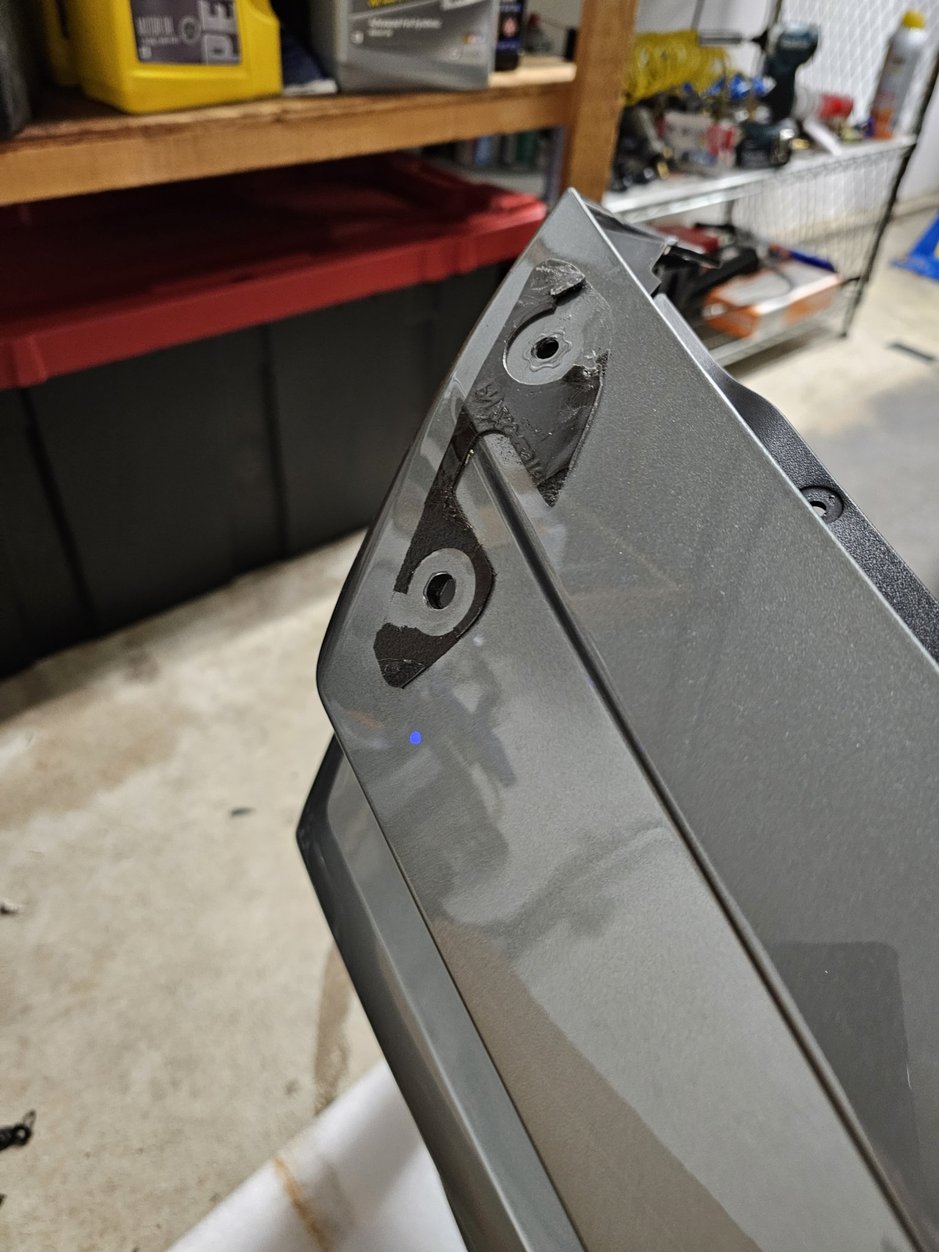

AP Racing Brakes, Li-Ion battery, front radiator grill guards, OEM Z06 Control Arms, MCS Coilovers

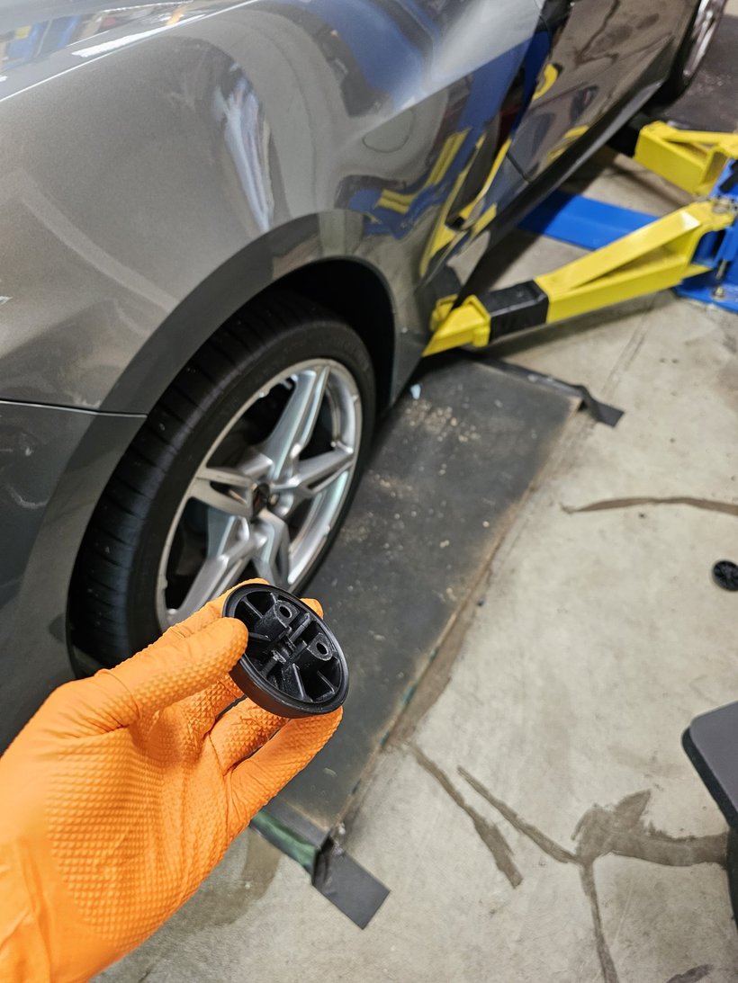

I've immediately run into an issue when I tried to lift the car. The old leave-on-car plastic lift mounts no longer work, since thickness of the side walls of the holes are less, making these plastic pads loose. In fact, I ended up breaking these plastic pads, but had to use them (for one time use only) until I could source my ZL1 Addons metal permanent pads.
Since the lifting points are closer to the ends of the car, it was actually easier the lift the car than C7. On C7s, I'd have to line up the car exactly in one spot, or else the arms would be too long on at least one corner..

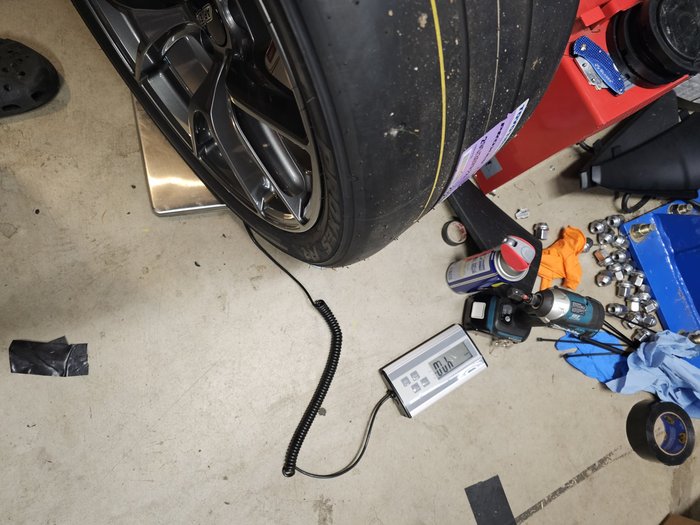

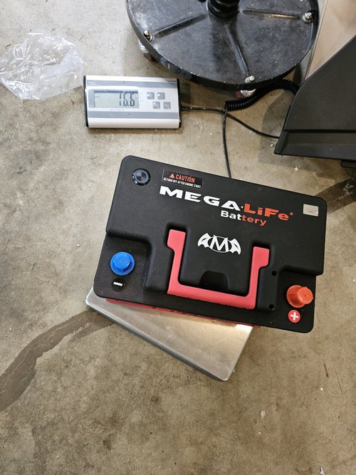

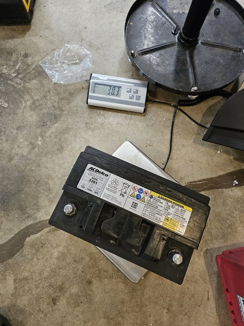

MegaLiFe (40+8) Ah battery (16.6 lb vs. 38.3 lb OEM: -21.7 lb)

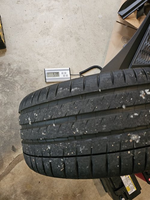

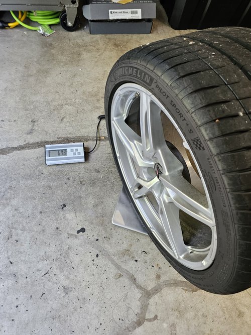

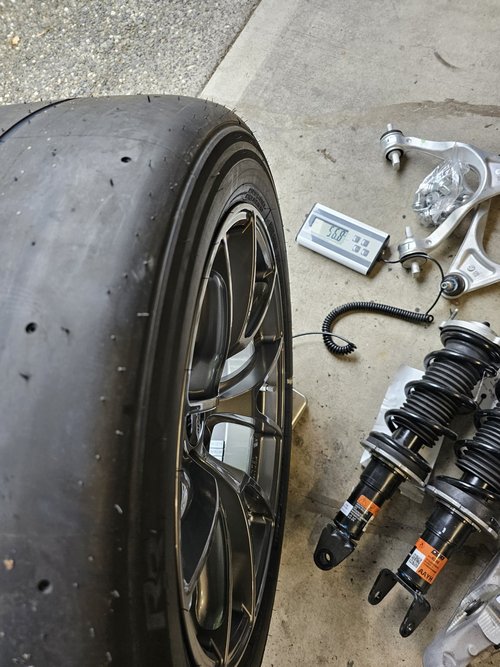

OEM front/rear tires/wheels: 53.9 lb, 67.8 lb --> 243.4 lb all 4.
Toyo RR 295/30/18, 345/35/18 tires on APEX wheels: 47.0, 56.8 lb --> 207.6 lb all 4 (-35.8 lb vs OEM)

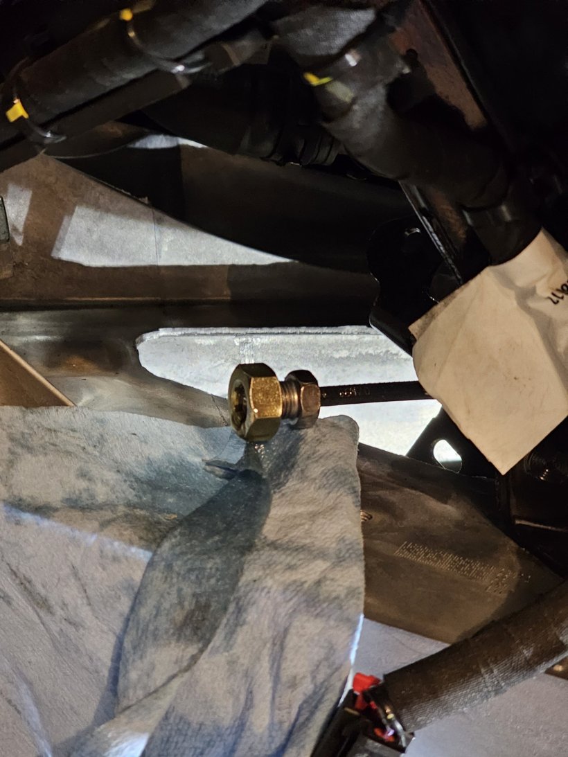

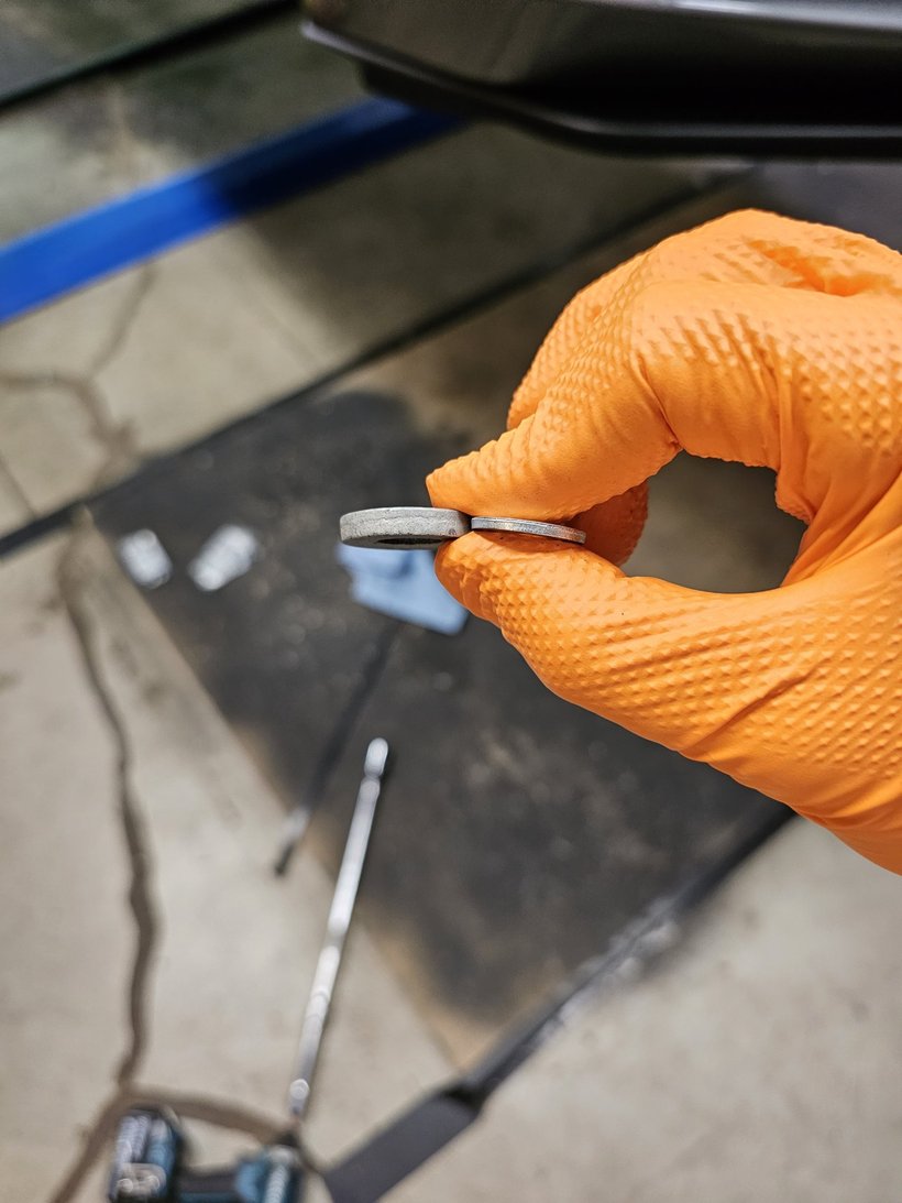

Switched to Regular washers to increase max camber. I like the idea of having a washer in place between the control arm and the frame, but we might end up removing them if we're too limited on camber.

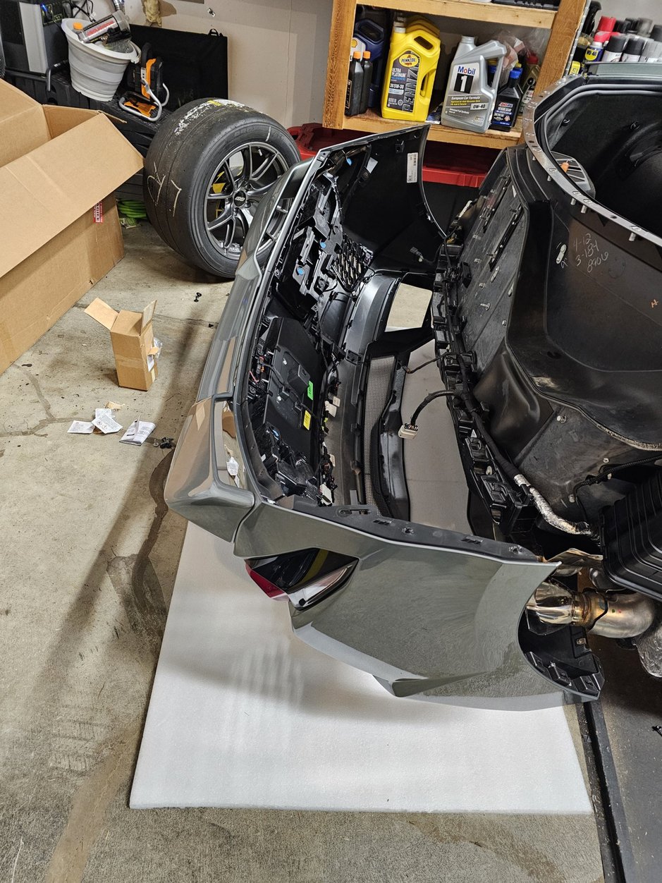

It's amazing how covered the whole bottom of C8 is, compared to prev. gen cars...

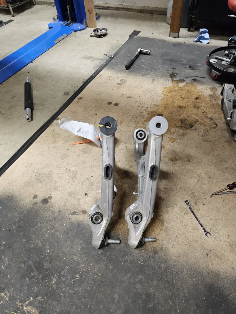

Pics of OEM Z06 control arms before I installed them...
I did not see much of a visual difference on the upper control arms, but the lower control arms definitely come with different bushings.

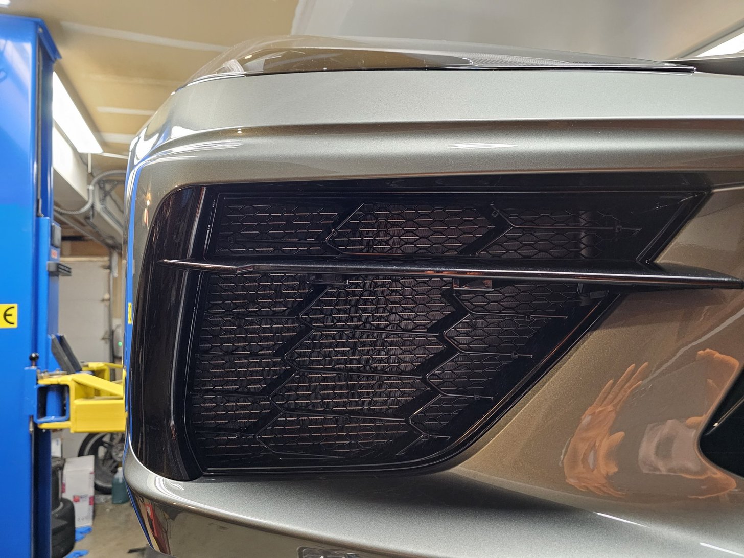

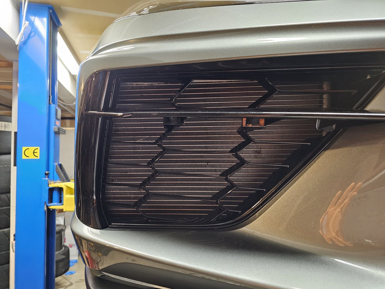

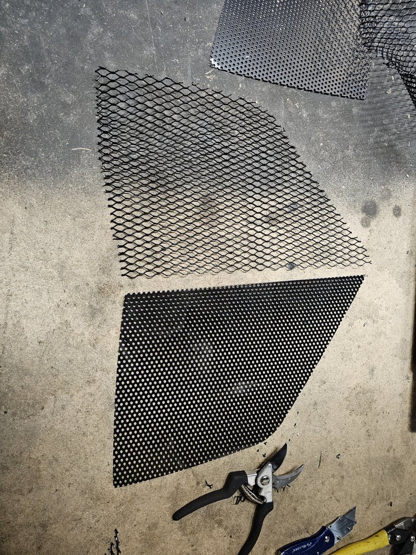

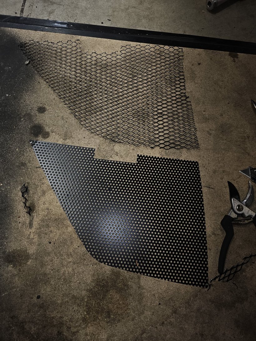

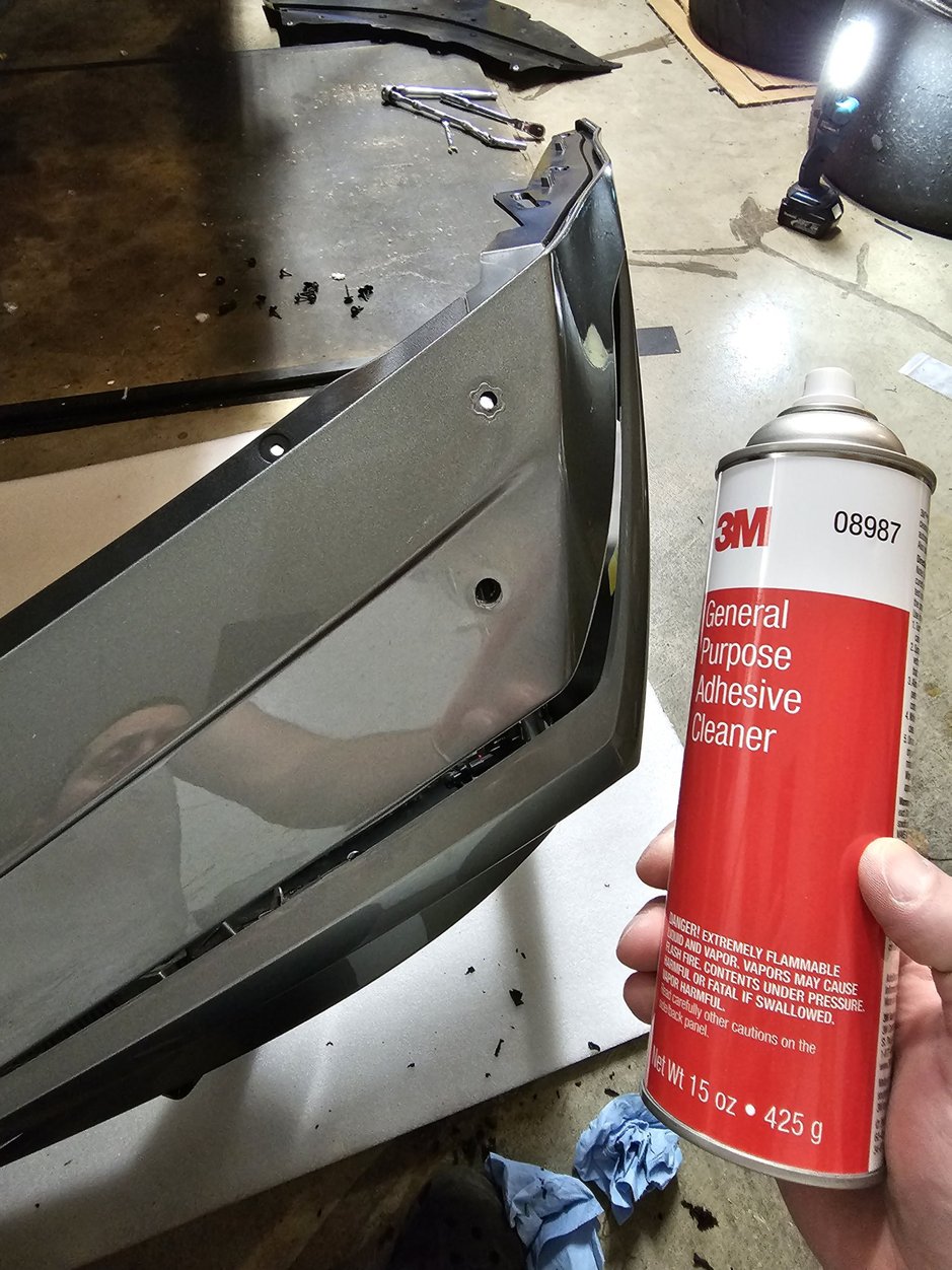

I bought (cheap) radiator grilles on eBay, but I realized they would be way too restrictive. Instead of installing them, I've used them as a template to make my own, using 11x25 mm grill sheet.
Before / After..

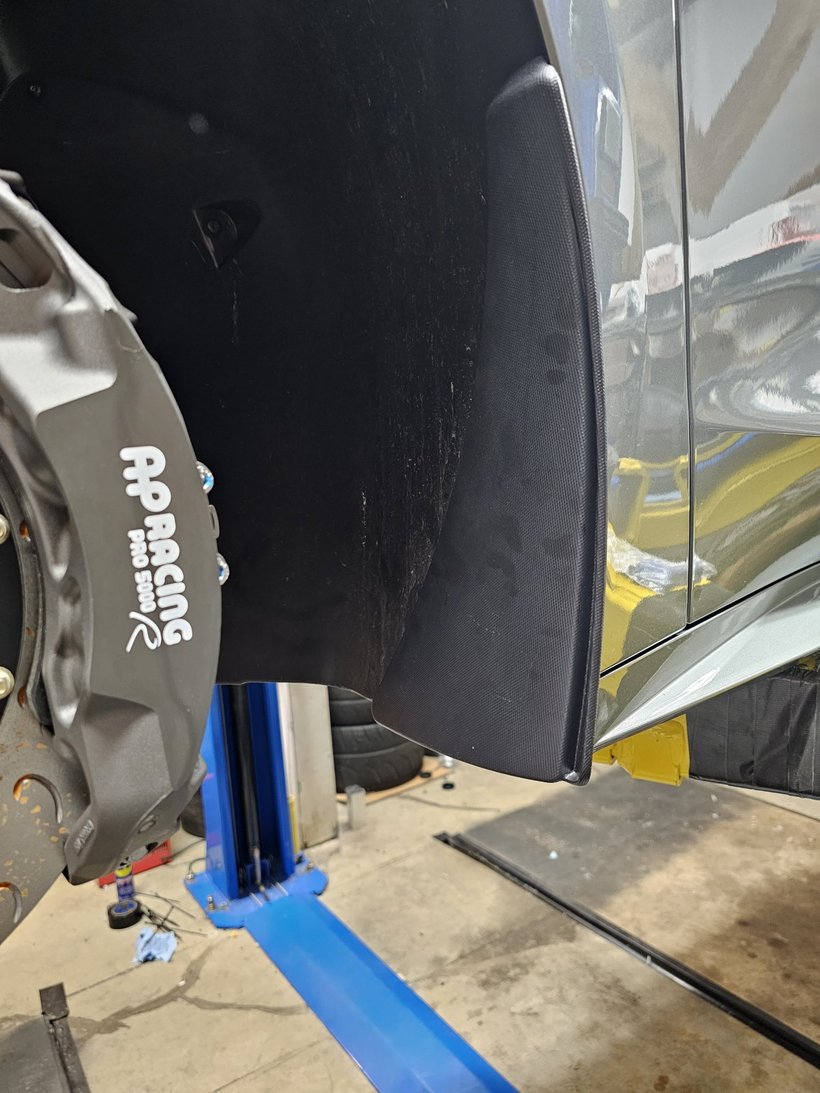

OEM extended mud flaps provide a wee bit more protection without looking out of place.

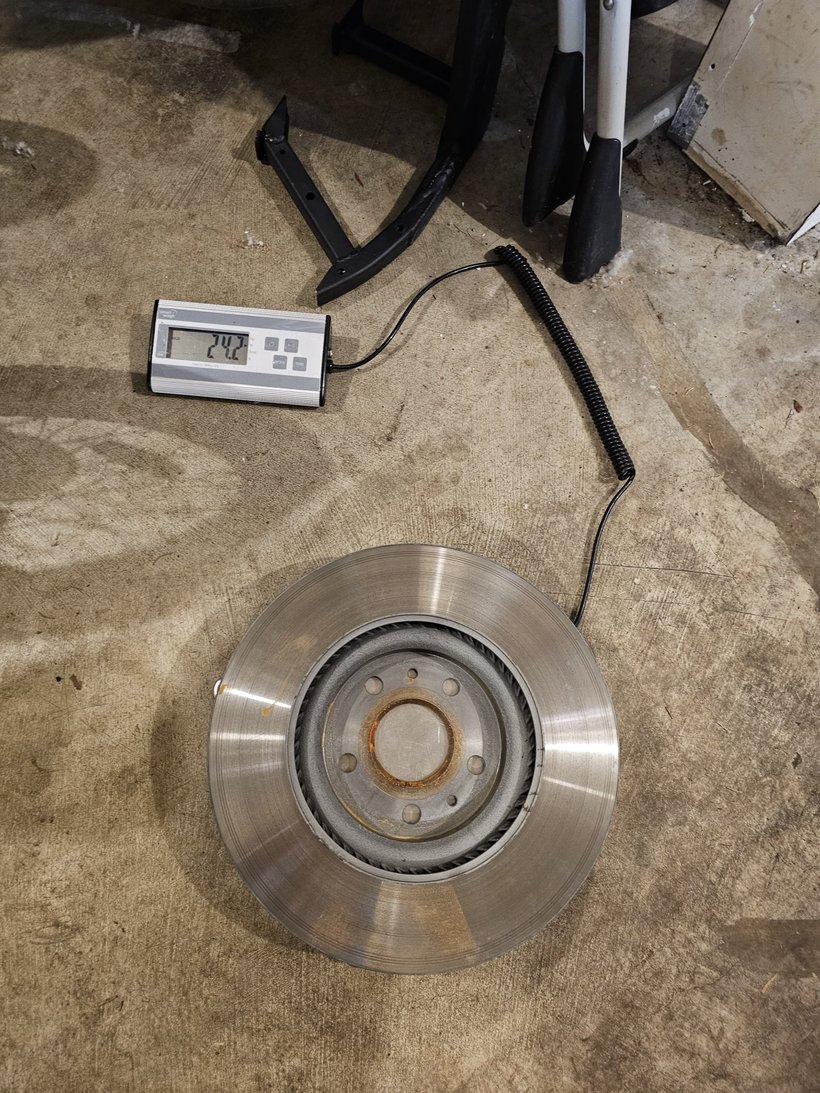

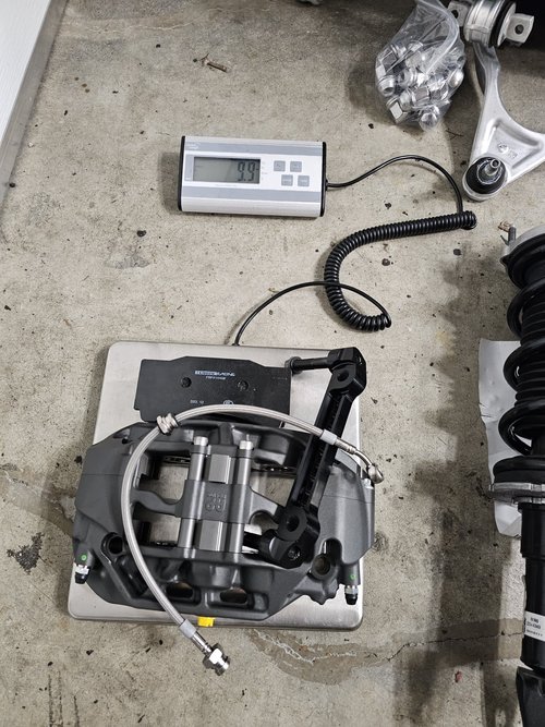

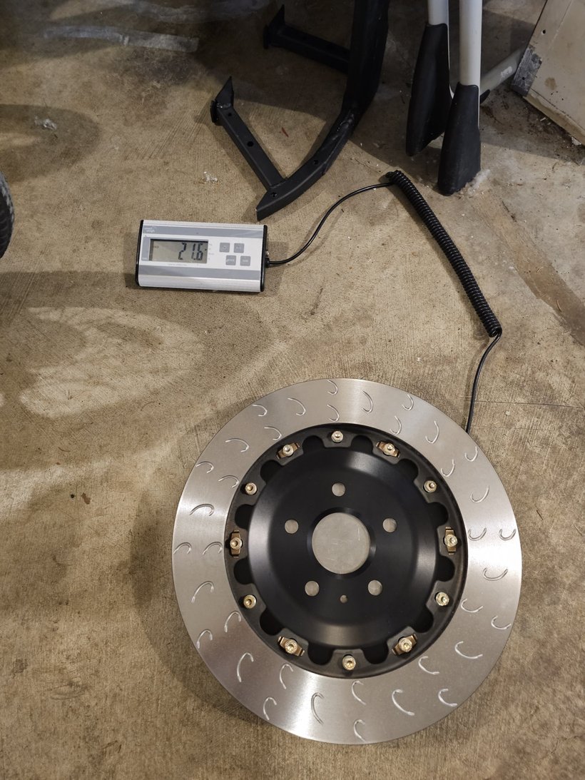

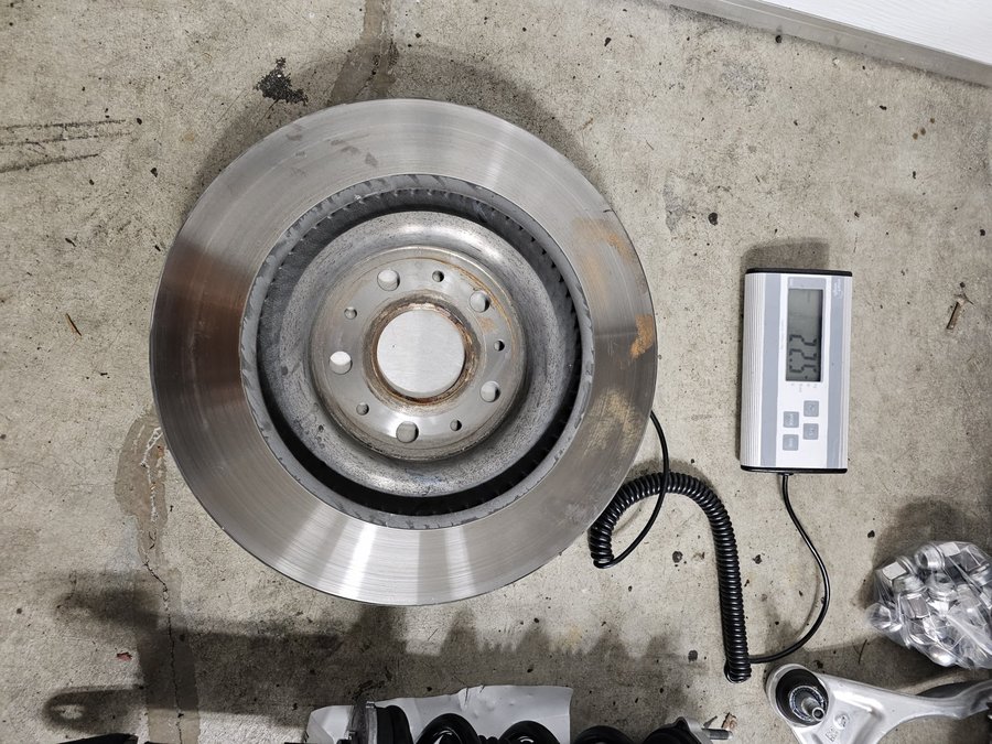

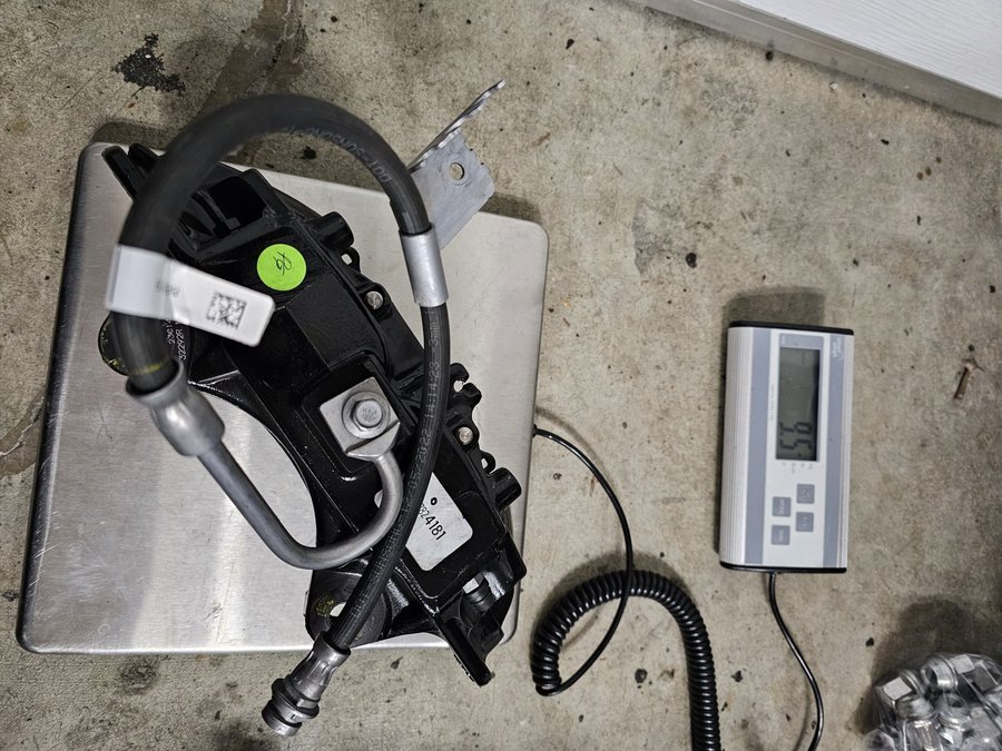

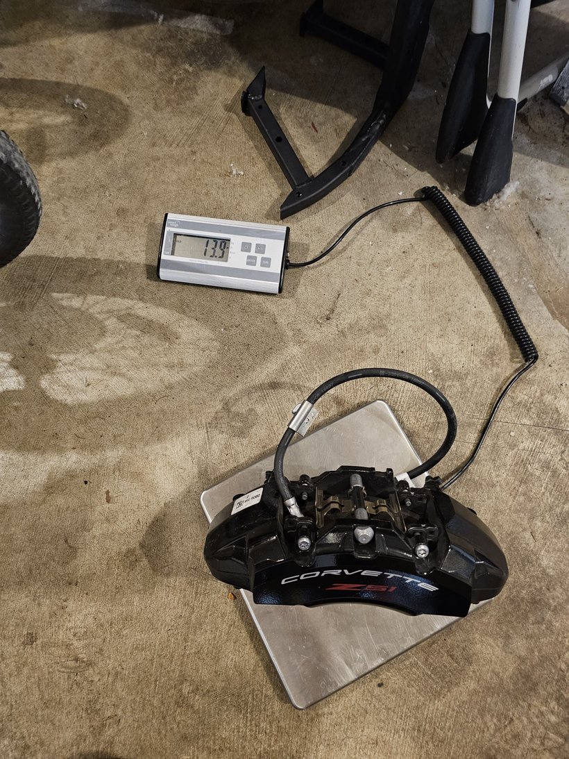

AP 372mm (21.6 lb) vs. OEM (24.2 lb).
AP 9668 (12.8 lb including SS line) vs. OEM (13.9 lb). Total savings up front is 7.4 lb. You might see more savings posted elsewhere; it's often due to brake pad or the bracket, etc. missing in the calculation. The 25mm thick pads are heavier as well..

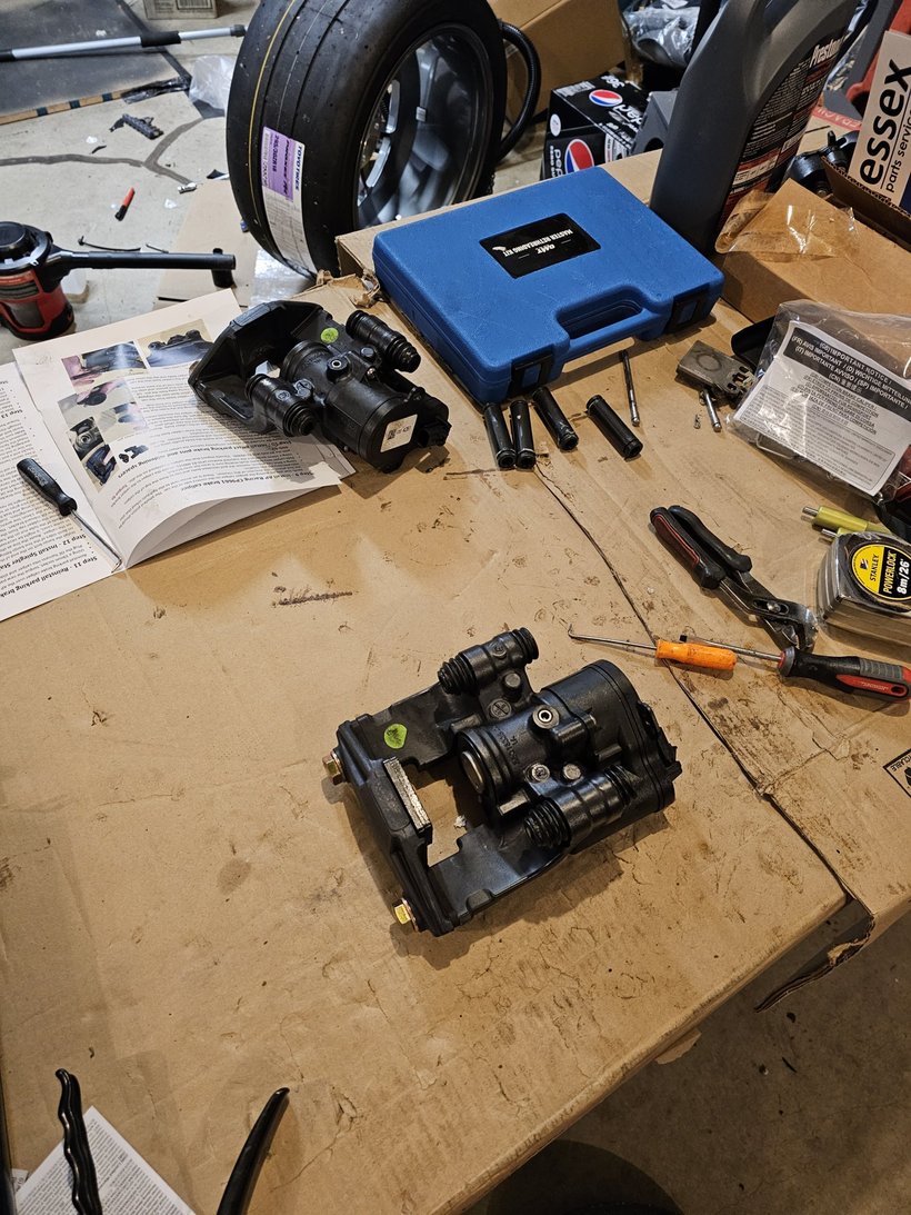

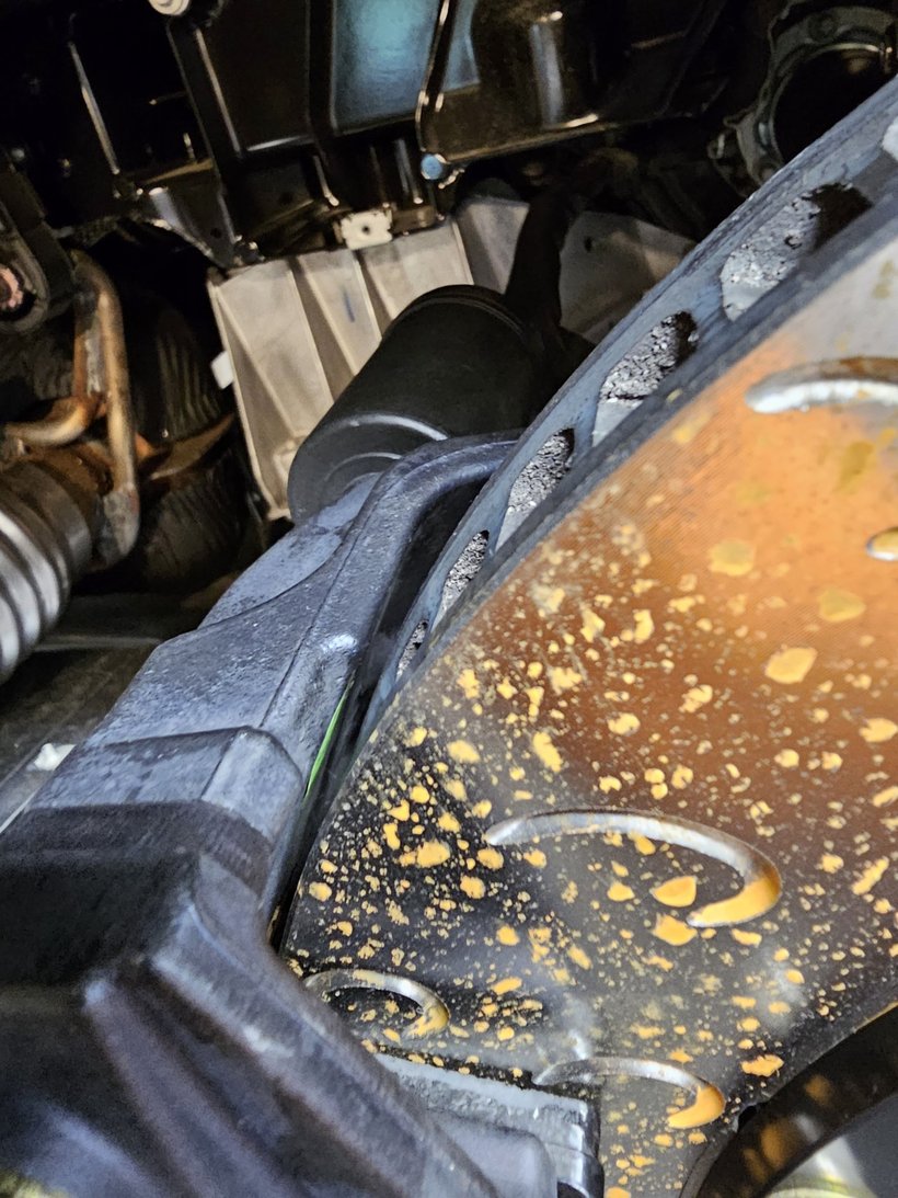

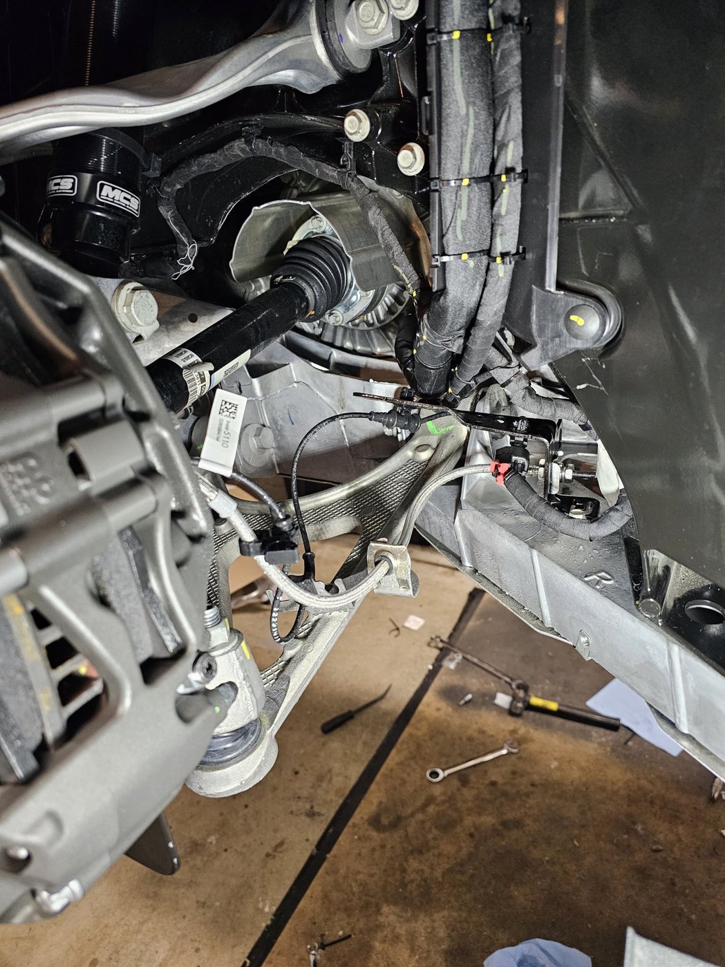

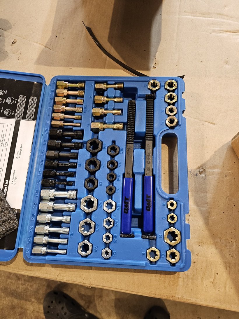

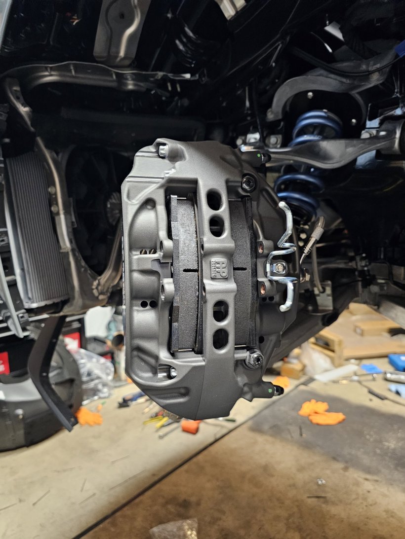

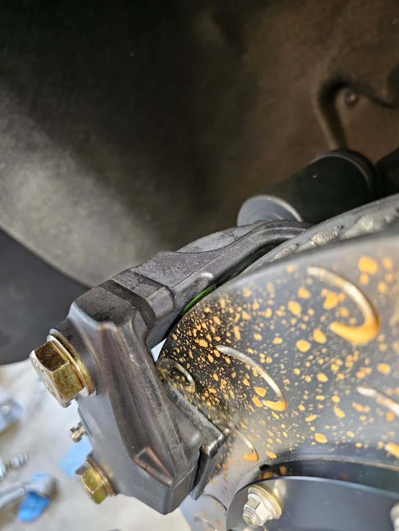

This was the first issue I've had during the install of my initial mods. Instead of clearing the thread, I attempted to install the new line, which made things worse. I was fortunately able to fix it later on with a thread chaser.
9668 front calipers installed. Looking forward to seeing how the pads fare. I was also trying the quick pad replacement bridge when I took this pic, but later switched back to solid bridge since it should help with stiffness.

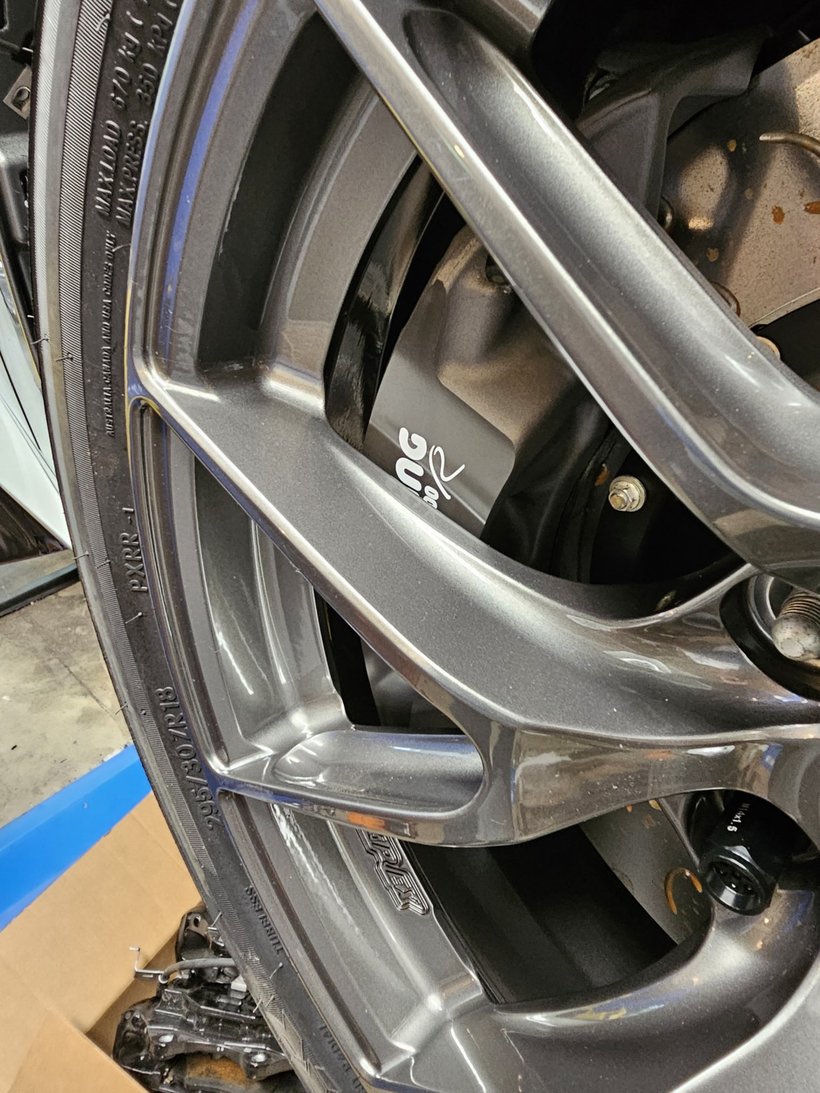

Fitment test with BC Forged RZ39 wheels 18"x10.5" ET52. They provide massive clearance.

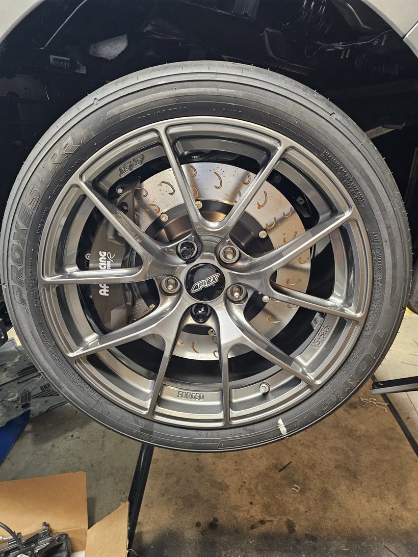

Fitment test with APEX VS-5RS wheels 18"x10" ET42. Perhaps due to much thicker spoke design, the clearance was much less at about 3mm. APEX seems to look a bit better, though : )

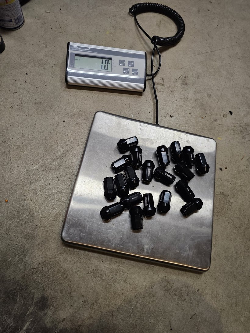

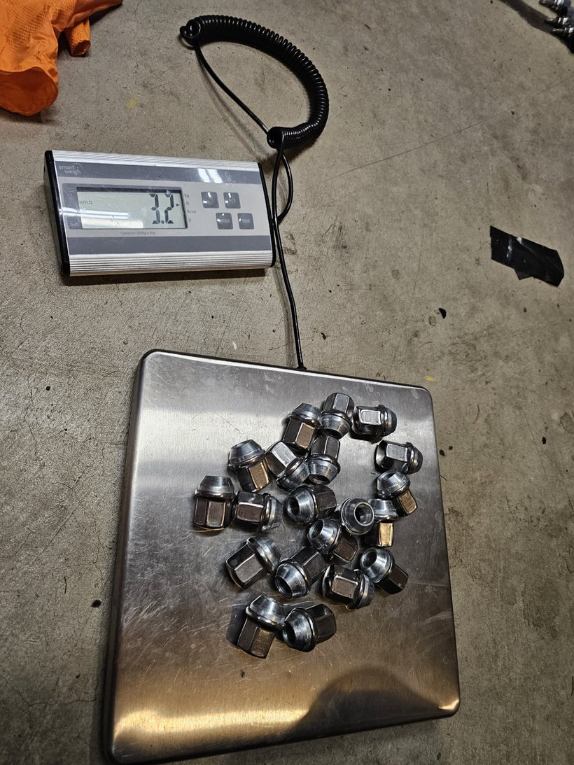

BONOSS Forged Al lug nuts (1.0 lb) vs. OEM (3.2 lb). 2.2 lb savings. The reason I use forged aluminum lug nuts is that they are softer than the lugs, and when something bad happens (cross threading, over torquing, etc.), they get damaged before the lugs. In my more than a decade of using forged aluminum lug nuts, I've NEVER HAD A FAILED LUG. Highly recommended : )
Passenger / Driver sides of rear with wheel liner removed. This plastic trim is missing on the driver side. See the discussion: link.
The top holding bracket for the battery does not fit without removing the handle, but we don't need it anyway; with much lighter weight and the bottom lock holding the battery in place, it is very secure.

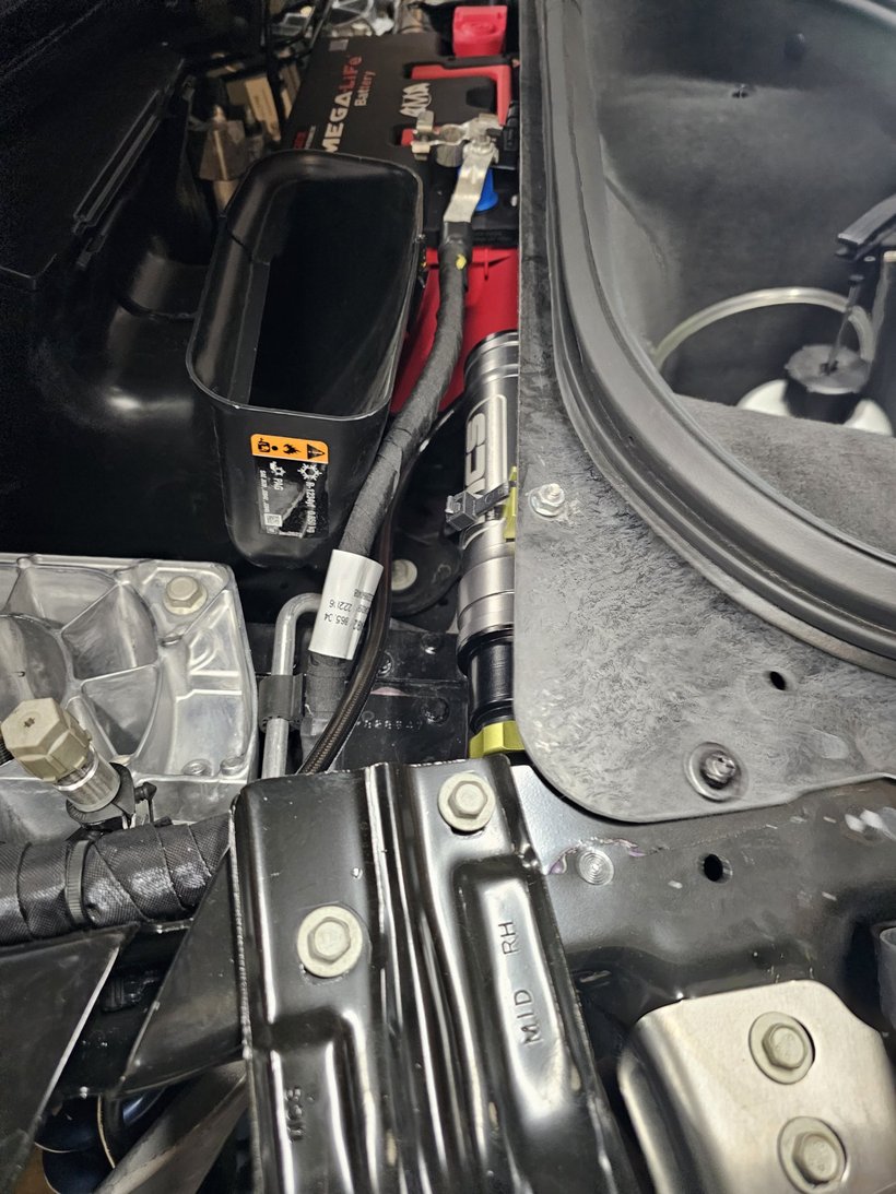

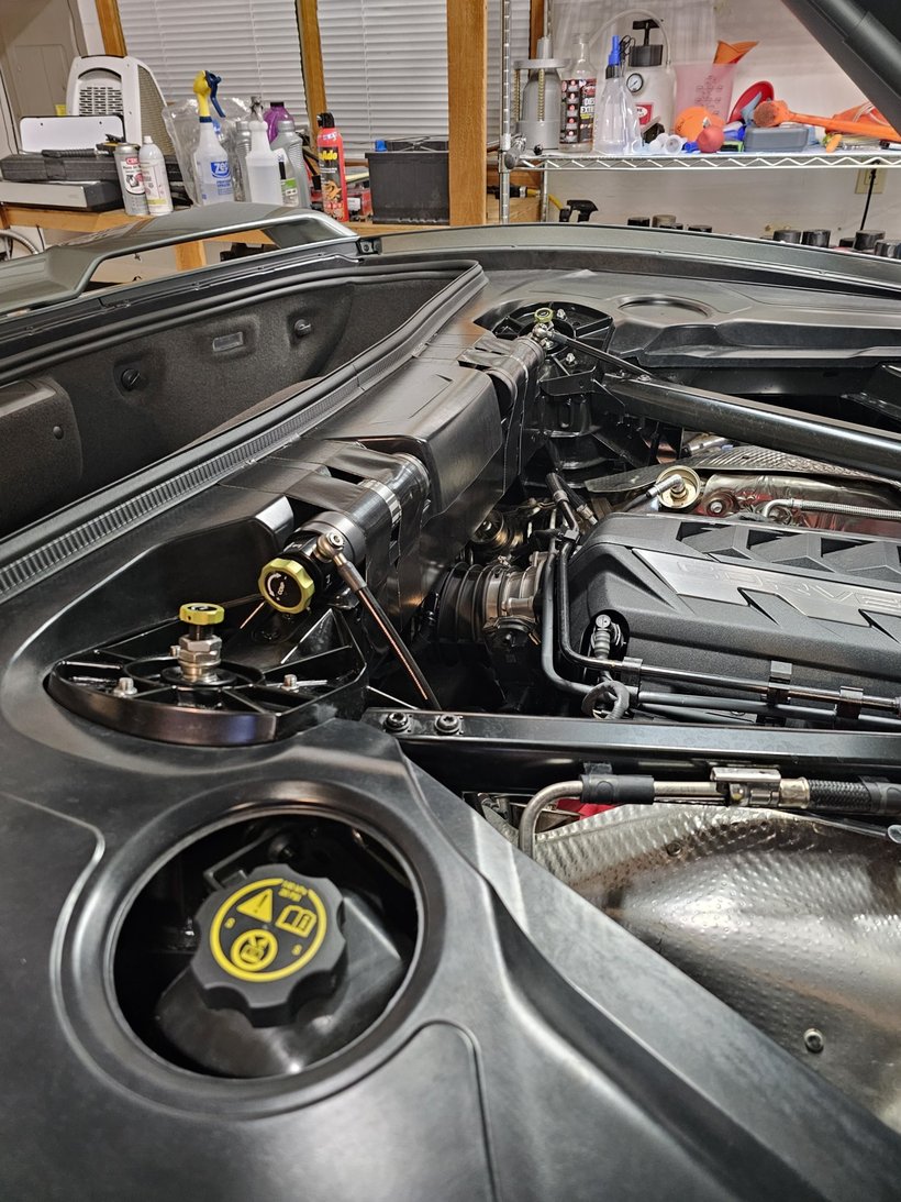

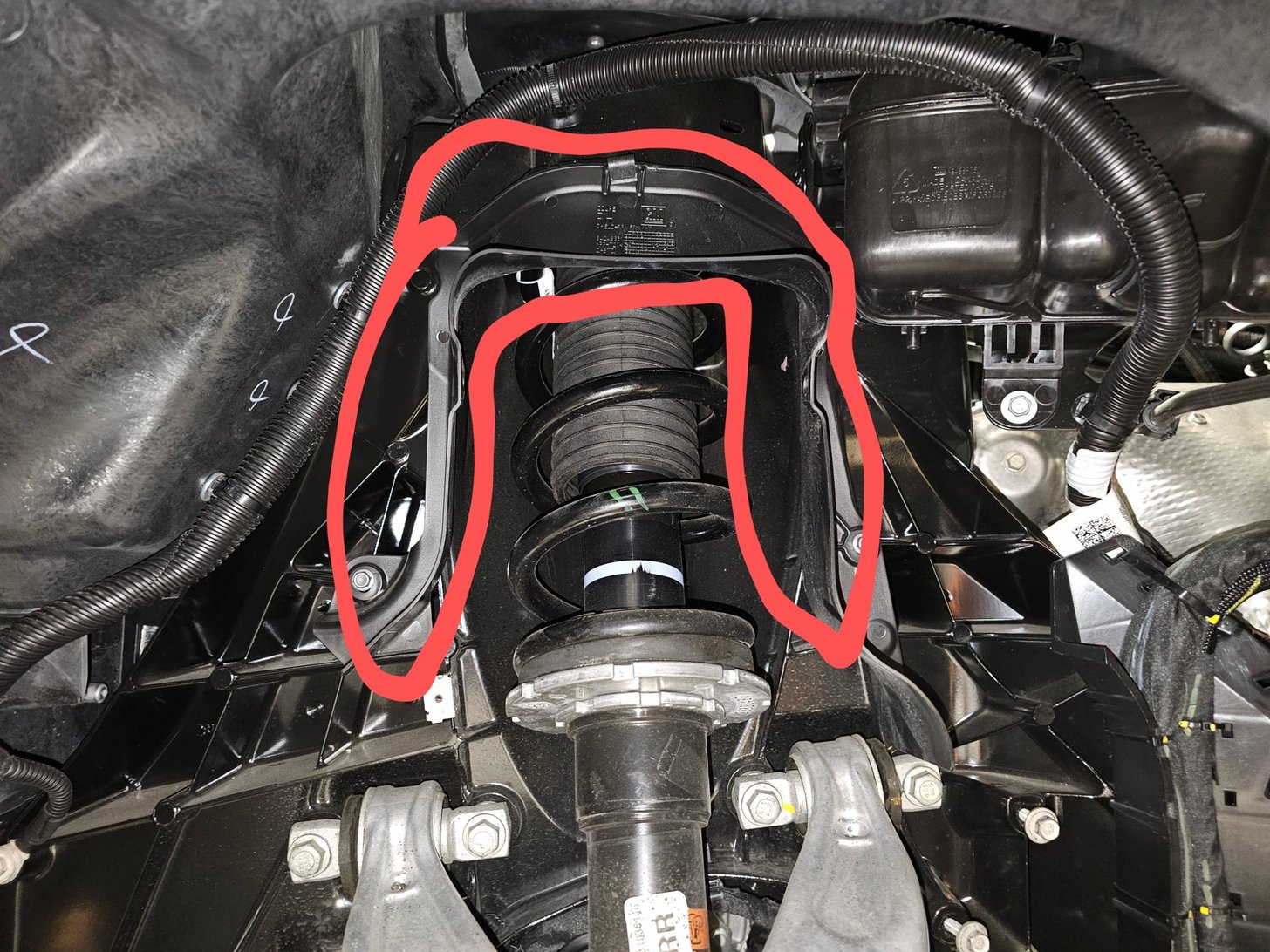

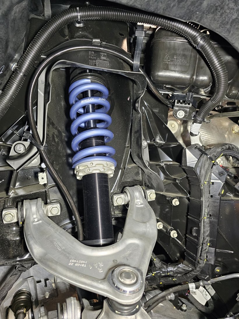

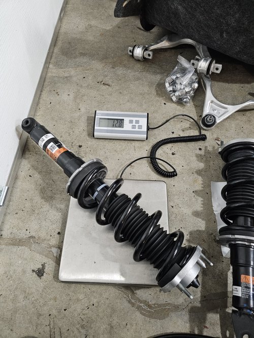

Decided to install the coilover reservoirs under the cowl. For the rebound settings, you need to remove the cowl plastics anyway, so why bother installing them in the trunk, occupying cargo space, and also forcing us to cut 2.5" holes to fit the reservoirs through? The coilovers do not come with dry connect, so you cannot disconnect the lines during the installation, either.

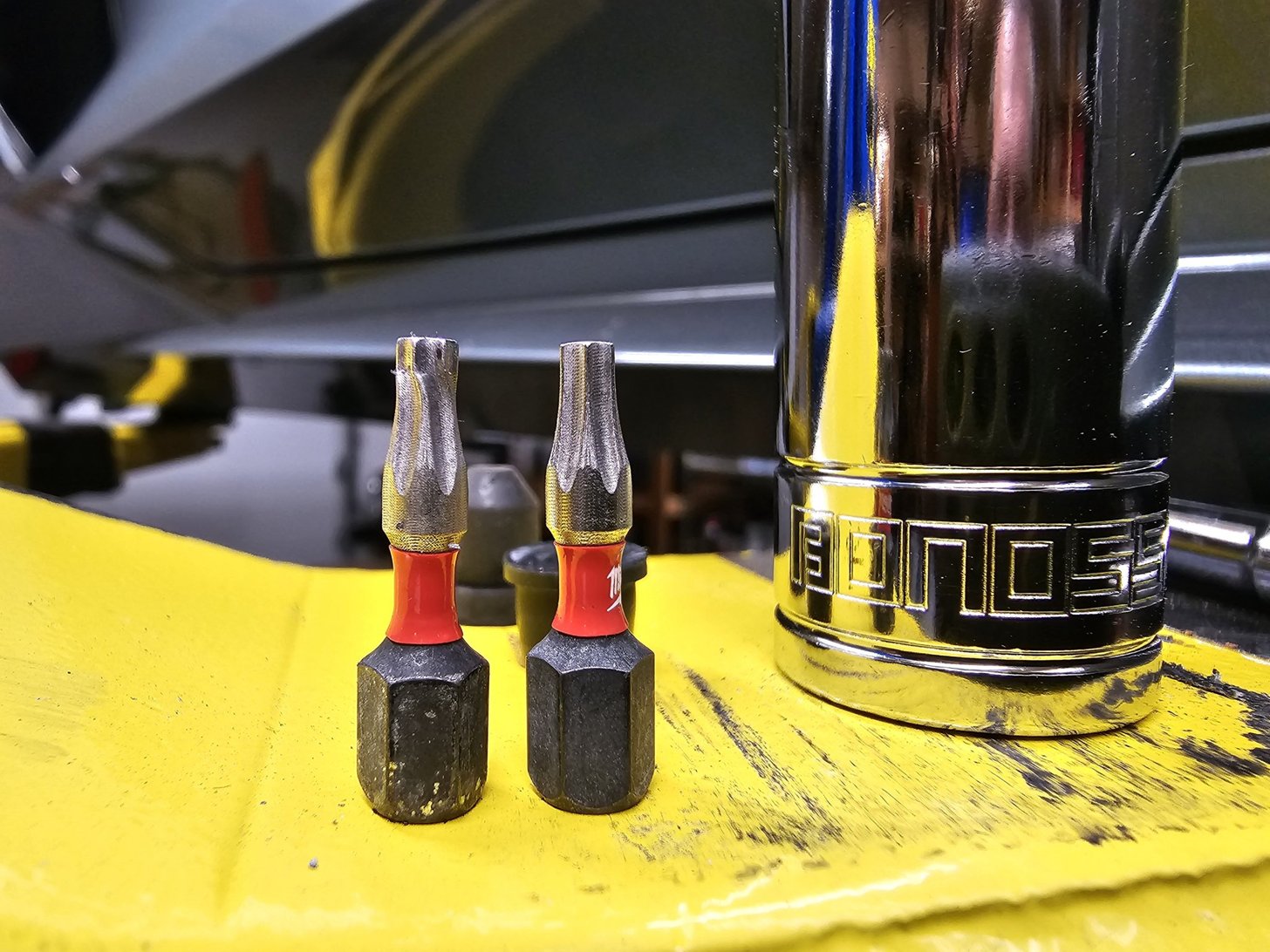

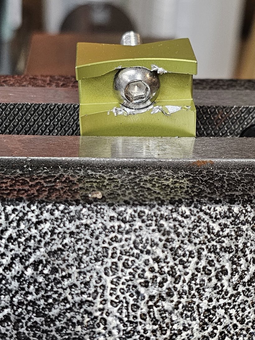

T15 Torx bolts and drives are pretty soft. At some point, after bending the first bit, I've switched to using my power drill from low power impact gun, and limited its torque to protect the bit; works much better that way.

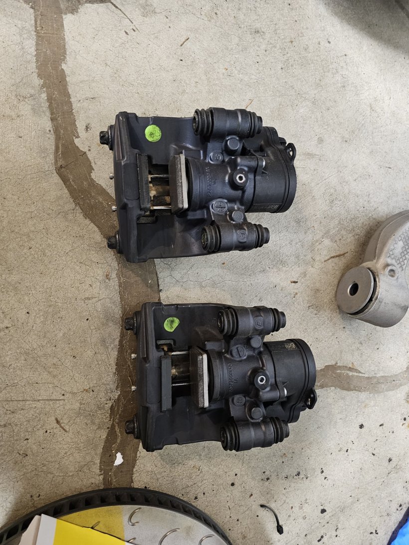

Rear brake calipers; they are huge and heavy.

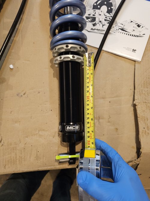

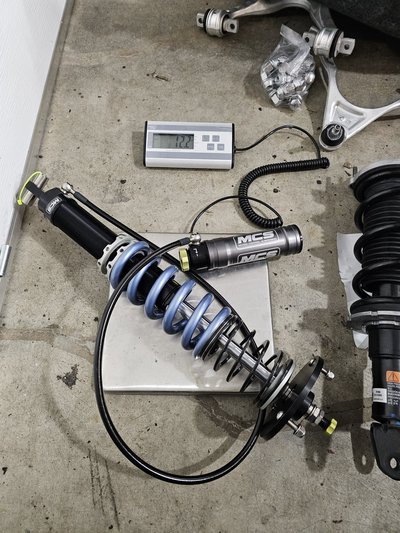

MCS coilovers (12.2 lb) vs OEM rear coilovers (12.8 lb). Their length seem to be identical, so you don't have to drop the height of the car I suppose : ) I say I suppose, since I was not able to get any recommendation on this from Cicio, so I am on my own to decide what is best : )
EDIT: It turns out this location in engine bay COOKS the reservoirs; BEWARE. I ended up relocating the reservoirs to somewhere else (post 272)

Routed reservoir line around that plastic trim. The line is at its max droop anyway, and when the car goes through compression, the line will safely fill the area above the plastic trim, behind the carpet, away from the tire, etc.

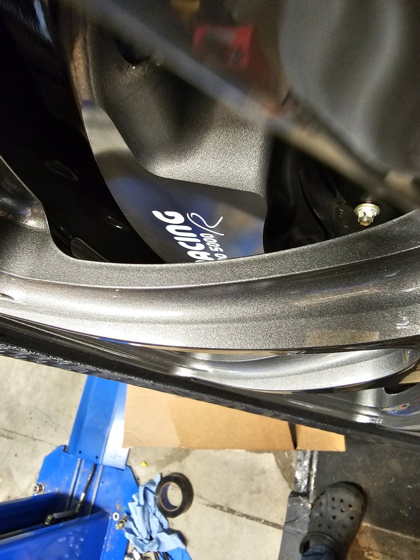

AP Racing 9661 355mm rear BBK (18.5 lb rotor, 9.9 lb caliper, 0.3 lb ss line) vs. OEM (22.5 lb rotor, 9.5 lb caliper + line): 28.7 lb vs. 32 lb OEM; 3.3 lb per rear corner, 6.6 lb total rear weight savings. Significant drop in rotating unsprung mass (rotors) is great.
Carefully cleaned up the threads before install to avoid issues I've had up front.
Replacing the pins of the e-brake with offset ones was very hard for me to do, since I did not want to damage the boots by stabbing them, and with grease everywhere, everything was slippery : ) After spending 30-40 mins on the first one and getting used to it, the others took 5+ mins..
The dark colored spacer provides clearance on thickness, while the offset pins move it away from the rotor for clearance on the diameter of the rotor. Anyway, many thanks to Essex for coming up with a solution!
As in the instructions, tried to mimic the OEM line layout as much as possible.
DONE! This marks the end of suspension/brake mods, which was the hardest part. The rest of the mods should not be too hard, and I should be ready for the first track day in no time.

Any worries about engine heat overheating your reservoirs?

Z06 control arms were identical in weight (or too close to call, within 0.1 lb). Lower control arms definitely look different for Z06, but I am wondering if the upper control arms are actually identical. When parts become widely available on other online stores, I'll check. So far, I had to use parts.gmparts.com to locate all the part numbers since the other online stores did not have any parts in their catalogue.

GM engineers mentioned they've used hardest rubber they could use on the Z06 control arms compared to Stingray to reduce deflection with higher traction tires and suspension. If it's similar to how C7 T1 kit's control arms were compared to regular, they might be as much as 500% stiffer. With that, I think they might provide an excellent compromise; not as good as monoballs, but zero noise, zero vibration.
If you think about it, we install the reservoirs in engine bays of front engines cars ALL THE TIME. With enough air flow, they never heat up much. I don't think it will be any different in this case, and at least they will be getting quite a bit of air flow. These reservoirs are supposed to help dissipate heat for the coilovers as well, so air flow would help. I think those indents provide excellent location for these reservoirs, as if they were designed for them : P They are pretty far from the engine within the bay, and are right next to the air outlets. In short, I think it will be OK.

Coilover height settings
OEM height of the in my garage (WARNING, it's not completely flat):
FL/FR/RL/RR from the ground, in mm):
700/690/723/730
Since my garage surface is not leveled, I am not too worried about the variances, and I only moved coilover heights in EQUAL AMOUNTS on both sides. This is something I've learned when I tweaked coilovers in C7, where I've transferred weight to one of the diagonals by mistake, severely messing up settings. The final settings will be done by the race shop handling my alignment + corner weigh balancing.
Avg. OEM heights: 695 Front, 725mm Rear.
Target with 15mm drop: 680mm Front, 710mm Rear.
Target offsetting Toyo RR diameter differences: 670mm Front, 714mm Rear.
*****Coilover perch settings to hit this ballpark:
  • Front: 70mm from the bottom thread to where the load bearing perch starts.
  • Rear: 165mm from the bottom thread to where the load bearing perch starts.
  • I wish someone gave me some ballpark settings like this, so I'd not have to do many 'experiments' and measurements : )
Justification: Since I'm using much smaller diameter front tires, the total front height drops by another 10mm just due to tires, and I need to take into account. One might argue I should actually optimize for the tires I'll use, but I plan to keep the OEM rake in suspension, and this way, it will also work well when I use 315 fronts. Besides, more rake created by 295 front Toyo RRs likely only help reduce front understeer.
Played around the coilover heights and took notes to understand how it behaves.
Getting close...
OEM GM high wing
Before I put the tires back, decided to get done with the high wing as well.
It's probably not mandatory, but you'd need to clean the old adhesive for a clean install of the high wing, which already comes with its own.
Thankfully, I always stock various adhesive removers.. : )
Done! I'm really liking the looks..
Another angle; looks great!
