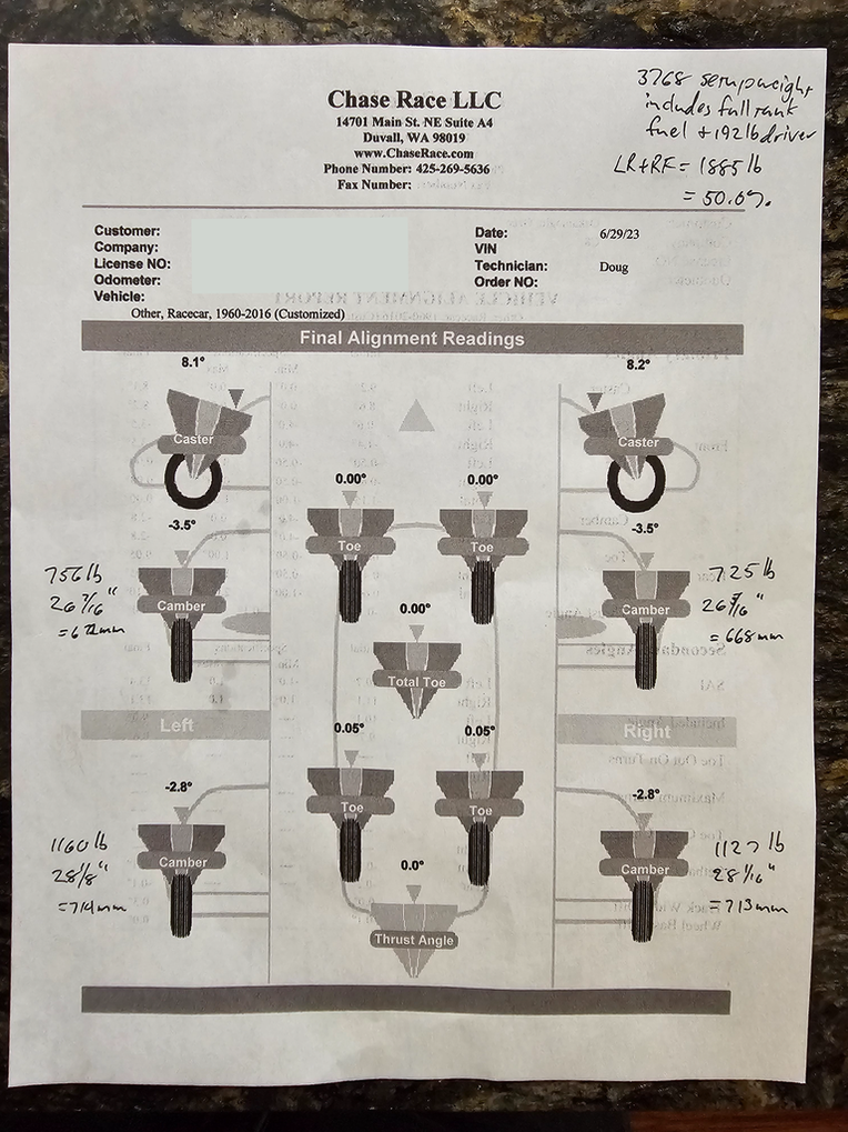

Alignment Specs (Camber, Caster, Toe; in degrees):
  • Front: -3.5, 8.1, 0.00
  • Rear: -2.8, 0, 0.05
Heights, weights with 192 lb ballast, full tank (FL, FR, RL, RR)
  • 672, 668, 714, 713 (mm)
  • 756, 725, 1160, 1127 (lb) --> 3768 lb total; 3576 lb curb without driver.
  • LR + RF = 1885 lb; 50.09%.
Note: We had to remove even the small washers on UCAs to hit the numbers
Alignment sheet

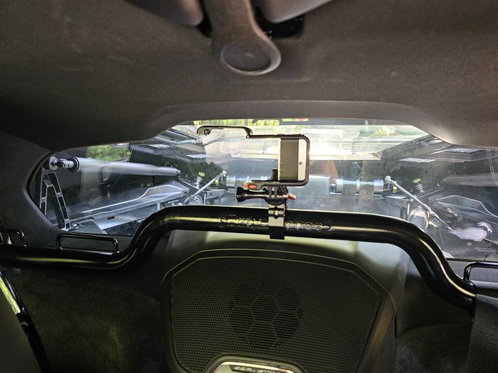

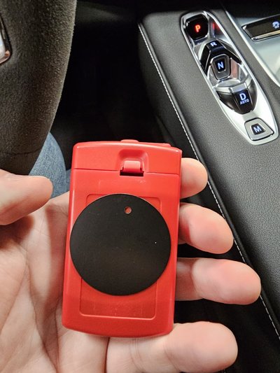

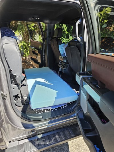

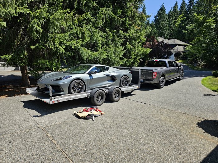

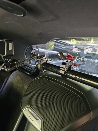

Figuring out little details before the first track day:
I wish the OEM side skirts I bought were actually extending them; they're just covers. Anyway, a cover in there is not a bad thing since it'll take beating.

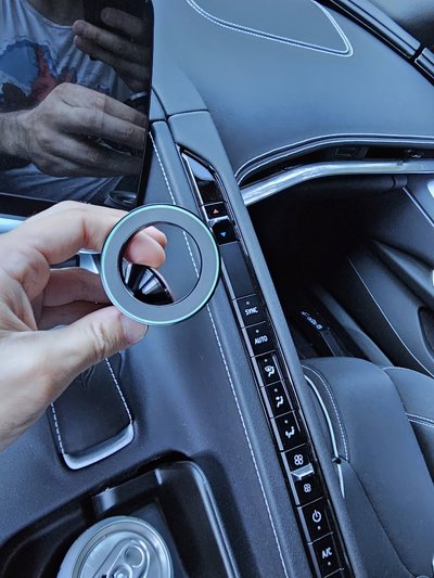

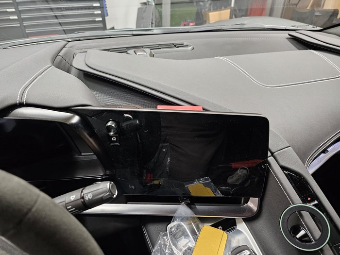

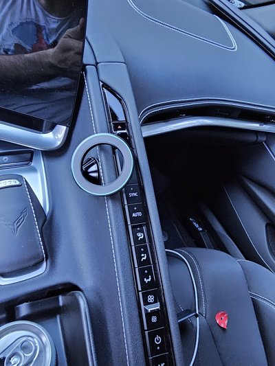

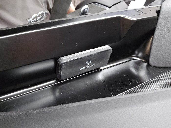

Decided to change phone mount again. This one covers a few of the HVAC controls when the phone is on it, but at least it's right by my eye sight and away from direct sunlight, which sometimes causes overheating of phones.
Installed a small metal plate behind the GPS transponder by its battery lid, and installed a magnetic strip behind the infotainment screen for easy mounting of the device in direct sight of sky. The metal plate didn't seem to hinder the performance of GPS signal, especially considering it's on the battery side, and not by where its internal antennas are.
EDIT: This did not work well; signal strength was not good.
Found a bicycle bar mount that worked perfect for my Insta360 camera. The original location I found, as seen in first pic, was not centered and was also tilted a bit. This one is so much cleaner and short (i.e. less flex and jitter).

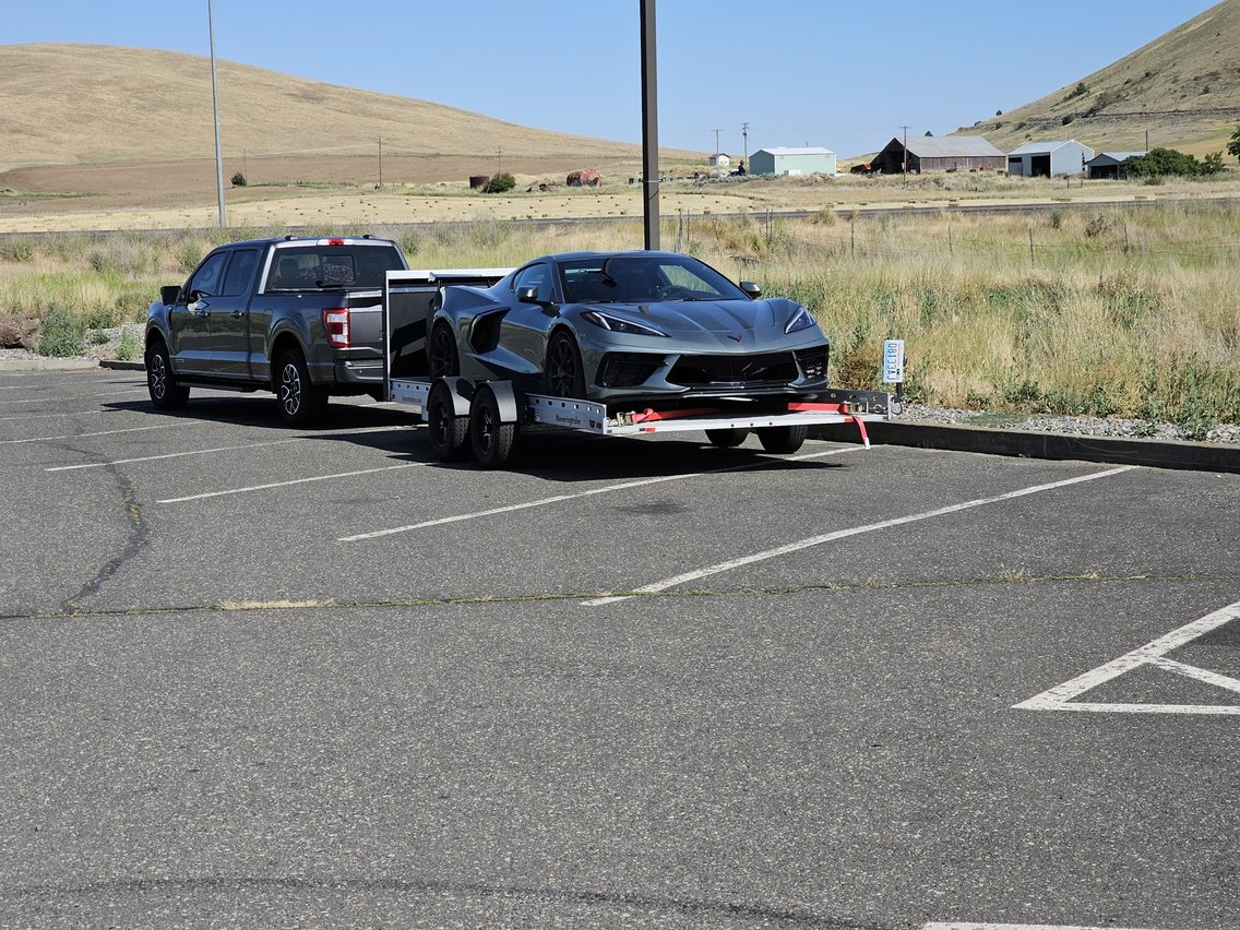

I have winch the car in with its back first to hit the desired tongue weight for the trailer. A longer trailer would help, but then it would not fit into my garage : )
I don't need any boards to load up the car, but since steering is now at the back of the car being loaded, my steering corrections are delayed (causing an arc of direction change instead of a direct change), making it harder : (
I left the car in accessory mode in Neutral while loading up, which requires you to start the engine first (I think). This would be a challenge if you lose the engine, and need to tow the car at the track; they'd need a flatbed.
My camping bed is ready! With the HVAC and audio system running whole night with the hybrid system, it should stay very comfortable even though it's going to be hot out..

Great Info. Question about the alignment. Did you achieve these specs with the thinner washers between the body and upper control arms? Or did you have to go to no washers at all?
Also how does just removing the washes effect toe? Can the washers be installed and removed without impacting the other alignment parameters (other than Camber of course)?

Thanks for the question, I'll edit the post and add that "we had to remove even the small washers to hit the numbers".
My ride height is ~15mm below stock, and higher than some others' setup. If lower, it'd probably hit higher targets, too. I always like staying close to OEM heights, since the car's cooling, wheel clearances etc. are all designed for it.
Good to know... No washers for your (Track Spec) Alignment.
I still wonder can you add and remove the washers without impacting the other alignment parameters (other than Camber)?
And another question. Can you reduce the ride height 15 mm as you did without impacting the alignment parameters? If not which are effected?

If you remove the washers it changes the toe.

Everything changes alignment parameters, really. When someone sits in the passenger seat - camber and toe change. What is an acceptable change in alignment after changing something relevant? That is pretty user specific. Some people need alignment specs perfectly dialed in always, and some people can be a bit more lax.

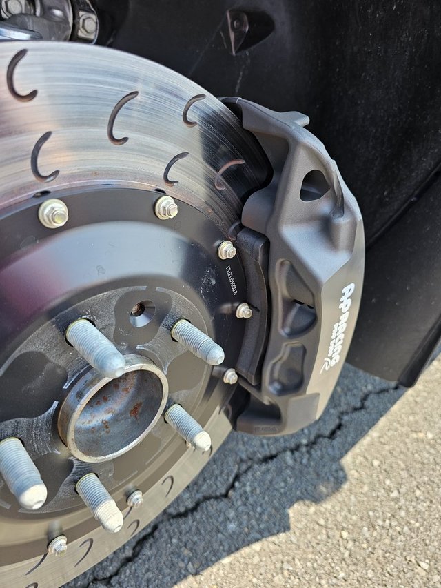

    • Brakes: They did well, and I didn't notice any behavior from brakes, which is a good sign.

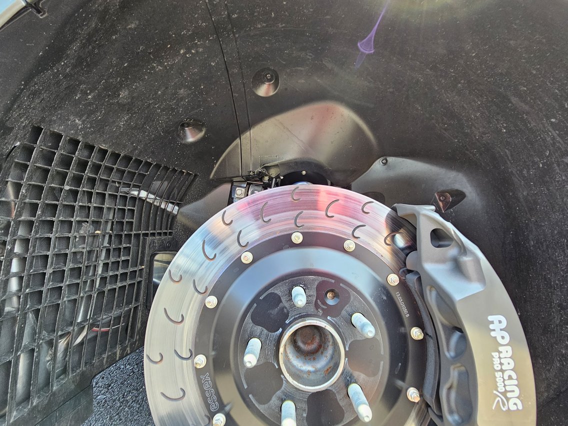

There was no visible wear or rub on the wheel liners (both front and back) with Toyo RR 295/30/18, 345/35/18 tires.
Brake pads are also in good shape.
