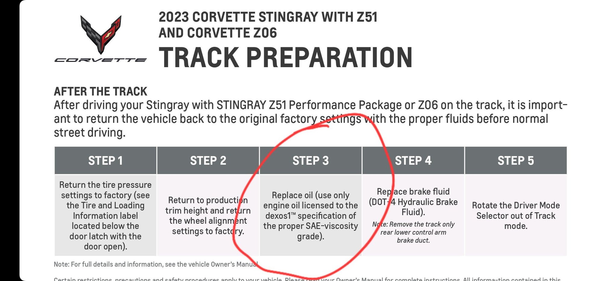

Is 5W-50 even recommended for these engines? I thought I saw the recommendation only for the Z06 (LT6).
The 15w50 is in the track prep guide but a misprint/ carryover from c7. The z06 runs 5w50 not 15w50 so makes zero sense in modern times to recommend 15w50 that isn't dexos when 5w50 that is dexos exists.
The 0w40 esp X3 dexos 2 has a 3.8 ht/hs compared to our 0w40 supercar 3.5. Ravenol RUP 5w40 is 3.9 and dexos 2. Motul 300v 0w40 is 3.9. m1 5w50 supercar is around 4.4.

It is clear that HTHS will be better with the thicker oil. That said, for a platform known to have lost quite a few engines and transmissions that were lost at the track, it's a tall order to just use a different oil and take the liability risk.
I don't think 15W-50 is a typo. After all, LT1, LT4, LT5 were certified for it (for track use), and LT2 is just an updated LT1. In any case, I'd never use it, since these cats clog, and they become a nuisance when they do, sipping power without you knowing, and finally cracking the headers, causing downtime.
I think we'll have different opinions on this, but 0W-40 is 'good enough' in my opinion, and I'll stick to it until GM approves 5W-50 as well. I've always had excellent wear results with 0W-40 ESP on C7 used on both LT1 and LT4.

Yeah Cup cars have been using 0w40 forever. I just assumed you didn't care about the warranty lol.
And the 15w50 is a misprint as its listed as applying to both the z06 and stingray. No way you would drain 5w50 dexos R from a stingray and put in non dexos 15w50.
Then later the track prep guide says to put back in a dexos 1 oil. That's way outdated and another misprint lol
