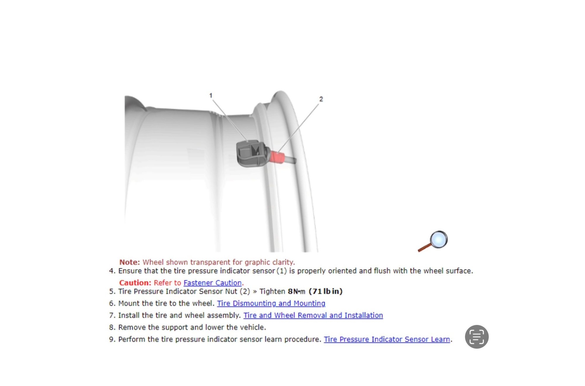

Anyone know the torque setting when installing the TPMS? It says 8nm on the side of the unit so I’m guessing that is it.

Found it
