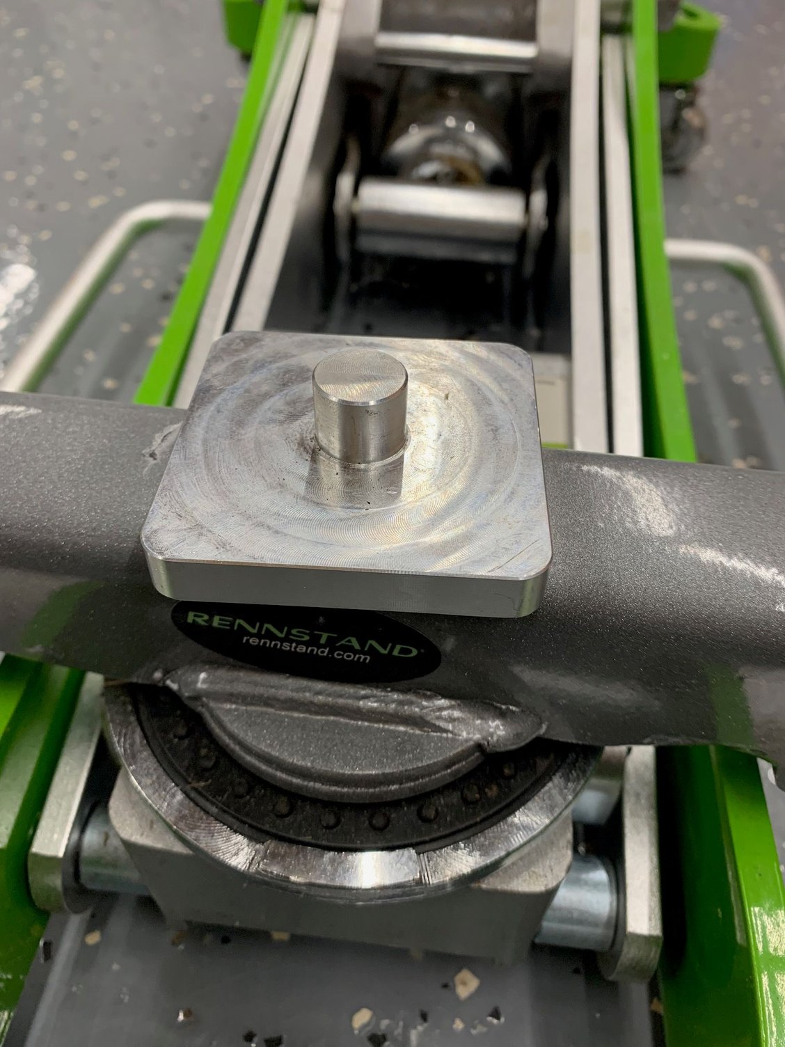

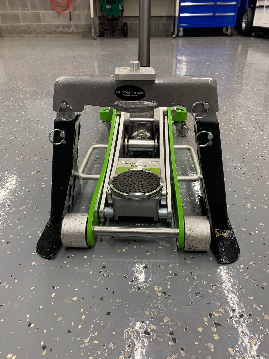

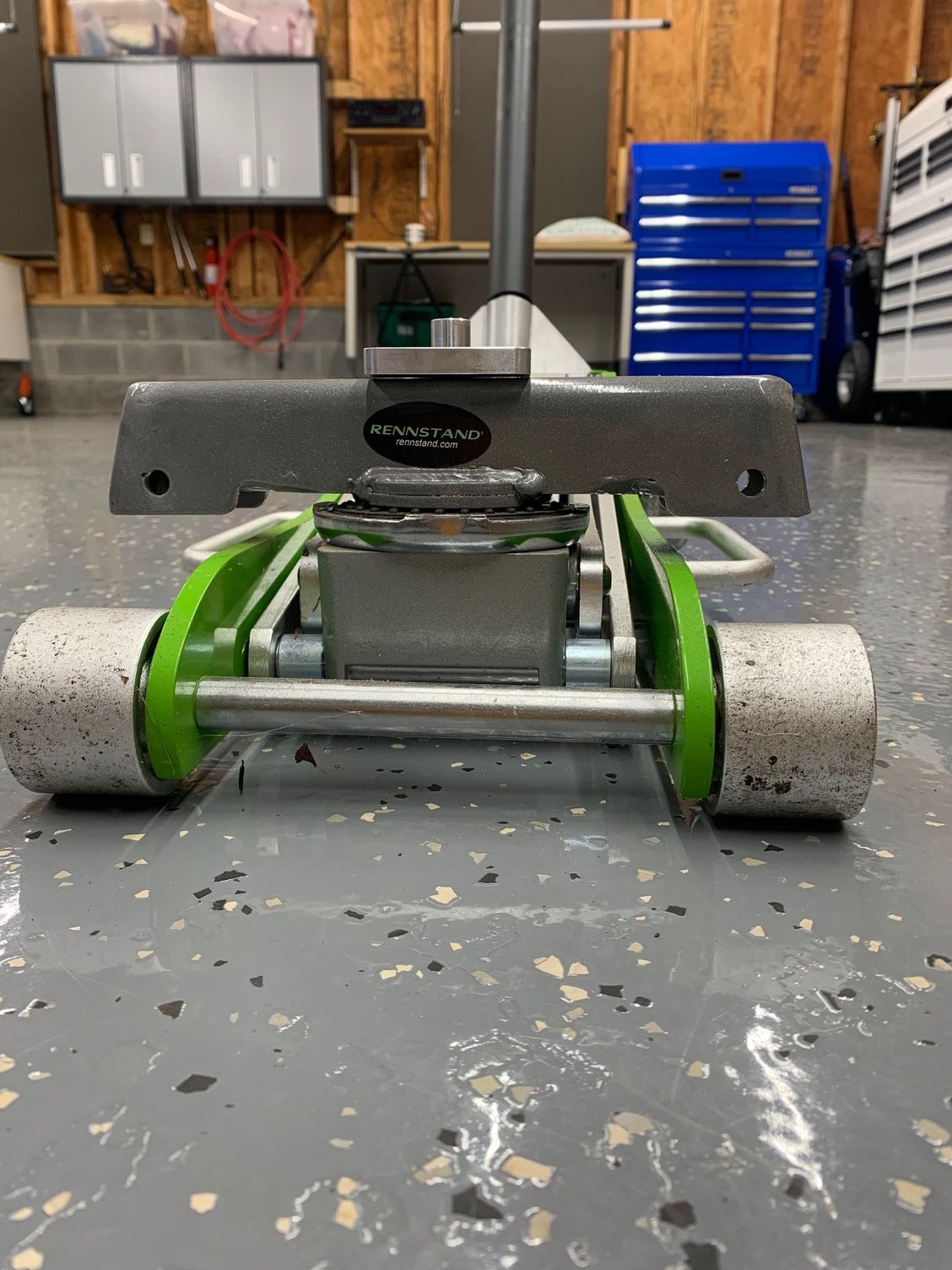

rennstand.com
These work great. I jack it up about 2 inches , then slip a 2 x 6 under the tire. Let it down and then put the top of the jack stand in place. The board gives me the extra clearance to roll it under the car. I only bought one as I do not plan on taking off more that one wheel at a time. Got mine from amazon

Could you post a photo of your car up on one corner using the Rennstand? Which did you buy? I held off because I was afraid it’d be too wide.
Rennstand seems like a great solution. Your jacking point = Jack stand point. The only other solution I’ve seen is quickjack which is a wee bit expensive for my taste.

Rennstand for corvette/range rover 18M-rs3-k18 This will give you the needed "puck" . You will not need any additional adapters. I currently do not have the C8 to take pic.
The one jack stand setup works well for me as i only wanted to lift it enough off of the 2x8 to be able to remove the tire.

I also use the Rennstands. I have 4 they work great except like stated have to lift and place on 4x4 or race ramp first to get it high enough to use. Other than that. Perfect
