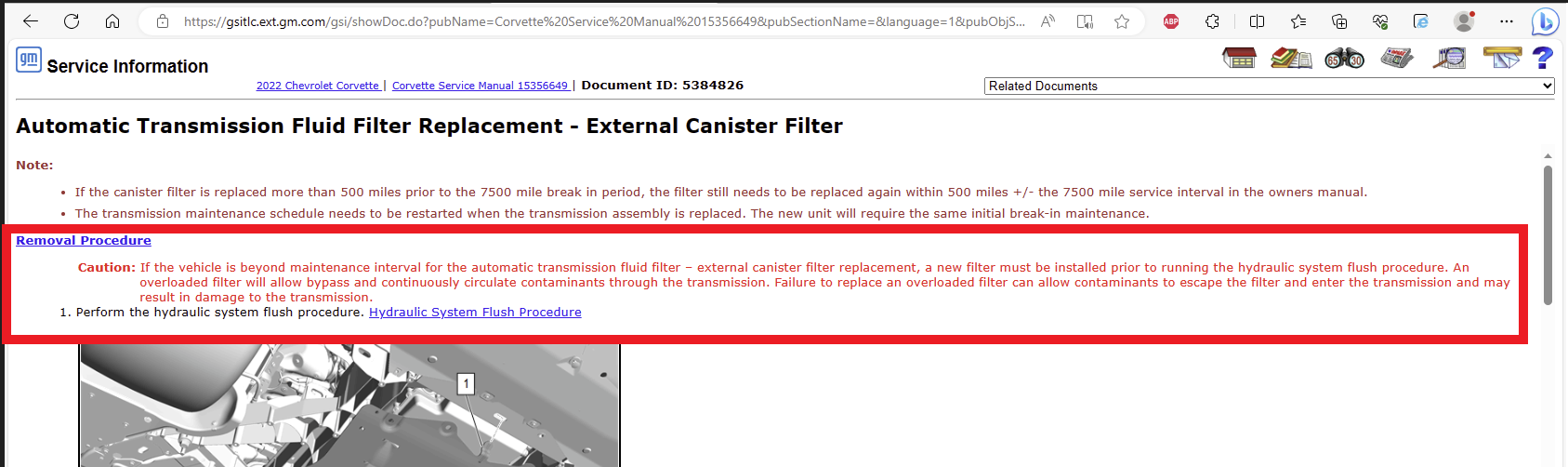

There is a condition in the Service Manual where that is recommended. If the DCT external canister filter is being replaced beyond the recommended replacement mileage, then the manual says to replace it, then run the HSF, then replace it again. The manual states that this is because, if the replacement is being done late, then the filter may already be full, and there is a concern that the flush would actually result in unfiltered fluid flowing through the system. This same guidance also appears in a techlink article here:
https://www.corvetteblogger.com/2023...e-c8-corvette/

Andy, agree 100% for a filter that is beyond the recommended interval. But see no need if doing earlier than the manual requires. If that were the case then the filter is tremendously undersized
