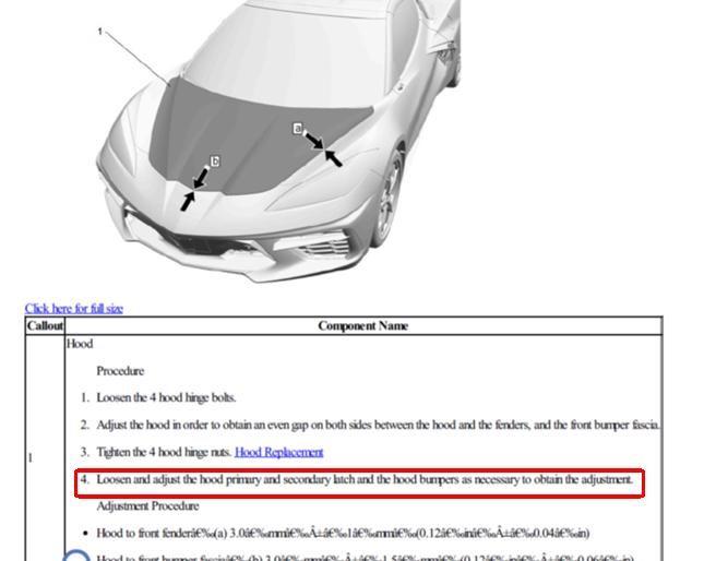

Originally Posted by EVL-C8
Can the Frunk lid be adjusted?
Mine is about an 1/8' high but the rubber stops are all the way in and you push it down
when closed but it springs back up to the stuck high position?
Like the latch needs adjusted lowered?
I just noticed this today the way the sun was hitting it?

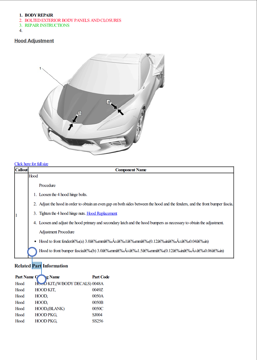

Yep, makes sense. Since you have "plenty of free play but it just does not 'stay there' " the front latch (b) just needs to be lowered.
As @Andybump Pic shows need to loosen front latch bolts and lower. Then tighten bolts! Need to remove the front trim to access.
