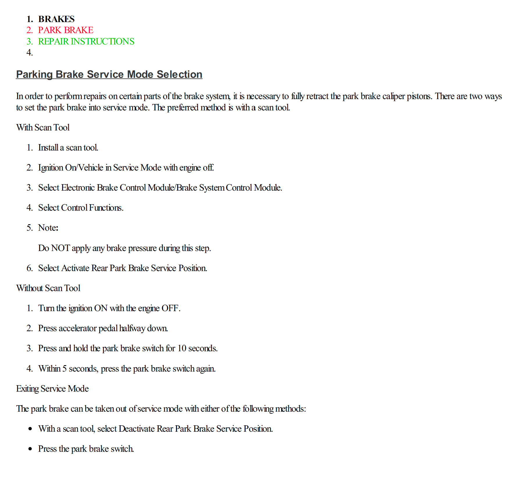

So, before doing a brake job you should have disconnected the battery. However, if you were planning to remove the parking brake, you must, while the battery is still connected, fully retract the parking brake caliper piston by putting it in the Parking Brake Service Model. Attached is the instruction from the Service Manual.
You may have to complete the rotor/pad replacement for the main calipers before you can reconnect the battery to retract the parking brake caliper piston. If you connect the battery with main calipers removed, they may activate and you will have bigger mess.

I do have the battery disconnected at this time. I always have done that with pad changes.
I'll put the new pads in the caliper and remount it then follow your instructions.
