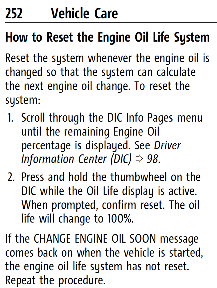

I have a 2024 so I cannot reset the DCT oil or filter life without GDS2??
Why not? Its described in the 2024 Manaul.

that’s why I’m confused…Page 11 of michelev’s document says to use GDS2 for 2023+ while prior years can be reset from inside the car?
OK. At least I know why you said that. I can't explain the discrepancy though.
You only need the GDS2 if you are going to change the DCT filter and want to perform the hydraulic system flush prior to removal and the leak check after filter re-installation.
