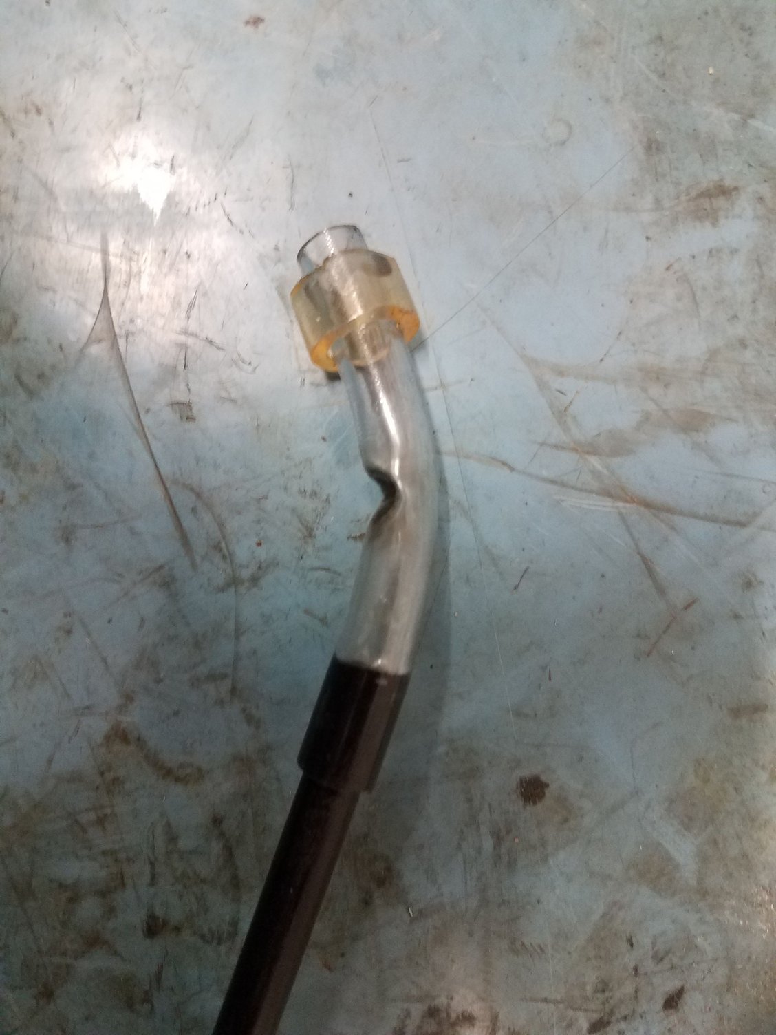

I pretty much followed the SIX service manual procedures that are invoked. I've attached them for other people that want to do this on their own. What is unique is how I got the fluid in. I used a garden sprayer that I purchased to dedicate for changing DCT fluid. I cut off the tip and used a couple pieces of Tygon tubing I had laying around. The larger collar seals the filler plug hole so fluid doesn't run down the smaller tube. Next time I may make more of a U shaped end so the fluid doesn't want to run down the side of the tube. The problem with sealing the fill port is you don't know when it is full. There were wires or something partially blocking the fill hole so you need to be careful not to damage them. And if you use a collar make sure you don't push it all the way into the port (that would be bad).
I also used a piece of bailing wire that I looped around the handle to keep the valve open but could be quickly pulled off when the DCT is full or if something went awry. It took about half an hour to put a gallon in (it took about 8 1/2 quarts total) so I could do other things while it was filling.
