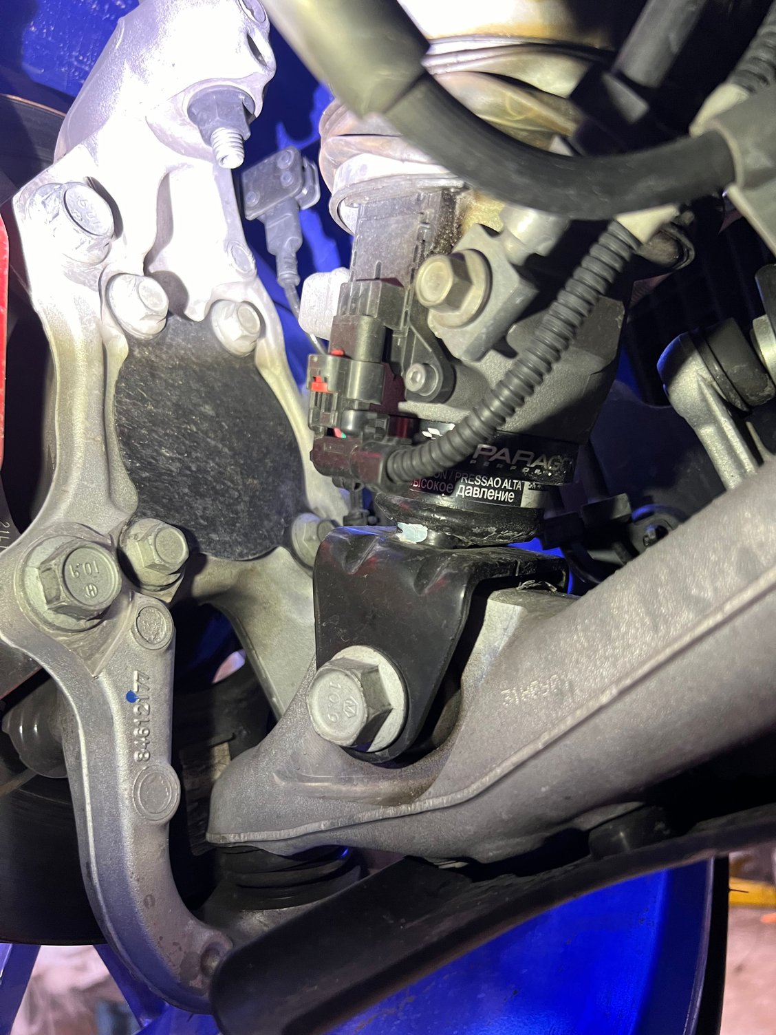

Correction: Paragon Lowering Collars caused actuator failure on strut. Not a bent strut.
Dealer sent this note:
“The front shocks are damaged from the lowering spacers which GM has seen it before do you want to contact the company that you purchased the lowering spacers from or find another option we could install new GM front shocks estimate $3850.00. The boot at the top. The lowering kit damages the shocks so I can’t do it under warranty and the lowering kit will damage new shocks. It’s an internal problem it damages the actuator. The motor that adjusts the height.”
I sent info to Paragon after hours. Hope they will assist. These have been very popular. Wanted to get some informed forum feedback from others before I call Paragon tomorrow. Message on dash says “axle lift needs serviced”.

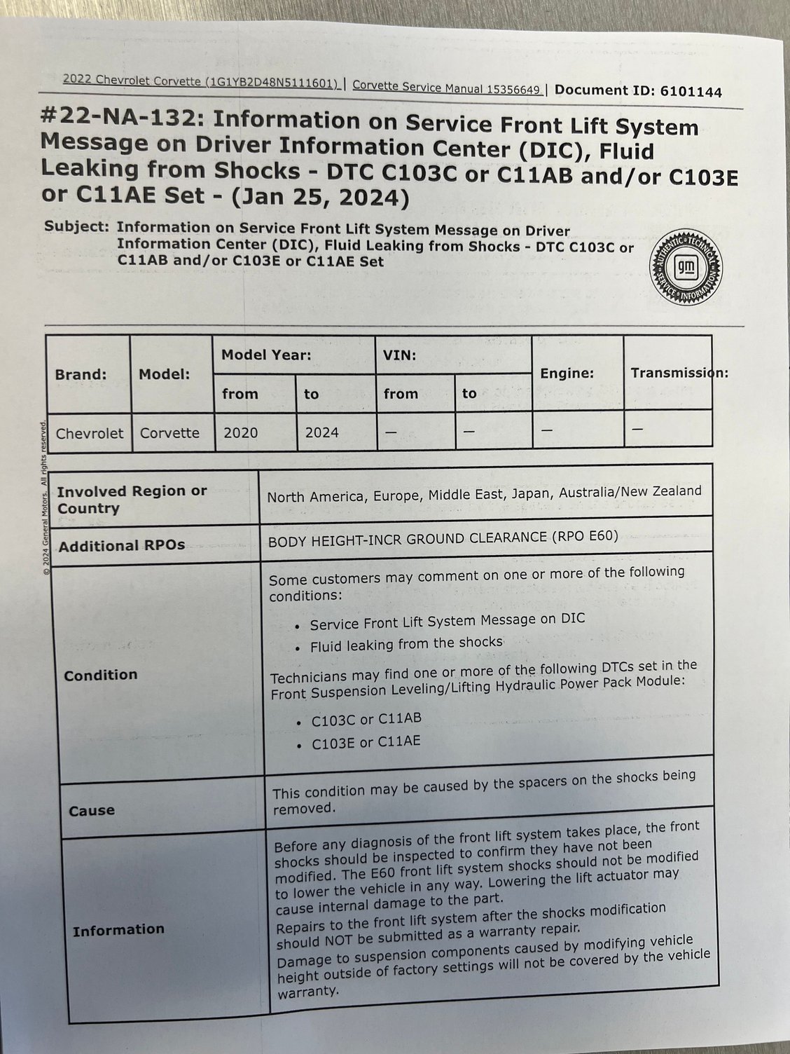

GM has a notice out to dealers specifically alerting them to the Paragon lowering collars. Replace your shocks and go with lowering springs instead. They can do much better on that estimate though! The shocks themselves are about $325/each from RockAuto and you're looking at 4 hours MAX in labor. I replaced all 4 magnetic ride shocks on my C7, working alone, no lift, in 4 hours flat.

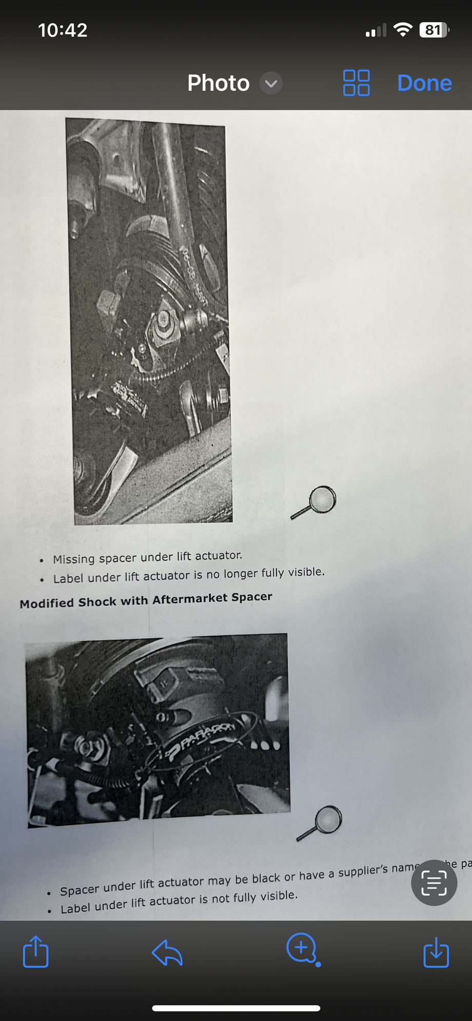

I did just get the copy of GM bulletin picturing paragon collars in their Jan 2024 bulletin. Hoping paragon will partner and provide good customer service on a solution.

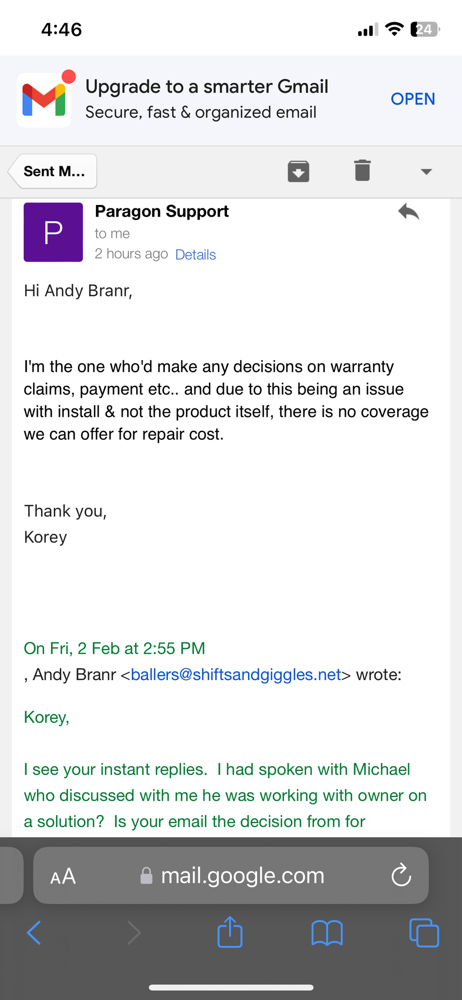

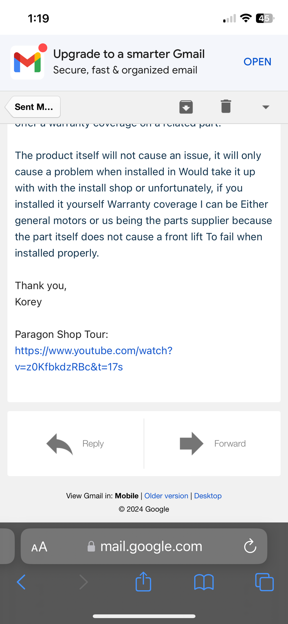

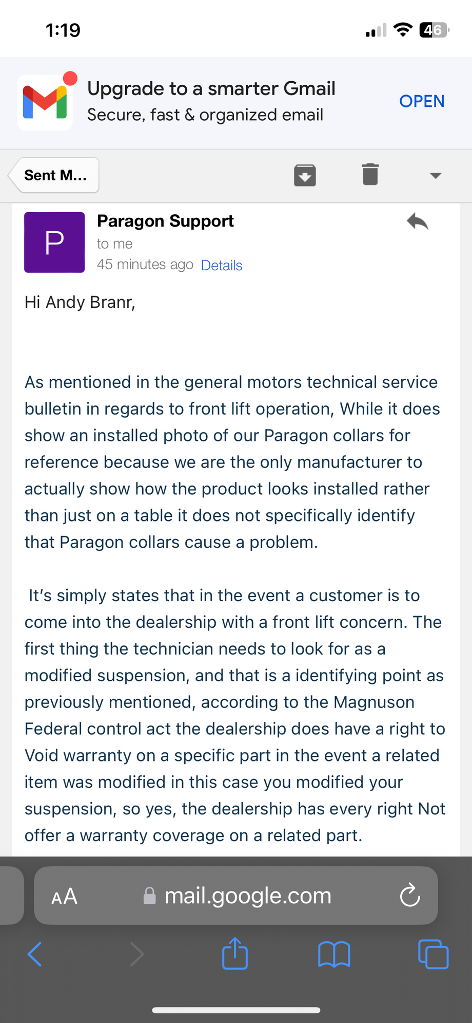

Michael at Paragon eluded to working on a solution. He asked me to email the GM Bulletin attached below. Instant email reply from Korey at Paragon passing the buck as install error. Zero effort to work out a solution. I’m easy to work with. Just show some support. Again, poor customer service from a perceived top vendor. Michael never called me back. Please PM me to add your name to the growing list of axle lift issues.
Here is the instant email reply. The only suspension change are the Paragon Lowering Collars.
Paragon reply and denial
Confirming discussion with Michael. Never called back. Korey confirms denial and not interested in discussing any solution or help.

Actually folks, when the front lift fails because of lowering collars it IS an installation problem. There is nothing inherently wrong with a longer shock collar that causes a front lift problem - it is damage caused by the installation.

Who do you think you're going to sue successfully. Paragon didn't perform the installation and never warranted the installation, nor guaranteed their part wouldn't affect the factory warranty. Unless the Paragon part failed, I don't see that they have any liability at all. Nor does GM. Any time you modify a car you need to be aware that you're taking the risk.
