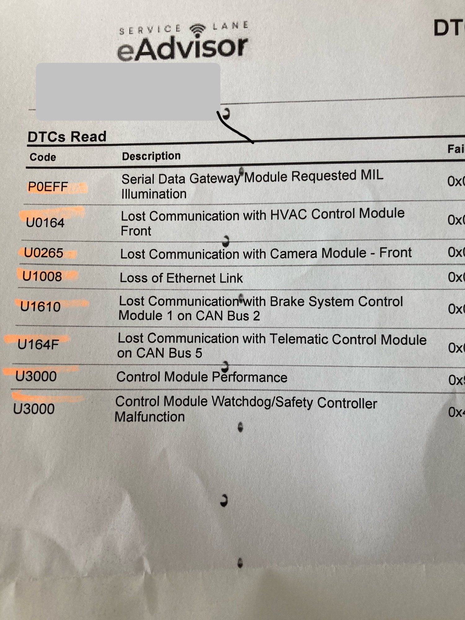

so I took it into the dealer today, and it was a worthless visit, because when I got there, I was told that the GM technician has taken sick and had to go home. But the service advisor did pull all the codes for the GM system. it looks to me as if it’s more serious than just an AC module. My question is: from a technical standpoint, is the car set up so that if one module fails, a significant amount of other modules may lose communication because it’s some type of daisy chain? here is what they found. I don’t even have a front camera! Any comments would be helpful. I am scheduled to go back in late next week. Meanwhile, the car continues to run perfectly and generate no warnings, panels, messages, etc.… And also meanwhile, my Chevy app continues to tell me that my car is 100% healthy and nothing is wrong… What a worthless app…

I suspect a singular control module or the connection to it is to blame. Everything likes to "talk" to everything perhaps through a singular module. Should be easy to pinpoint the failure point. In the meantime, enjoy putting miles on your car.

I found a certified Chevy tech online and he reiterated that the module will cause all the rest of those faults, and it’s no problem to drive the car, and most likely a pin that isnt making contact in the hvac connector in the console. it goes in to the dealer in 10 days.

update: they are replacing the HVAC buttons, which is actually also the HVAC user interface module. Parts should arrive Monday.
