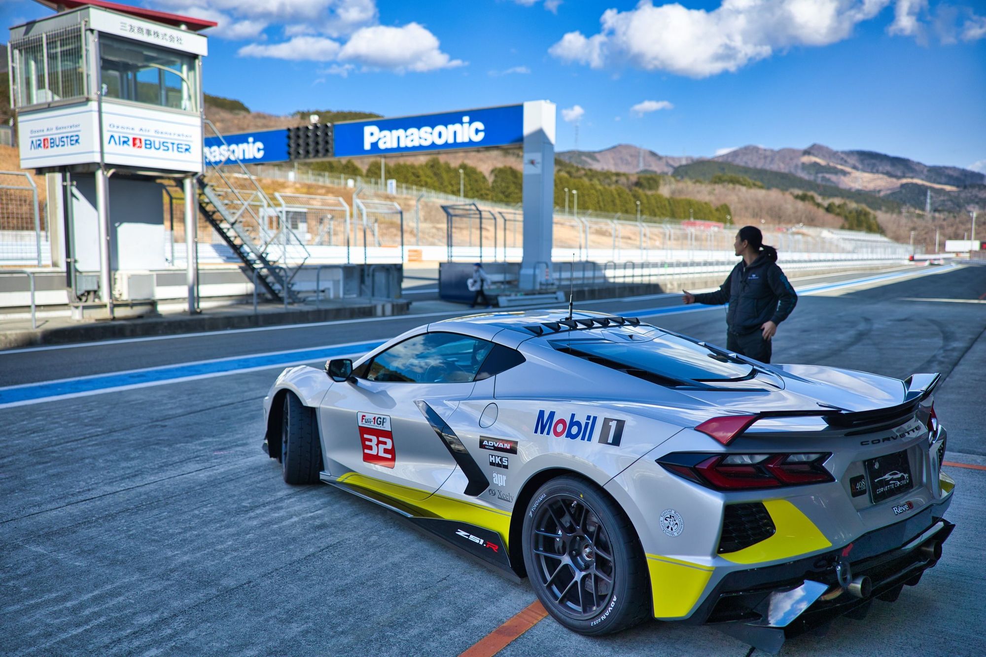

Man im sure some of the track Gurus will help out but for sure nothing to do with the wheels. something must be off , settings? traction etc i wish i knew, please share the info if you get down to the problem this way others dont have to deal with it. Here's a link to one of our clients in Japan taking on the track.

The wheels are perfect Carlos, he just didnt consider tire height when he selected his tire sizes.

@Carlos@mrrwheels Your wheels look great and it didn’t make sense to me that they would cause the problem. When I did my research, I never saw anyone mention the front/rear ratio needing to be the same as the stock sizes, and I didn’t think of it myself. Maybe add a comment to your webpage to inform buyers. You don’t have to dictate a size, but inform them of the ratio requirement, to keep the PTM happy.

Noted for sure and thanks again. send some pics buddy lol

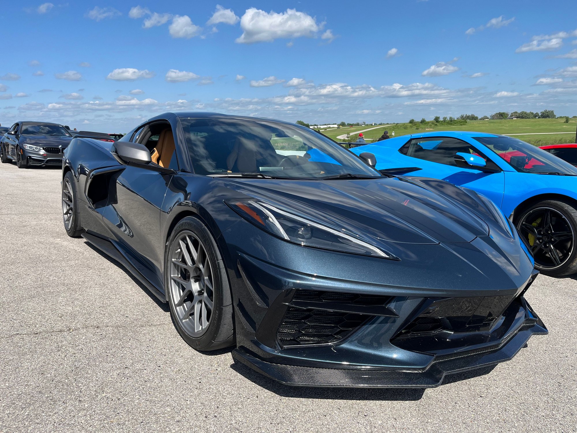

Here's the only pic I took yesterday. Thanks for the wheels Carlos!
