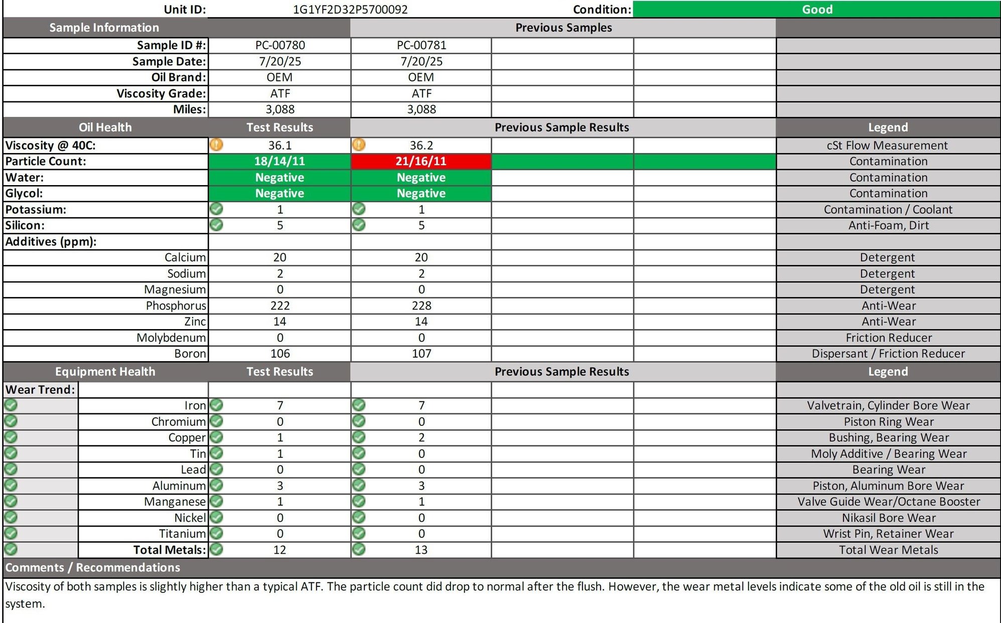

I changed my DCT oil and filter at 10,909 miles.
3,088 miles since the last fluid change one year ago at 7821 miles.
I ran the HSF procedure both times.
In addition, I changed the external filter one more time at 9410 miles.
Before changing the oil and filter and prior to running the HSF, I used a vacuum sample pump to withdraw an oil sample through the fill port. After discarding the used filter to install a new one and after running the HSF on this new filter, I took another oil sample before draining the unit.
Both the before and after samples were subjected to an oil analysis which included a particle count.
The particle count uses the ISO4406.99 reporting standard for fluid cleanliness.
The results listed in the report need to be converted into numbers that can be readily understandable. I will list them below.
Particle counts are listed on a per milliliter unit of volume.

Default Quick look
Looking at it quickly it seems the first sample has manny more smaller particles than the second. Similar next size and same of the next size. So it could be the filters are letting the smaller particles build up and that could be if it filtered too small it blind off the filter immediately.
Another idea is the smaller particles will or will not be found in the next sample. I wish they told you either % or in ppm. The real question is how good or bad is this? The only way I think you could know if it’s dirty fluid that is causing these problems is to have a sample from a tranny that went bad. Then you could compare to something.
I kinda think what we learned is the filter is probably a 10 micron filter.
am I missing anything?
Joe

Default One point particles are not metals
The particles they found are not normal metals they test for. If you look at the two columns they are listing the same metal counts. They say the particle count is outside or highest in red. Which is it and what is normal if it’s outside the range?
Can someone tell us what clutches are made of?
Joe
ps this is good stuff thank you!

Well it certainly shows that installing a new filter and running the HSF after reduces the particle count.
Makes me wonder what would have happened if you had just run car with the new filter and not run the HSF (since many DIYer's think they can skip it, its a relevant test):
1. sample before maintenance
2. change the filter, skip the HSF, run the car a little to circulate fluid, then take a sample.
It also makes me wonder what the results would be if the GM procedure is followed (since many/most do that):
2. run HSF - take another sample before changing the filter.
3. replace the filter, run the car a little bit to circulate the fluid, then take a sample.

Considering that at 11,000 miles I have changed the external filter many times, ran the HSF twice before and changed the fluid twice, one has to ask why any supplemental cleaning process would be necessary. Does this imply that the filtration process on its own is inadequate?
Regarding your questions about letting the car run to 'circulate the fluid', understand that under most conditions, there is relatively little oil flow through the unit and the filter. The valve body receives pressure, but there is no gross oil flow through it. Most of the internal parts are splash lubricated - just like a manual transmission. The input clutches receive application pressure to hold engagement, but again, there is no gross oil flow. Perhaps you remember a method I explained on how to maximize oil flow through the external filter with the car stationary? The programming maximizes oil flow to the input clutches and then through the filter when it detects slippage. Slippage occurs during engagement from a stand still and when using the launch control. There is also minor slippage during shifts. Oil flow is controlled by a variable orifice valve that is under ECM control. So, the processes you describe will not work.
Of greater interest to me is what the before and after would look like running the HSF on the original filter on a car with 7500 miles and with no prior service - just like GM wants it done. We need a few volunteers!
