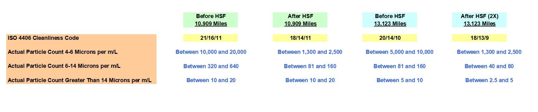

What follows are results from the second round of hydraulic system flushing and oil analysis after 2214 miles of normal driving.
The previous HSF was carried out in July of 2025 - 2214 miles prior. The vehicle mileage currently is 13,123.
The same procedure was carried out both times with the exception that I ran the HSF twice - back to back this last time and I had changed the fluid in July.
The car was run to warm the transmission fluid to about 150 F degrees, at which time, the car was shut down and an oil sample was drawn out of the fluid level check port. The external filter was removed and replaced with a new OEM GM ACDelco filter. The HSF was then run. When complete, the car was shut down and a second oil sample was taken again from the level check port. The external filter was again removed and replaced with a new filter.
It should be noteworthy that when the fluid was changed at the earlier HSF in July, about 9.5 quarts were drained from the unit. So, while the transmission fluid capacity is 12.57 quarts, about 3 quarts remained in the unit.
This converts the ISO 4406 particle count numbers into particle size and number found in 1 mL of sampled fluid.
The latest report shown above appears on the right under 13,123 miles.
The first report shown below appears on the left under 10,909 miles.
This is the lab report from the first HSF in July of 2025. Prior to this, the HSF was run and the fluid changed at 3088 miles prior. In addition, the filter was again changed at 1499 miles prior to this report.

So in both cases, the column labeled previous sample is before the HSF, correct? When you send the samples in at the same time they know which is which somehow?

The columns labeled previous sample, in this case, are empty. For any given vehicle, sample results are populated in chronological order from left to right with the most recent populating the left most column. Successively older samples appear to the right. In each of these two reports, the before sample is on the right and the after HSF on the left. Does this make sense?
Samples were carefully labeled and the lab knew what I was doing. An explanation of what the samples represented together with their identifying labels was given to the lab. In addition, I recorded all of this and the sample ID #s appear on the report.

So this shows that the flush does appear to push fluid to the filter and the filter is working... all of which would make sense since gm put this in place and of course has run extensive testing for reliability.

In the service manual, it says the HSF "executes a procedure in the TCM software to actuate the solenoids in a specific manner to flush debris from the system". The normal fluid path is through the pump, then the filter, and then the lines and valves, isn't it? So how does the "debris laden" fluid flushed from the valves make it way back to the filter? Is it dumped into the pan first, or is there a path by which it can re-enter below (in front of) the pump without first being dumped into the pan. Either way, I think it get filtered out.

Isn't the GM procedure to run the HSF before changing the filter?
Am I reading this right that you ran it after changing the filter, then changed it a second time?
