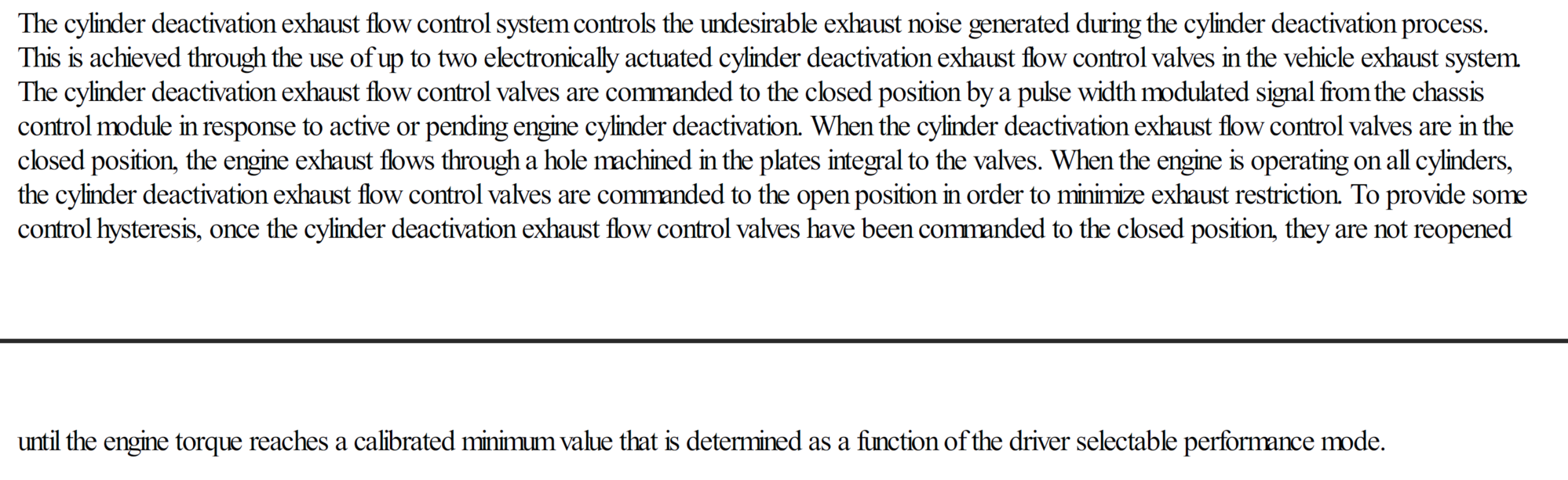

Keep in mind that the main purpose (if not the only purpose) of the AFM valves is to make the exhaust sound less objectionable when the engine enters AFM mode. Deleting the AFM valves will not prevent the engine from entering AFM mode.
After a few weeks of research after getting the car, I believe it is the only purpose yes. People report an unpleasant exhaust note and droning with loud catbacks/catless pipes in V4 mode. However, without simulators, you will get a MIL despite it just being for sound purposes - guess if they were to fail closed the V8 might have a hard time getting exhaust gases out of the system as a whole, or GM just likes having any and everything on this car throw a MIL...
And here it is right from the Service Manual.
