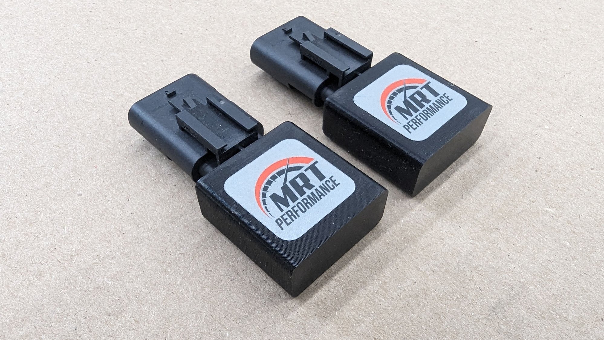

Track mode , Z mode, My mode, doesn't matter the valves still close around 2k rpm's when cruising I've got data log videos to prove it. The only way to keep them open all the time is unhook the NPP valve when open and put on a simulator. I have simulators for $75 a pair.

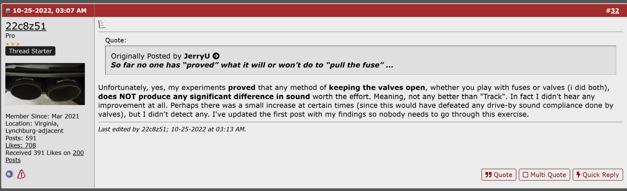

With the engine/sound set to Track or Sport, the valves are open almost all the time. It is true that they close at certain times with low acceleration and RPM to meet Federal Bypass Standards. The question is, if force open all the time will there be any perceived difference worth the effort. Someone in the thread at the link below tried that, and decided it did not make much, if any difference. You can skip to his conclusion in post 24, or read the whole thread.
https://www.corvetteforum.com/forums...ispreloading=1

Some have said that. I don't think you will find a post where I said that. They even show a video of working. What I have said is the even it if it works, the difference in sound between running with engine sound set to Track and forcing the valves open all the time is not much if any from a perception point of view. The valves do close (around 2 k when cruising according to post above) to meet Federal Bypass Standards, and they do close in AFM mode. This is the thread where a person forced the valves open all the time - and concluded it was not worth the effort.

I agree, the only way to keep the NPP valves open all the time is by using the plug in simulators. That is the only way to get maximum sound all the time. Track setting does not keep the NPP valves open all the time... not even close and even with the valves open the NPP system is still too quiet. I have the AWE touring cat back and use the plug in simulators for the AFM wire harness . The AWE touring has noticeably more sound than a NPP factory system in its loudest mode and has no AFM or NPP valves.
