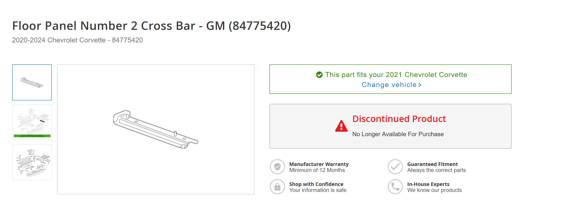

Hi there,
Can anyone tell me the part number of the area circled and if it is structural? (I assume so), I have looked online but can’t find the precise part.

Is it the floor panel number 2 cross bar? #2 in parts diagram?

Thank you. I think it might be too. However, on the underside of the part, there are four screw holes and two tie-down holes that are not shown here. Assuming it is that part, how difficult / costly would it be to replace?

Structural and yes not an easy replacement. That part and the pans will be bonded together and held with flow screws.

I think you may have to ask a dealer about this. I checked a couple of parts sites and they said discontinued, so no price. They usually are replaced with a new part number, but not this time.

Thanks - I can find the part between $45 and 60, some still have in stock. It is more about an idea of the labour cost.

Are you rebuilding a wrecked one? What's the reason for replacing it? The part is cheap but getting it is another story only a certified shop in the Cadillac network will be able to order it unless you find one on eBay. After looking at it closer it's very possible you can't get that out without removing the floor pans or possiblity the side rail. There's a lot of time into replacing that piece and it will probably be hard to find a shop to do it.

Definitely not an easy replacement. The unfortunate part is it's really hard to separate the panel bond from the panels. Odds are you will also wreck the floor pans in the process of separating them from the aluminum structure. Believe me I've spent hours trying to salvage parts that can't be bought due to the restrictions and it's really frustrating only to crack one after several hours.

Absolute BS. There is no authorized shop that will replace that for that amount. That part is resistance welded, panel bonded, and sandwiched between composite floor pans. The labor to replace that piece is very high. Sounds like the Turo renter is just trying to get some extra cash from previous damage.
