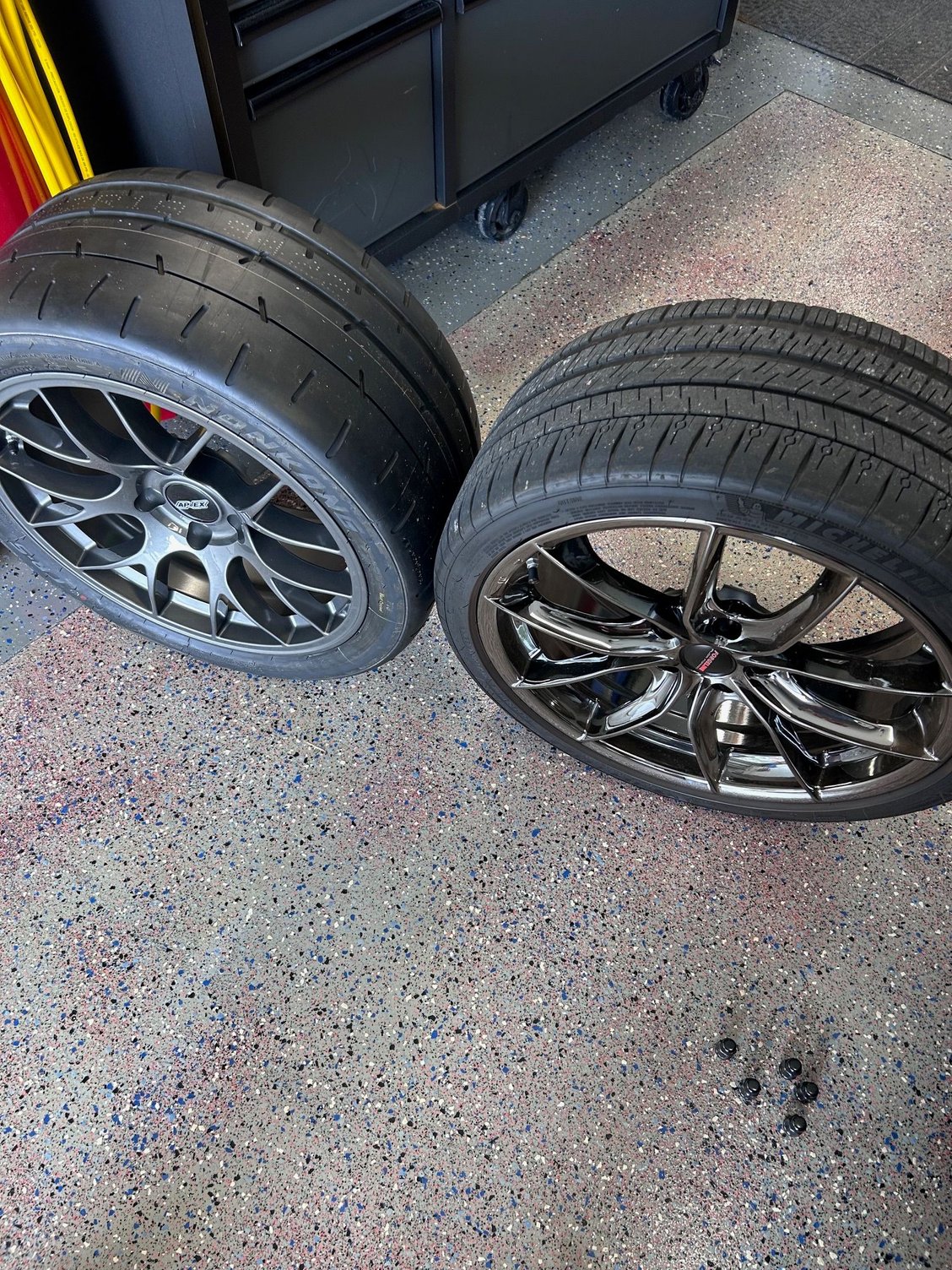

Just did a decrease in wheel size to accommodate 275's on the front 18"x 9.5" fronts and 19"x11" on the rears. Better choice of rubber with a little more side wall
