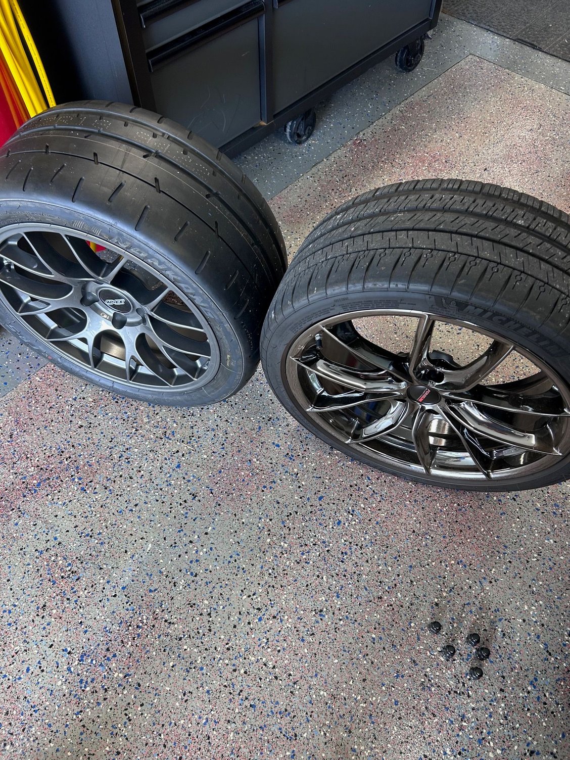

I have been running the Nankang CRS V1 due to shipping issues of the V2 and have great results. Just make sure you start out with your air pressure down and monitor until they heat up. I also switch over to APEX wheels for the track and autocross running 18 x 9.5 in the front and 19 x 11 rear to open up more tire possibilities. The 275 on the front sure improved the under-steer.

I have been running the Nankang CRS V1 due to shipping issues of the V2 and have great results. Just make sure you start out with your air pressure down and monitor until they heat up. I also switch over to APEX wheels for the track and autocross running 18 x 9.5 in the front and 19 x 11 rear to open up more tire possibilities. The 275 on the front sure improved the over-steer.
You mean wider front tires improved (reduced) the understeer instead?
