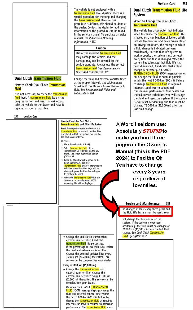

Posted these Pics in another thread to emphasize IMO how foolish it was for GM to eliminate the Maintenance Table that had been my 1st 6 Vette Owner's Manual including my 2020 C8!
I clearly says DCT fluid must be changed 45,000 miles OR minimum every 3 years in the footnote.
Can forget my info in Red & Purple suggesting how GM could improve the way the footnotes are worded to say WHY there are some requirements. Like the every 3 years minimum for DCT Fluid AND for the engine oil at least every 12 months.
This is what you have to do to find the DCT fluid change requirement in the 2024 C8 Owner's Manual that included my E-Ray. If you don't catch the words on page 317 you would NOT know it is required to change DCT Fluid every 3 years minimum regardless of miles. And with all these words NO indication of why!
GM should make their Owner's Manual writers take the web course I just did as required for volunteers like myself who write our tech society standards for Requirements for welding airplanes, bridges and many other critical items!
