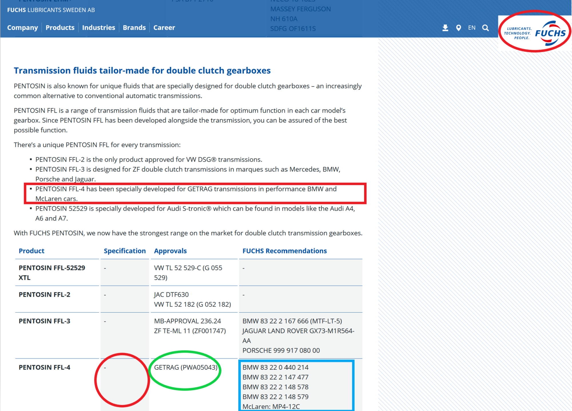

Originally Posted by EvanD
Okay so nothing saying made by Fuchs or is marked FFL4. Got it.
I’m not arguing it can’t be used.
Maybe you missed the FFL-4 on the front label of the Valvoline DCT bottle. Not real hard to miss.

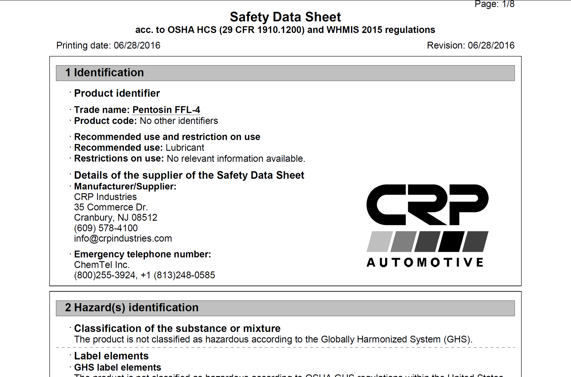

On the front of the bottle, in the fine (er) print, it lists some recommended uses. It is "recommended for....FFL-4" by Valvoline. On the back of the bottle it says "Manufactured by Valvoline Global Operations 100 Valvoline Way, Lexington Kentucky 40509", and "Made in U.S.A. of foreign and domestic materials, (C) Valvoline Global Operations. Nothing about "Fuchs". The Valvoline Product Data Sheet does not say its made by Fuchs. The Valvoline Safety Data Sheet does not say its made by Fuchs.
For comparison, the Safety Data Sheet(s) for ACDelco DCTF FFL-4 do indicate that the manufacturer is Fuchs.
I'm not saying it can't be used either.

Thanks Andy. As you may suspect my point is that people post wrong information. What's worse is when they are called out they argue, "move the goal post", disappear or say they "misspoke". If I'm wrong I just say I was wrong.

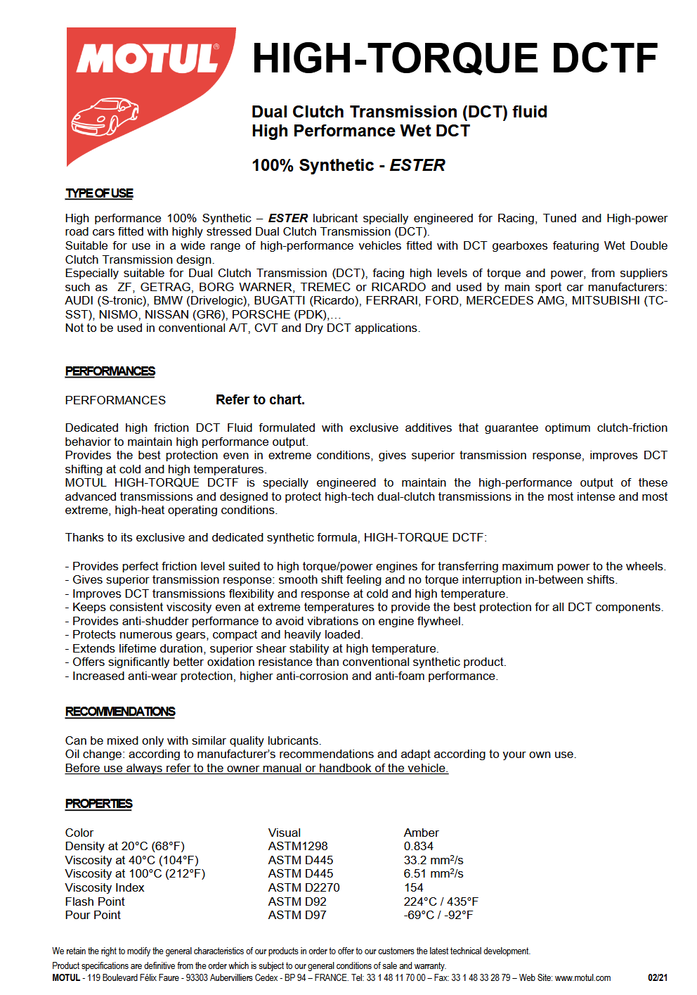

Originally Posted by gsvette
There are plenty of excellent lubricants outside the "recommendations" of GM.
I was talking to my buddy today from whom I bought my McLaren 650S, and he just had the DCT serviced in his 2023 C8Z @ 20K miles with Motul High-Torque DCTF. Gave his Chevy dealer 12-quarts of it and he said they didn't bat an eye. That's what he runs in his 765LT, and Motul specifically recommends it for Tremec DCT. It is a 100% pure synthetic Ester based lubricant and he says it's the best FFL-4 type DCT fluid available for any use case.
$20/quart and plenty in stock @ Summit Racing makes Delco DCT fluid pricing look even more absurd. https://www.summitracing.com/parts/mtl-110440
I use Motul in my motorcycles, and if I was going to use a DCT fluid for the type of mileage intervals GM recommends, the Motul DCTF would be it.
https://www.motul.com/en-US/products...GH+TORQUE+DCTF
My McLaren buddy just sent me this. Apparently Emelia found the OEM Delco DCT fluid lacking. "......as well as whether Chevrolet took any of that same knowledge into consideration during R&D for the forthcoming Z06 and electrified Corvette trims". I can almost guarantee GM did not. In terms of companies I've dealt with in my career, GM is among the most myopic and afflicted with NIH syndrome. Not Invented Here Syndrome
https://www.hotcars.com/emelia-hartf...tul-dct-fluid/
GM did not invent the Fuchs Titan FFL-4 fluid that Tremec recommends for the C8 transmission.
The Motul Product Finder recommends "HIGH-TORQUE DCTF Dual Clutch Transmission (DCT) fluid High Performance Wet DCT" for the C8. The Product Data Sheet for that recommended product mentions a lot of car makers and transmission suppliers (including TREMEC) but does not mention GM or Chevrolet. It recommends it for OEM McClarin, Pentosin FFL-4, and says it can be mixed with Pentosin FFL-4. Not saying there is any issue with it - its yet another option. Although the discussion seems to evolved from "all DCT FFL-4 fluids are equal" to "some DCT fluids are more equal than others". I'm not disagreeing.
The referenced article is dated August 2022, before the Z06 was completed and released. And the question about "whether Chevrolet took any of that same knowledge into consideration" was not about the transmission fluid, it was about internal design features necessary to handle increased torque. When asked whether any of Phoenix's data helped Chevrolet's own engineers prepare the stock transaxle to handle so much more power from the factory, "Hartford needed to choose her words carefully to avoid revealing any of Chevy's top secrets too soon", but answered."..........I can confirm that the transmission design of the Z06 is a little bit different...........The clutches were, in their words, welded a little bit different because obviously, you have to rev higher. And they extended the sump a little bit on the new Z06 transmission so that you no longer need to add the additional two quarts........That's the whole thing on the Stingray..........f you're gonna go track it, add additional two quarts. With the new Z06, they've extended the sump so you no longer need to do that."
The statement about "extending the sump" is a bit ambiguous because it makes it (in my opinon) sound like they increased the capacity of the sump to hold the additional 2 quarts. That is not what happened. Rather, there were case and pan changes that hold the fluid at the intake better during high g maneuvers. Here is Josh Holder's explanation of the Z06 and Stingray case changes:
"Conti: Are the two additional quarts (sic) already there?
Josh Holder: It’s not really the case (meaning no). The case is, literally, changed for ’24. We did it because the Z06 necessitated a change in the lube system. Where we keep all the critical oil in a car on a Z06 that has so much lateral capability, was super important. So knowing that we needed to change the case and update the lub system for the Z06, in 24 model year, actually very late in 23 as it turns out, we moved all Corvettes to the same differential, err, the same transmission housing that the Z06 has. And when we did that you no longer need to add the additional 2 liters of oil. That really was a way to keep (the) lubs system healthy, lubrication where it needed to be, but it was overkill, it wasn’t kind of the way we would have done it starting over.
Conti: Is the pick up point different – is that what it is?
Josh Holder: The pick up point is not really different. What is different besides the the size and shape of the case itself, which can hold more oil near the pick up point. But there’s baffles inside the transmission that under high G loading keep the oil near the pick up point, which is the whole goal of (the) lube system. So that’s the benefit that all Corvette receive in 2024 models.
Conti: what if a guy (sic) did put the two additional quarts (sic) in there?
Josh Holder: In the 2024 transmission? Conti: yes. Josh: I…You could do it, actually you might risk some expulsion through the vent tube. It would be a wasted effort. So, I would not recommend doing it in a 2024. And honestly, when we recommended it in 2020 it was for a really extreme scenario, and in hindsight, I’m not sure we would’ve made the same recommendation. Its not easy to do for those that have done it themselves, a I’ve done it myself. Its not super easy. And so, we’re really glad that we got to take that revised lube system strategy to all Corvettes. And now anybody that wants to tracks their car or don’t track their car doesn’t have to worry about whether they have to add two liters or not and am I going to be that person that drives so extreme, maybe I need two liters, maybe I don’t. Takes that question out of it.

Interesting that Motul calls FFL-4 a specification.
I noticed that. Its interesting because Pentosin/Fuchs never claim it as a specification - its more like the name of a product, like Mobil 1 ESP X3 or Mobil 1 ESP X4, or Dexron 1, Dexron 2. X3, X4, 1, 2 are names of the product, distinguishing different product formulations. As noted there is a difference between recommendation, approvals, and specifications met. In the attached page from Fuchs, it claims no specification for the Pentosin FFL-4 product (which is now renamed Fuch Titan FFL-4 but otherwise the same), one approval Getrag, and a list of recommended applications. And Pentosin/Fuchs claims it was "specially developed for GETRAG transmissions in performance BMW and McLaren cars." Not GM specific.
Pentosin FFL-4 predates the C8 by quite a bit - I do not know how far back, but the attached safety data sheet about Pentosin FFL-4 has an issue date of June 2016, well before the C8.

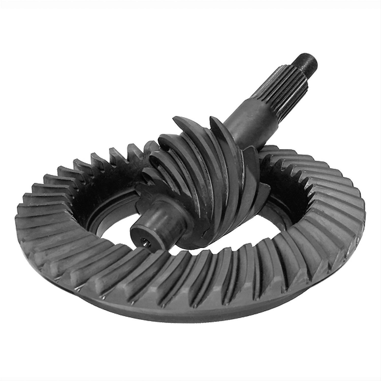

The ring and pinion in the TR9080 are spiral cut gears vs the hypoid gears in a traditional differential. This eliminates the sliding contact of the hypoid gears which usually presents a challenge of providing high sliding contact pressure lubrication while still providing the friction required for synchronizer rings and wet clutches to work. The lubrication requirements of the TR9080 R&P probably isn't that much more severe than the other gears in the DCT.
I'm also wary of any fluid that claims to be a universal fluid. Valvoline claims to be able to be used in applications that require FFL-2 fluid and FL-4 fluid. However if you do a search for "can FFL-4 fluid be used to replace FFL-2 transmission fluid" the answer is generally no.

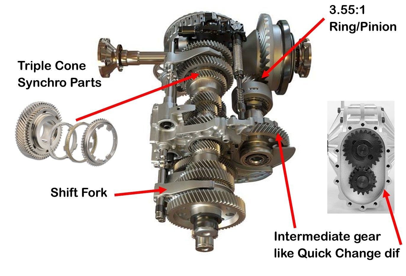

I had to replace the Dif fluid in my Street Rod rear end as the synthetic lub used was not what Currie, who built the narrowed rear, recommended for the Posi they included. They specified the friction modifier I was to add with non-synthetic gear lub. Solved my chatter issue making shape turns. So it's not just the gears. Lots going on in a DCT!
Yep we can guess what is similar but until proven I'll stick with the GM Spec'd product.
BTW, probably a reason GM used a 3.55:1 pinion ring with an intermediate gear to get 5.17:1 final ratio! Versus this 5.28:1 shown for a "9 inch Ford" rear below!
