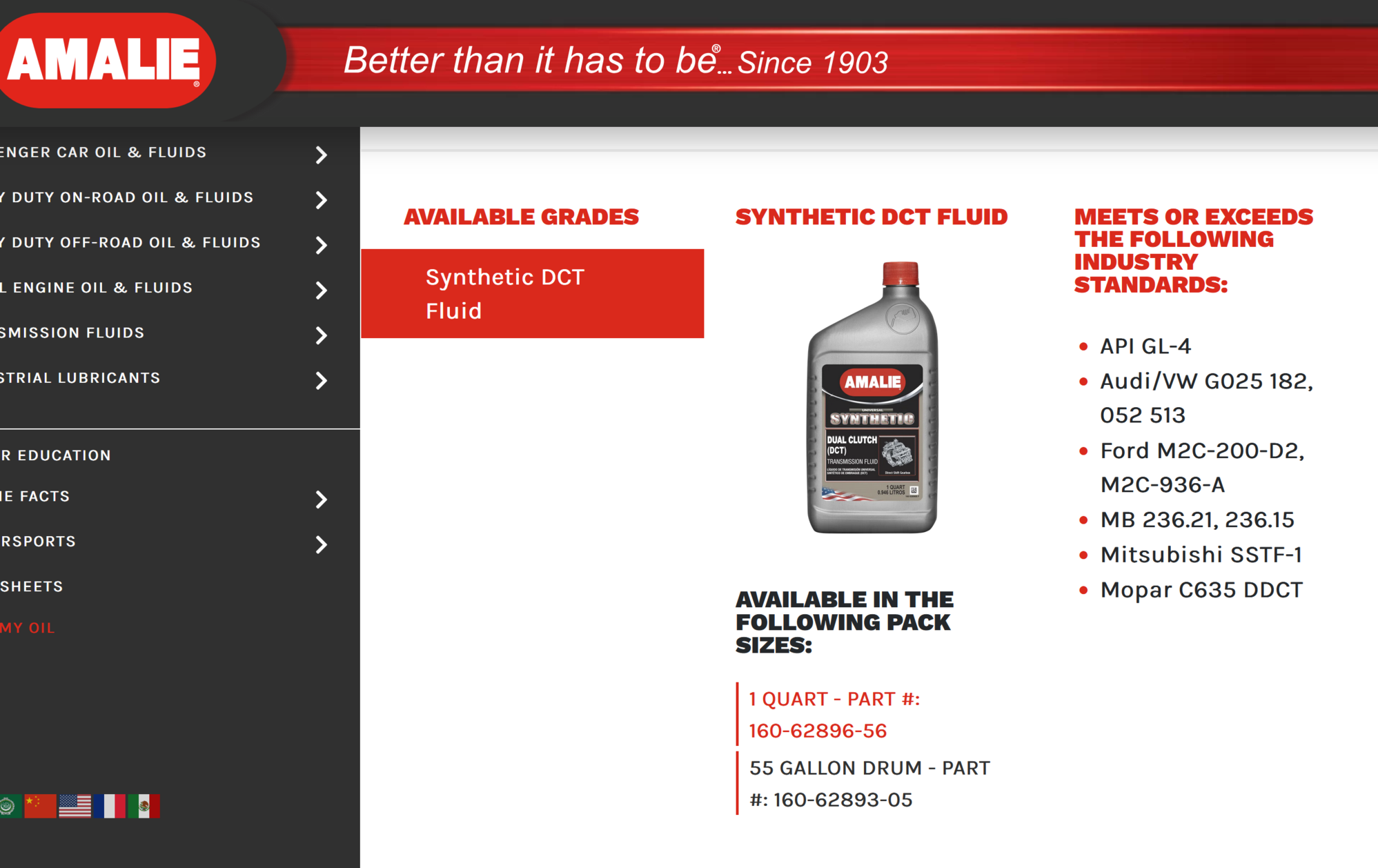

And then there is the Amalie Dual Clutch Transmission Fluid. I can’t find any mention of FFL-4 in its data, but if you use their product finder it will specifically recommend their Dual Clutch Transmission Fluid specifically for the C8. It says its made in USA too.

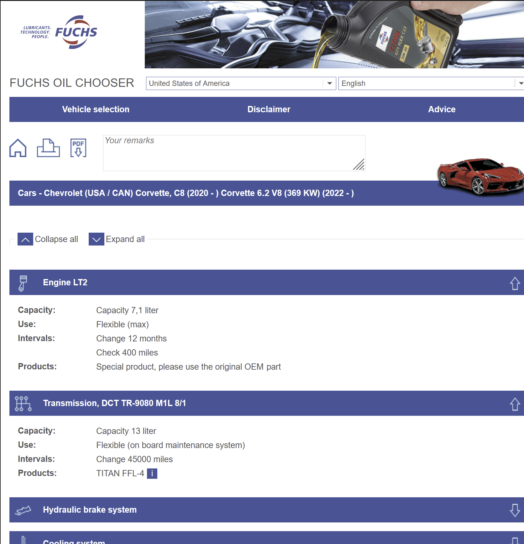

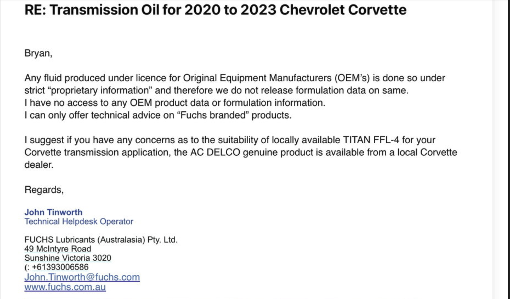

And let’s not forget the Fuchs Titan FFL-4 product. If you use the Fuchs product finder it will recommend Fuch Titan FFL-4 (no EG in the name) specifically for the C8.

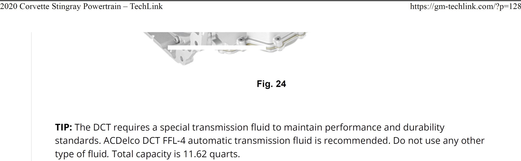

And, in a 2020 tech link article, GM recommends ACDelco DCT FFL-4 (not a typo on my part, but the name on the bottle is DCTF FFL-4). We know from PDS and other sources that Fuchs makes the Delco DCTF FFL-4, but is it the same formulation as the Fuchs product? Fuchs was contacted by a forum member and asked that question, but declined to answer (response attached). But I ran across an Australian SDS for the Delco product which indicates its made by Fuchs. It has an other names sections and there we find Pentosin EG FFL-4 listed.
So if this is correct, the Pentosin EG FFL-4, Pentosin FFL-4, Fuchs Titan FFL-4, Fuch Titan EG FFL-4 and ACDelco DCTF FFL-4 are the same.

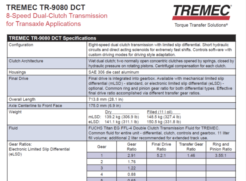

One more thing – what does Tremec recommend? In the Tremec flyer, we find Fuchs Titan EG FFL-4, which we have established is the same as Fuchs Titan FFL-4, etc.
Notable to me is that both GM and Tremec recommend a specific product by name.

FUCHS PRODUCT FINDER:

FUCHS RESPONSE - FUCHS TITAN EG FFL-4 AND FUCHS TITAN FFL-4 ARE THE SAME SPEC:

GM 2020 TECHLINK ARTICLE INDICATES ACDELCO DCT FFL-4:

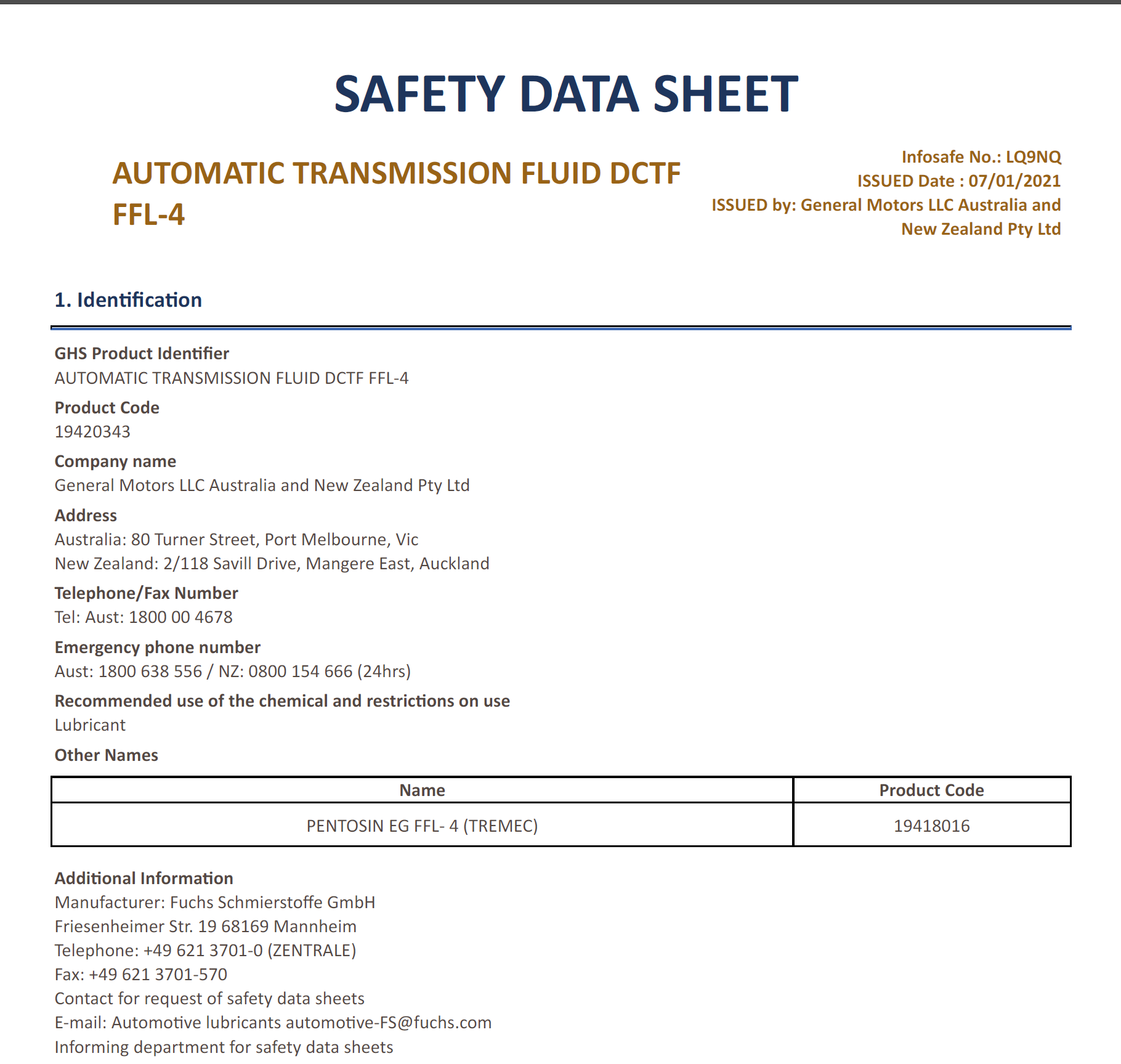

FUCHS DECLINES TO COMMENT ON FORMULATION OF DELCO DCTF FFL-4:
SAFETY DATA SHEET FOR DELCO DCTF FF-L 4 LIST PENTOSIN IN "OTHER NAMES" SECTION;
TREMEC RECOMMEND FUCH TITAN EG FFL-4:

And that is the issue. How do I know that Amalie Dual Clutch Transmission Fluid meets GMs or TREMECs requirements for use in the C8 transmnission? The Amalie Product Finder recommends it use for the C8. Based on what? If I were to use it, it would be because the Amalie product finder recommended it - I would have no other basis. It would be an assumption on my part that Amalie did their due diligence and determined that their product meets the GM requirements for the C8 transmission.

But Amalie and Amsoil also recommend their product for use in the C8. I posted their product finder results showing that. Would you be comfortable using them or recommending them to others?

I've never defended GMs maintenance requirements - only stated them.
The Maserati MC-20 uses the same bespoke transmission. But their maintenance requirements differ.
They don't have DCT external canister filter change at 7500, but they do at 9320, the first time and every time - every 9320 - or yearly (never 22,500 miles).
They requires a transmission fluid change at 37280 miles or every 4 years.
And they require a replacement of the internal filter 8 years or 74560 miles.
Masertti actually list a "Recommended Fluid: Fuchs Titan FFL-4". In this case it is recommended without further caveats.
I'm not defending their maintenance requirements either.
GM and Maserati both require a change of the filter and the fluid every 24 hours of track use.

Did I miss the answer to "I’ll bite, where does it say made by Fuchs and where does Valvoline say it’s FFL-4?"?
Originally Posted by ArizonaZ06
Agree 100%. Been using 2 years, paid 7.58qt.
Valvoline 888705 produced by Fuchs just like AC Delco without that private label !!
Valvoline DCT labeled and bottled under FFL-4 and is a go to for the 9080 Tremec for the MC20 Maserati and C8 enthusiasts. A number of members have successfully and extensively used the Valvoline DCT. Been using now on my C8 for over 10K and noticed smoother shifting since moving from the private labeled AC Delco DCT. Fuchs as standard practice declines oem proprietary information on labeled products.

Okay so nothing saying made by Fuchs or is marked FFL4. Got it.
I’m not arguing it can’t be used.

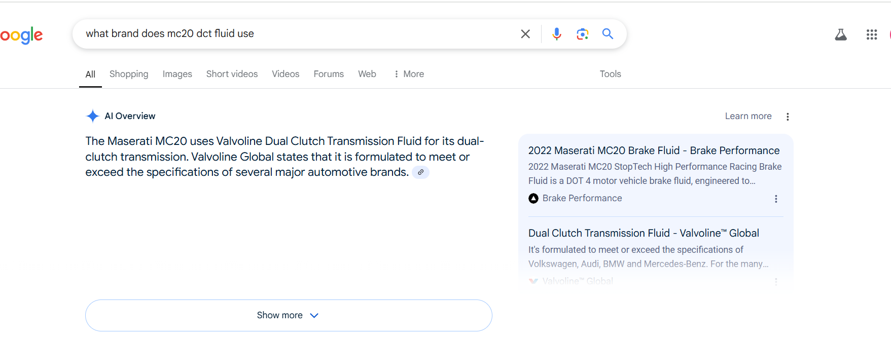

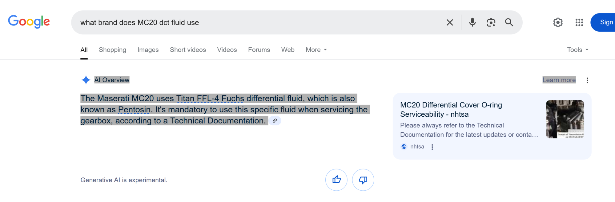

1. Fuchs does in fact acknowledge that they make the ACDelco product - what they will not do is disclose any data on the forumulation of their client product.
2. The Maserati MC20 Owners Manual recommends Fuchs Titan FFL-4. The Google AI answer in post 37, to the question appears to be an incorrect AI result - and I was also unable to reproduce it. When one gets an AI answer, one should always look at the sources provided with the AI answer to make sure its valid. When I searched using Google (I normally do not use Google), the AI answer that I got, using exactly the same question, was this: "AI Overview The Maserati MC20 uses Titan FFL-4 Fuchs differential fluid, which is also known as Pentosin. It's mandatory to use this specific fluid when servicing the gearbox, according to a Technical Documentation." However, I actually looked at the source for the AI answer - and it is very credible.
https://static.nhtsa.gov/odi/tsbs/20...12116-0001.pdf
It appears to be a clip from a Maserati Service Manual - and uses unambiguous wording - its not a recommendation - its "mandatory: "Whenever the gearbox is replaced or serviced, it is mandatory to use the specified differential fluid listed in TechDocs (Titan FFL-4 Fuchs, formerly Pentosin), which is readily available through local commercial channels."
3. In its product data sheet, Valvoline list, under recommended applications, "FFL-4". This does not mean it is is made by Fuchs. It could be, but there is no evidence of that. Someone could just contact Valvoline and ask them who makes it.

There are plenty of excellent lubricants outside the "recommendations" of GM.
I was talking to my buddy today from whom I bought my McLaren 650S, and he just had the DCT serviced in his 2023 C8Z @ 20K miles with Motul High-Torque DCTF. Gave his Chevy dealer 12-quarts of it and he said they didn't bat an eye. That's what he runs in his 765LT, and Motul specifically recommends it for Tremec DCT. It is a 100% pure synthetic Ester based lubricant and he says it's the best FFL-4 type DCT fluid available for any use case.
$20/quart and plenty in stock @ Summit Racing makes Delco DCT fluid pricing look even more absurd. https://www.summitracing.com/parts/mtl-110440
I use Motul in my motorcycles, and if I was going to use a DCT fluid for the type of mileage intervals GM recommends, the Motul DCTF would be it.
https://www.motul.com/en-US/products...GH+TORQUE+DCTF
