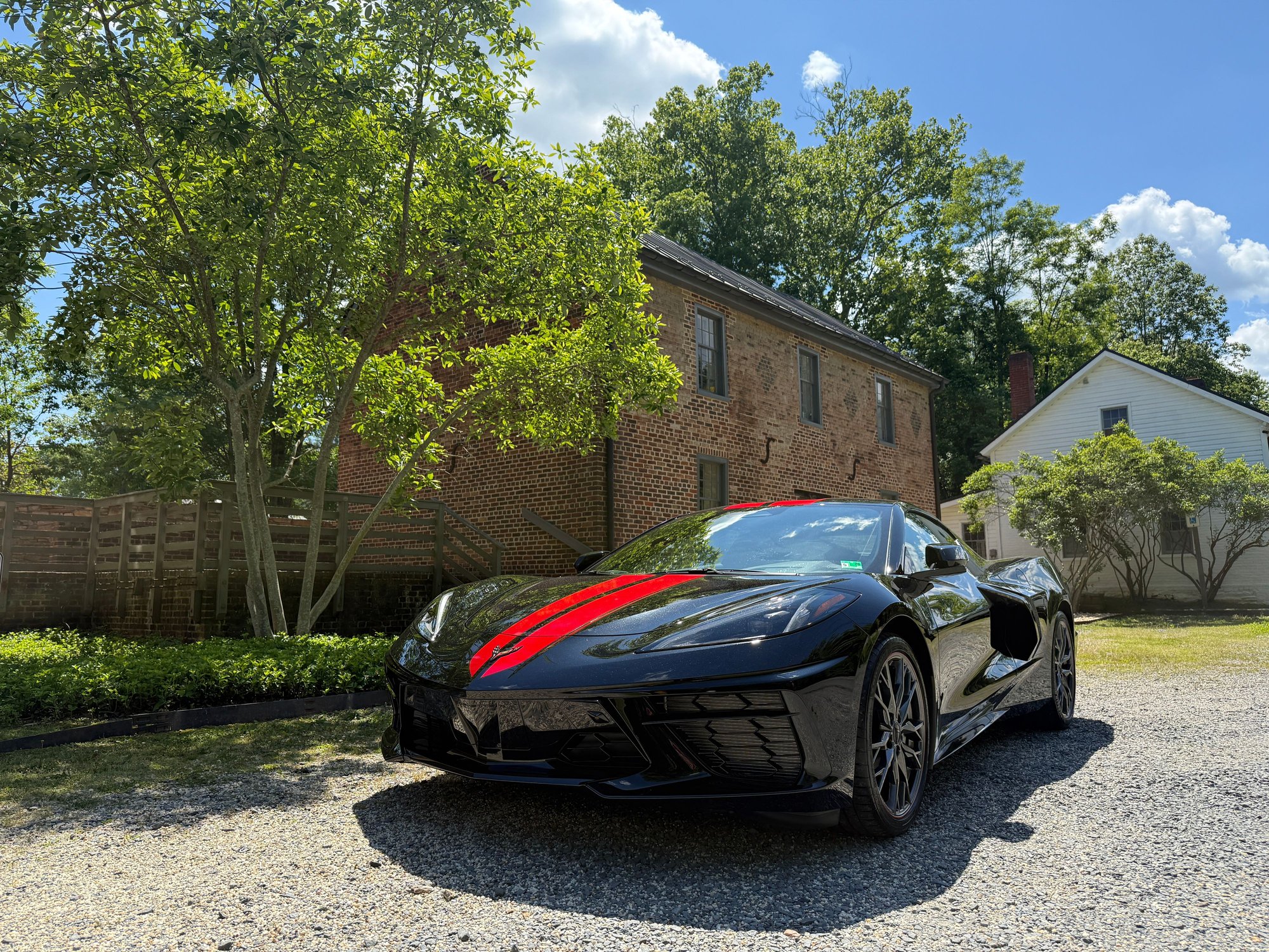

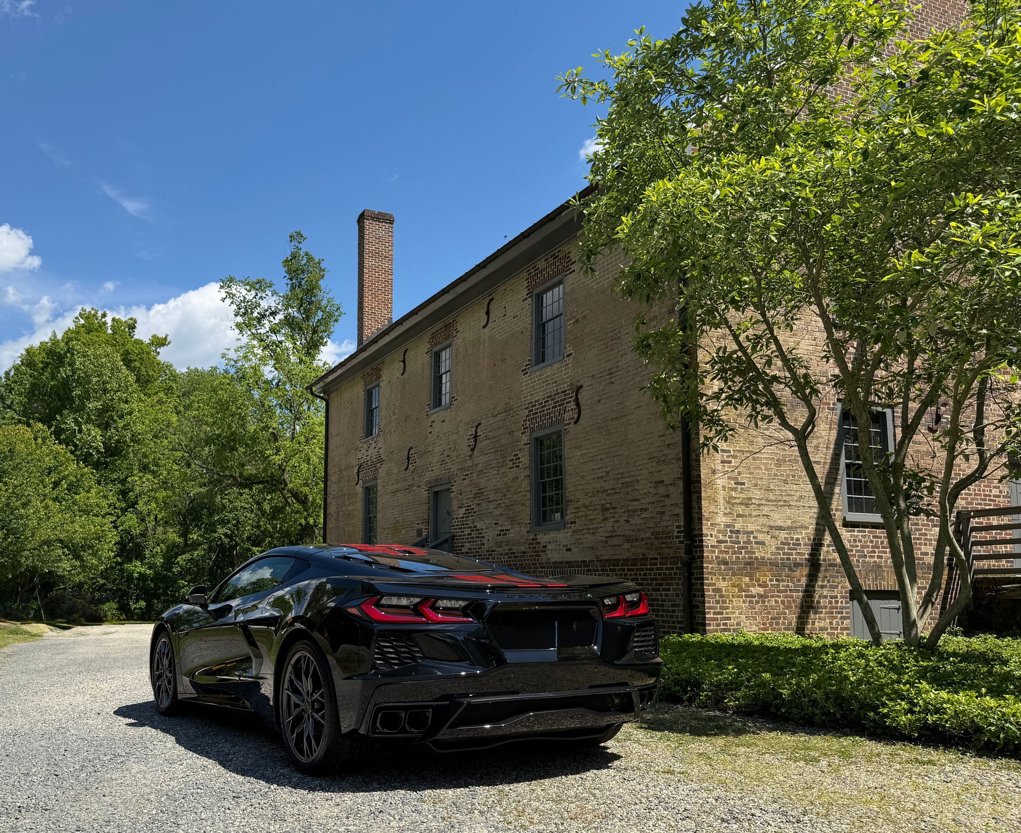

Default Gremlins all Sorted
Dealership finally figured out what was draining my battery and not letting me enjoy my brand new car. I was initially having an issue where the front hood would pop up on its own when I returned back to my car and got in. Was getting a notice on the dash that my hood was open. Then next morning battery would be dead. The hood button on the door was actually stuck pressed and the signal to pop hood was constantly being fired thus drain on battery. I got a call today that they figured it out and was finally able to get some miles in on the country roads in Virginia.
