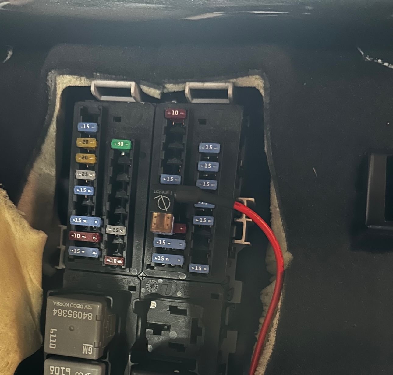

I'm trying to find switched power in either fuse box. Has anyone successfully located a fused that has switched power? Doesn't seem like it should be that hard, but I have come up empty so far.

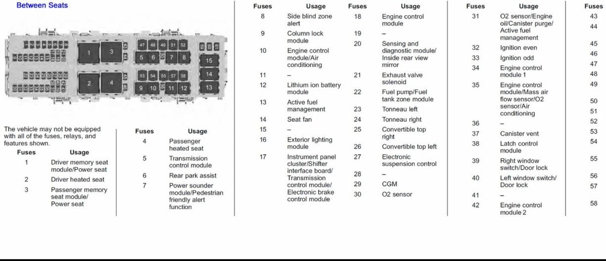

The rear fuse panel behind the waterfall. F14 I believe. Been a long time. Test that with a light for keyed. I have an add a fuse there.

That said, you can sign up for AC Delco TDS subscription of the service manuals, $22 for 3 days. They have the wiring diagrams.

The #50 fuse in the fuse box behind the glove compartment is switched power on my 2020. It is the fuse for the accessory outlet by the glove compartment and uses a 15 amp MCASE fuse.
Is it switched instantly or does it power down a short time after the ignition is off?
Old Jun 3, 2025 | 11:41 AM
RKCRLR's Avatar
RKCRLR
Joined: Aug 2016
Posts: 12,803
Likes: 10,221
From: Garden Valley CA
It goes off once the driver's door is opened after the engine has been shut off (as I remember). A nuance is that for some reason the power is momentarily interrupted when you open the driver's door even with the engine running.
