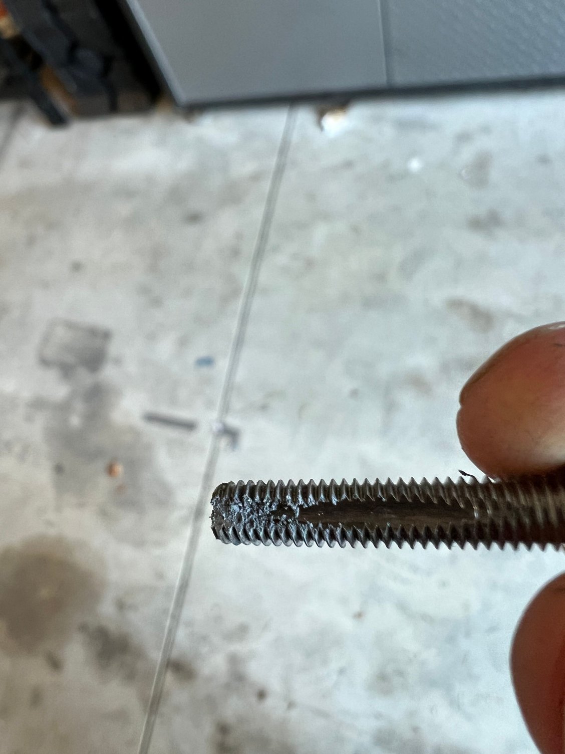

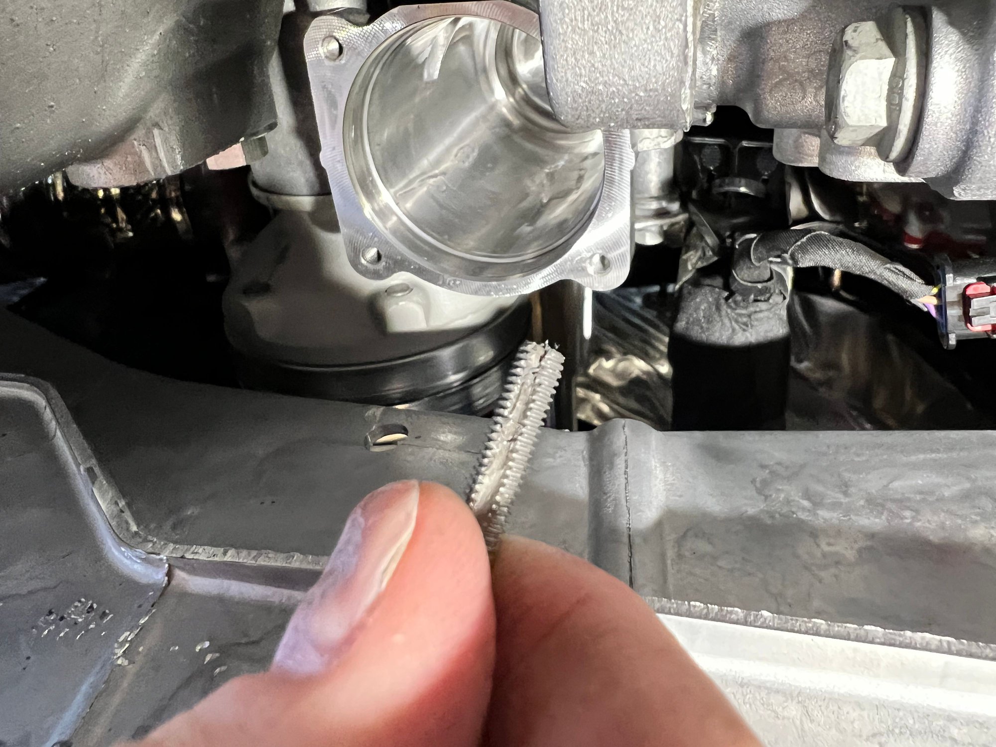

DCT canister filter calls for chasing the threads but there arent any m5 .8 chasers on the market I could find. After watching a few YT videos, I made my own chaser by cutting a bolt across the threads. Changed my dct filter this past weekend and the homemade chaser worked great. Got a lot of thread loctite out. Highly recommended

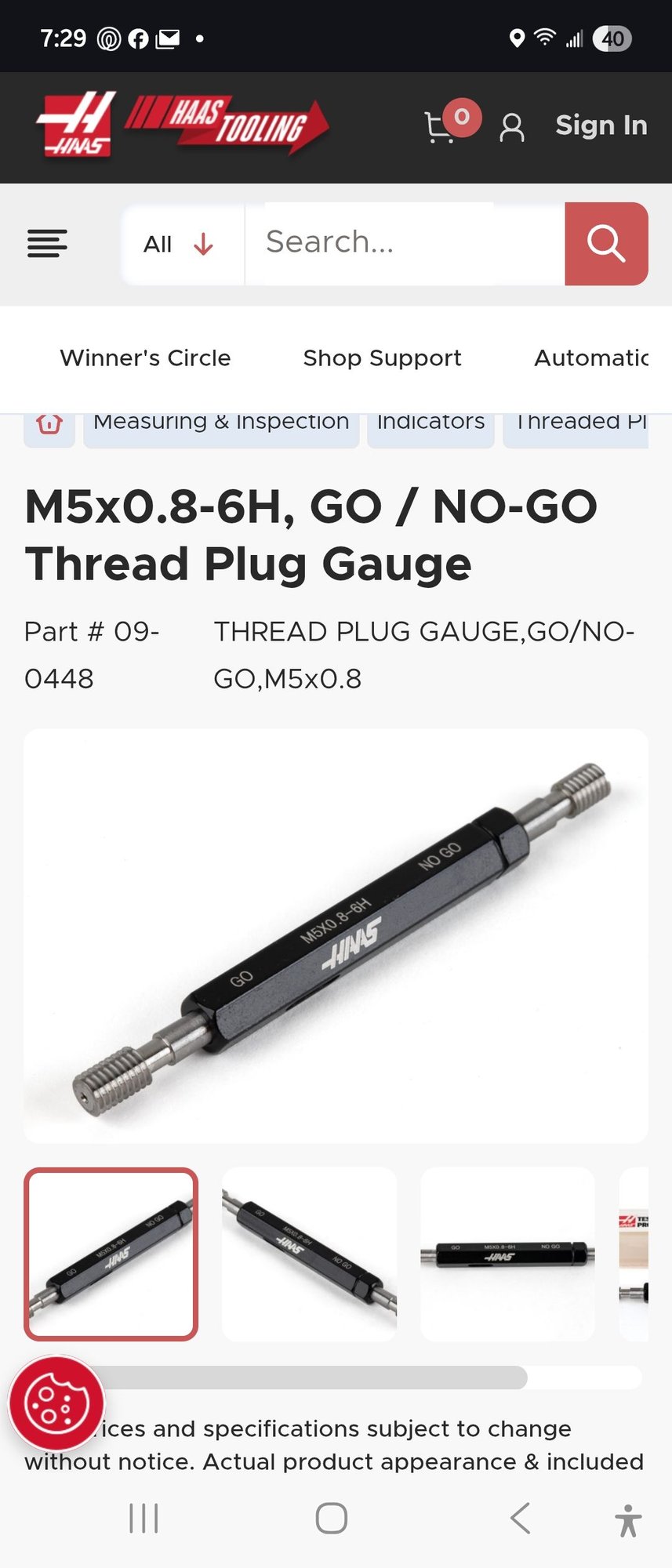

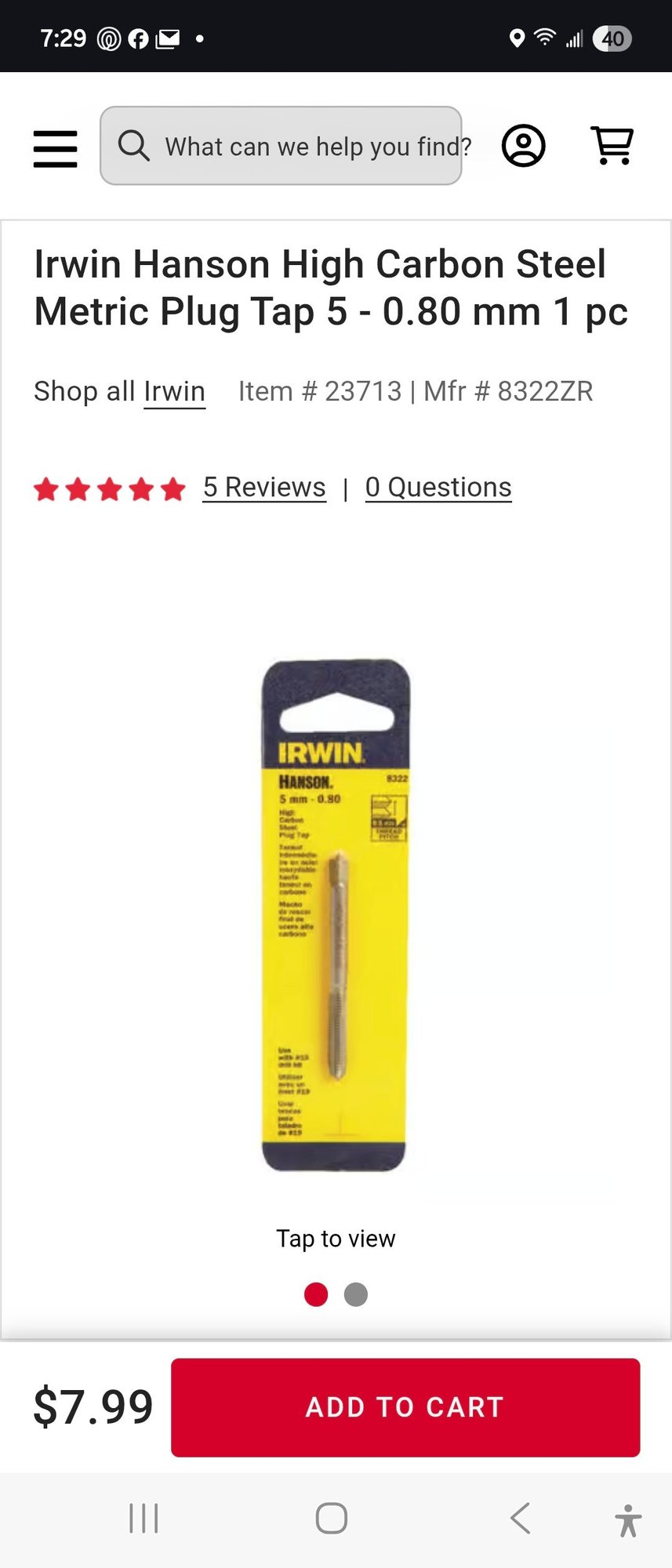

Are you referring to tools like these?
no a thread chaser is different. It does not change tolerances like a tap can. The go / no go gauge is not cut to trap de bris when cleaning a thread. This seems to be the best option - cut a bolt which doesnt impact the threads and allows one to clean the threads.

Neither one of those tools are a thread chaser. Taps shouldn't be used to chase threads, they can remove parent material.
The plug tap is to cut threads all the way to the bottom of a hole.
The go / no-go gauge doesn't clean threads although it would tell you if you removed too much material after chasing the threads with a tap.

just buy a bolt and nut. Cut with dremel across threads and pow it is born. There are some good YT videos on how to make one. I use the nut to make sure it works before trying on car. Get a good quality bolt. I used stainless one.
