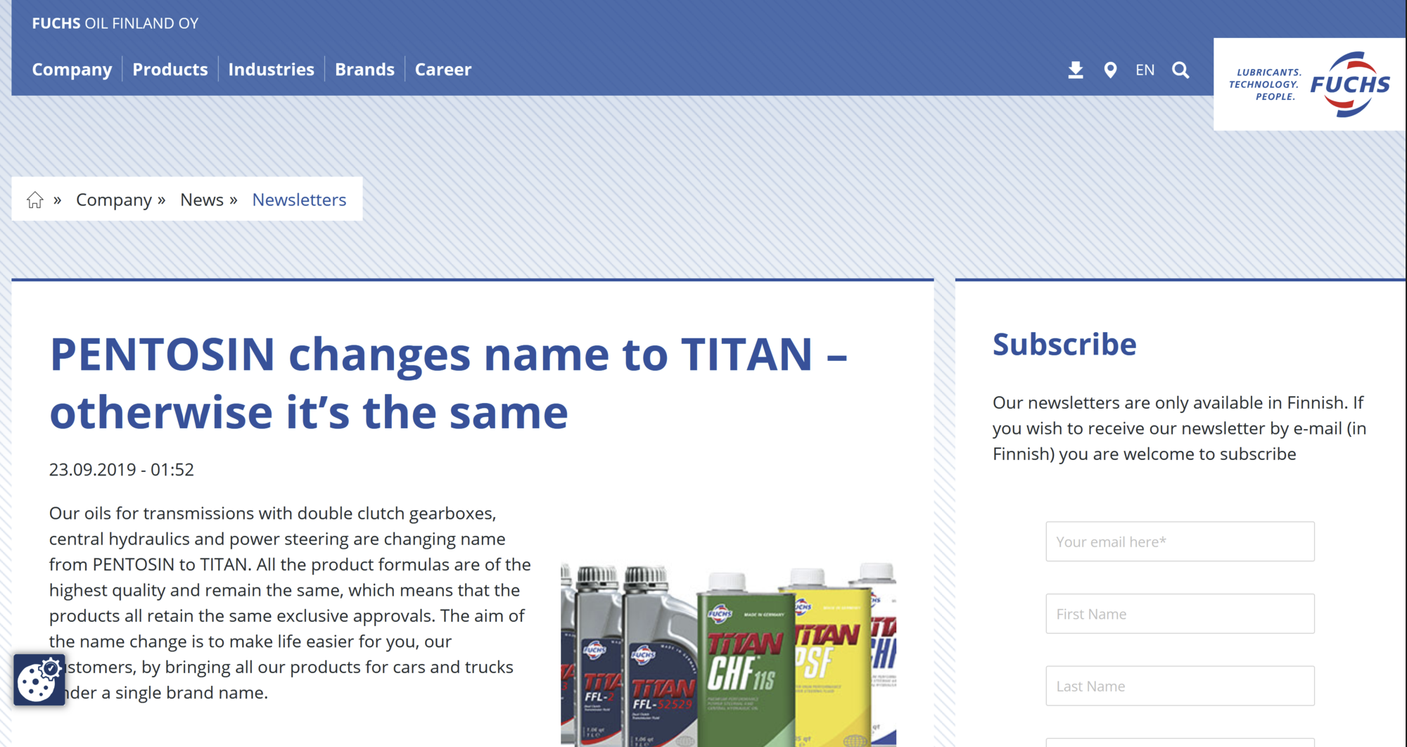

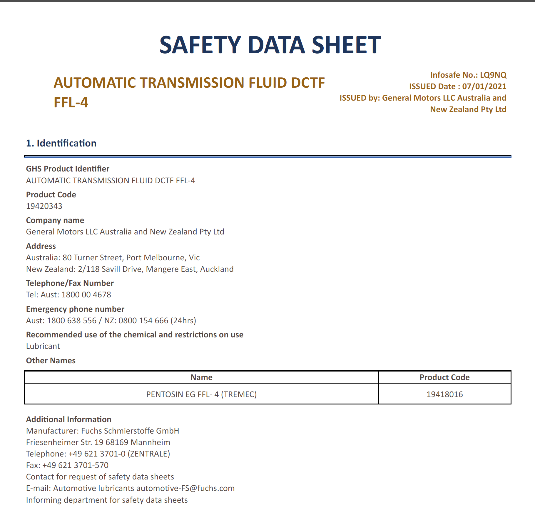

The original Service Manual indicates Pentosin FFL-4 and in another place Fuchs Titan FFL-4. Maserati MC20 manual says Fuchs Titan FFL-4. There is literature that shows that Fuch Titan FFL-4 is the same forumla as Pentosin FFL-4. Its attached. Furthermore, we know that Fuchs makes the ACDeclo FFL-4. They were contacted by a forum member asking it its the same. Fuch's declined to answer, but the point is they acknowledge making it. That is also attached. It does not mean its the same, but..... finally, there is an Australian product data sheet for ACDelco DCTF FFL-4 and in the 'other names" section is lists Pentosin FFL-4. Its attached. So if Pentosiin and Fuchs are the same, this would seem to suggest that the Delco DCTF FFL-4 is too.

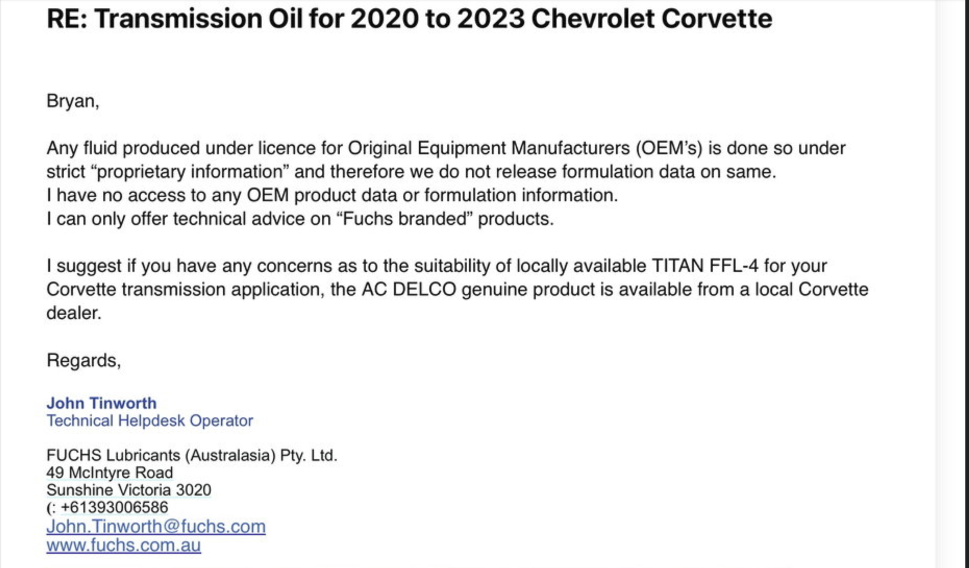

Well, since I have no insider info, I can't comment on what actually happens in the "factory". But according to the TREMEC in their original literature in 2020, they recommend using Fuchs Titan EG FFL-4 for Tremec. And Fuchs responded to an inquiry about the EG lettering and said its the same product as Fuchs Titan FFL-4. Its attached.
Didn't GM build a new plant and take over production of the TR-9080, under license from TREMEC? That was supposed to be completed in 2022. If that happened, then its GM that putting in whatever fluid is going in at the factory.
