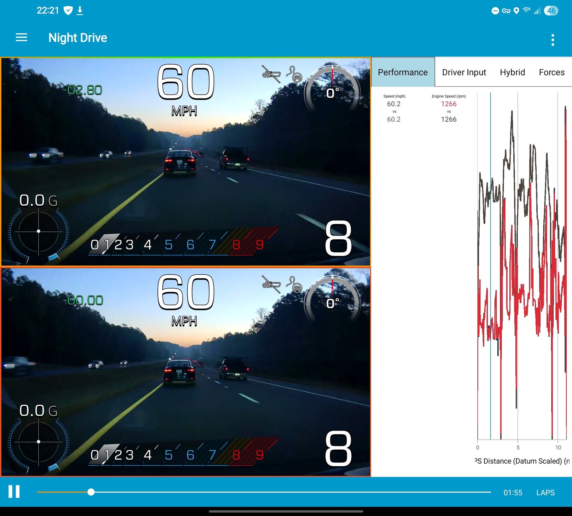

This is my overlay in AliveDrive in my 2026 ERAY. I have no clue what the crossed out icon in the top right means.

^ I believe the crossed out track icon means PTM off.

Matthewstorm's Avatar
Matthewstorm
Joined: Oct 2017
Posts: 2,004
Likes: 328
From: North Carolina
Actually I think it means I'm not on a Track.

Old Oct 29, 2025 | 01:48 AM
Matthew Griffin's Avatar
Matthew Griffin
Joined: May 2020
Posts: 297
Likes: 178
From: Colorado
That crossed out icon means PTM is 'off'.
