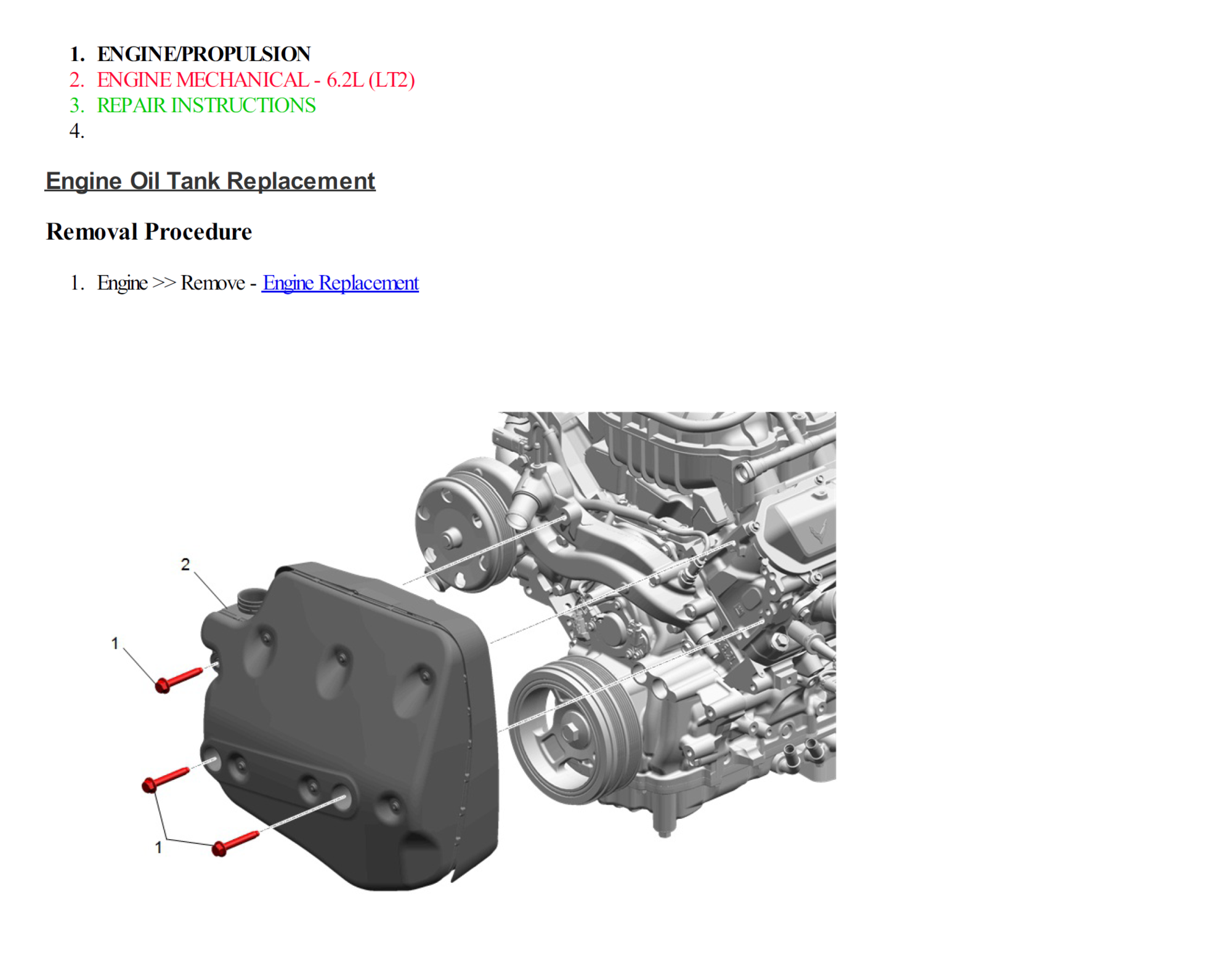

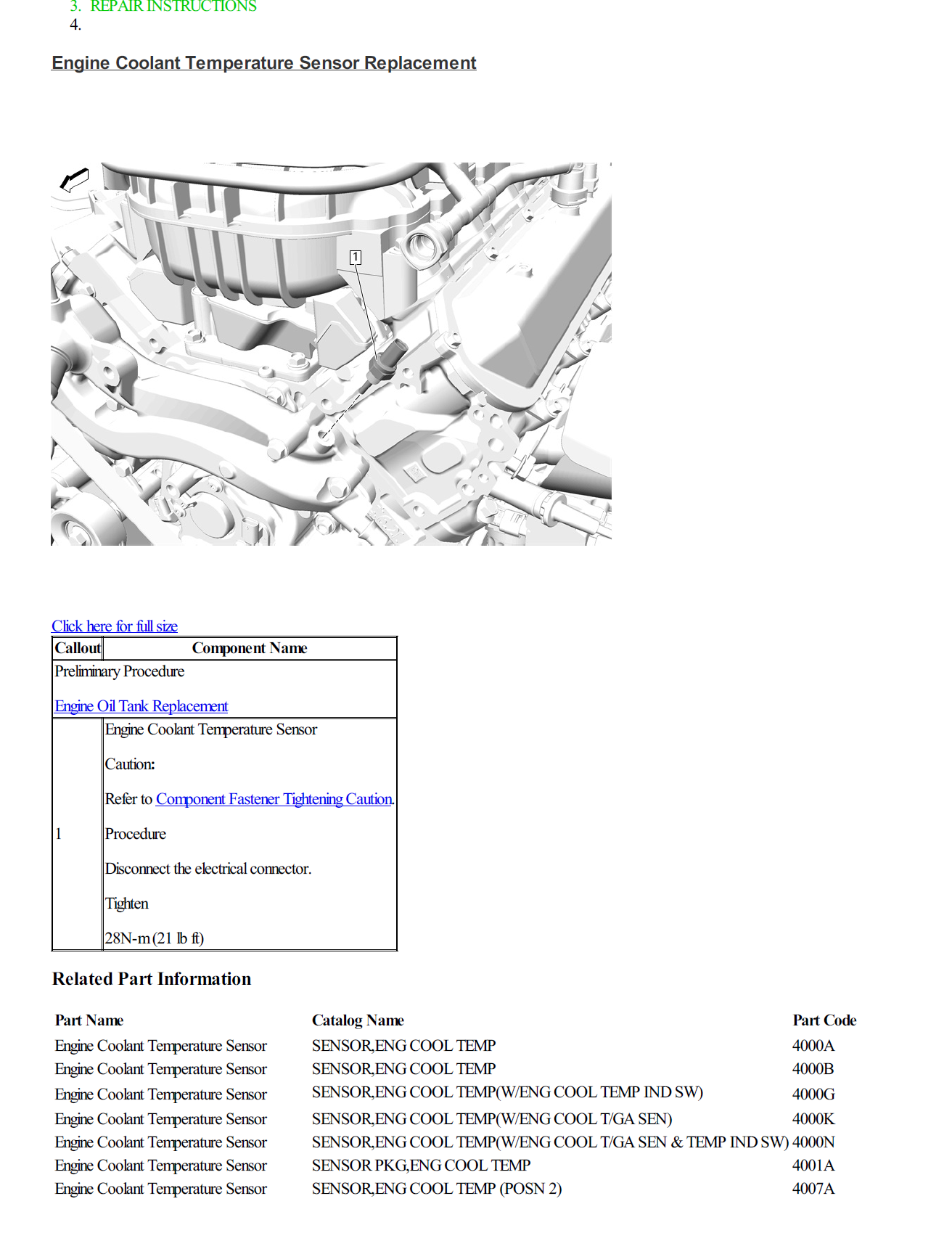

According to the procedure in the Service Manual I have (attached), not only must the engine be removed, but the oil tank must be removed from the engine to access the sensor apparently.
The attached procedure for the sensor replacement is a mere 1 page and looks sooo simple. Except for that deceptively innocuous preliminary procedure "Engine Oil Tank Replacement". And, the very first step in the Engine OIl Tank Replacement procedure says Engine-Remove.
Just three simple steps : 1. Remove the Engine. 2. Remove the Oil Tank. 3. Replace the sensor. Then just put it all back together.

Earlier I said its located in the "normal place". But that was ambiguous - since normal is subject to interpretation. Its located on water pump, just above what is called the water pump outlet pipe that is pushing water to the engine oil cooler. I think I mentioned before there could be one more if you have Z51, and a third one if you have the overseas V09 option. But I think the one of interest here is the one on the water pump.
So...in a earlier conventional engine, vintage engine like the Chevy 283, the temperature sensor is located in the water jacket on the cast iron intake manifold on top of the engine. It would be nice if they could have mounted the temperature sensor on the C8 intake plenum, but unfortunately they can't. The intake plenum for the C8 Stingray is plastic (or composite actually). I don't think there is a water jacket there - looking at images in the Service Manual I don't see evidence of that. So, the temperature sensor can't to there. Instead they put it on water pump, which might have been accessible, except the oil tank completely covers it. The engine obviously has a water jacket, but I'm not sure where they could have put it that would be accessible without removal of the engine. The other two sensors, when they are present, are in the coolant lines and I think are accessible without engine removal.
