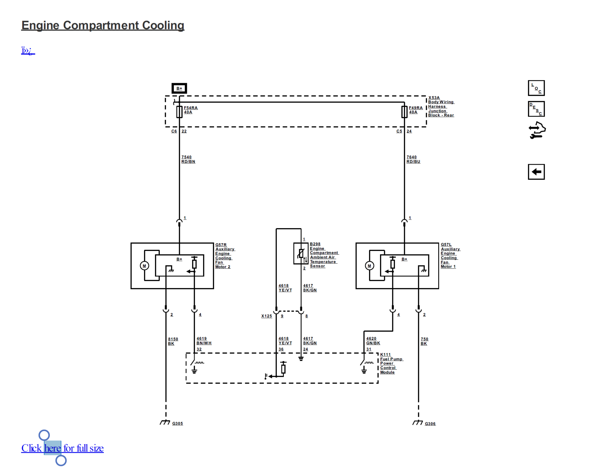

Attached is the schematic for the engine compartment cooling fans. Note that each one is protected by a 40 amp fuse, giving an idea of the current they draw. The directly controlling module is the Fuel Pump Power Control Module, and the primary sensor it uses is the Engine Compartment Ambient Temperature Sensor. But of course the car is complex and (not shown in the schematic) the Fuel Pump Power Control Module communicates via the network with the Engine Control Module and that has access to the other temperature sensors in the car (there are several). So the issue could be in a lot of places. With no code its difficult for them to solve it.
