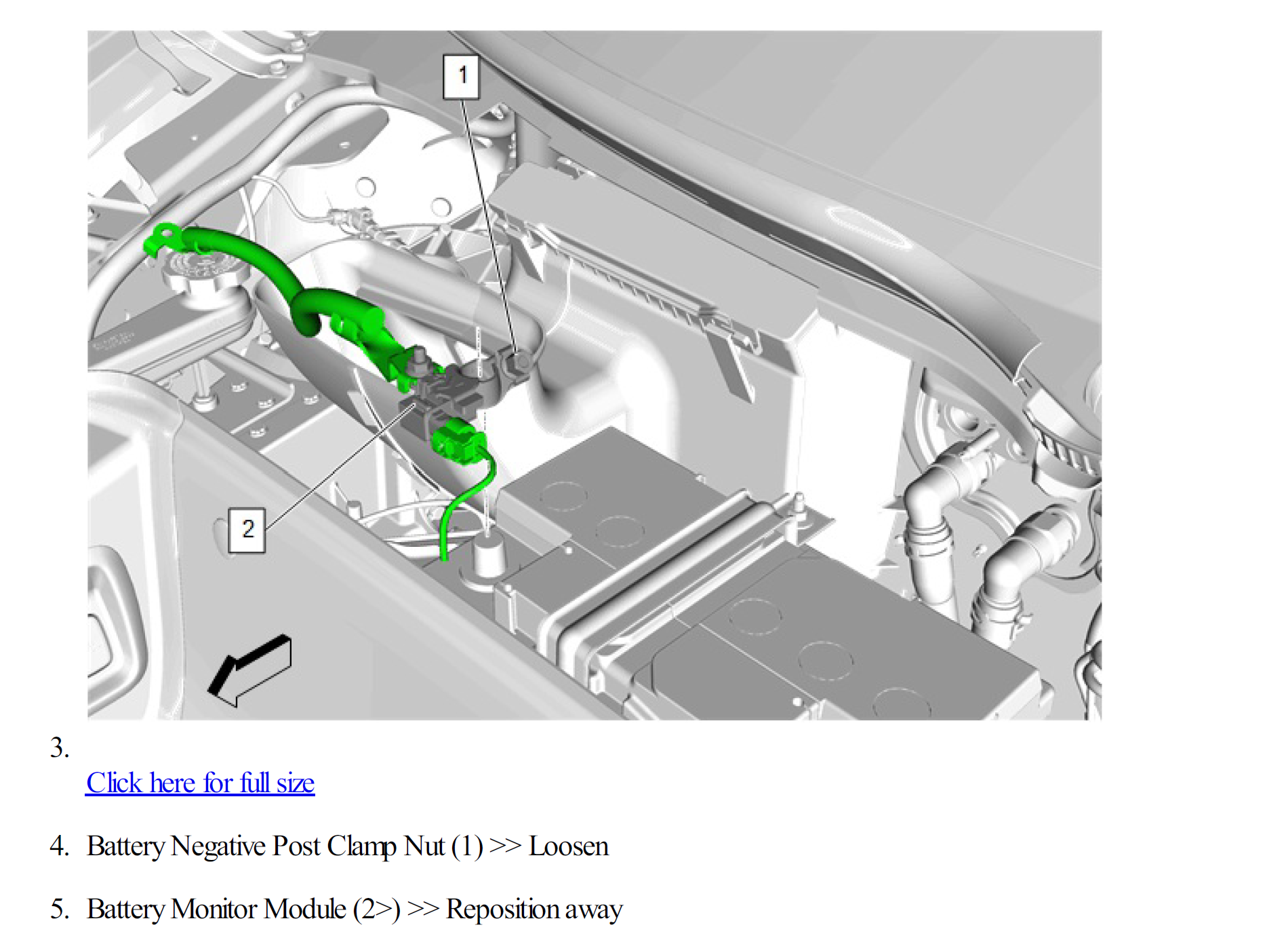

Do I have to disconnect the BMS sensor before removing the negative ground? I thought maybe I could leave it attached to the cable and just unbolt it. But if I have to first disconnect it, is the BMS connector release facing the frunk bin?
No just pull the negative cable off first. You can leave the sensor attached.

The procedure in the manual says remove the negative cable first. It calls the procedure for disconnecting the negative cable. The battery monitor module is connect/clamped to the negative post of the battery. The negative cable is connected to the battery monitor monitor. You can see that in the image. You loosen the clamp on the negative battery post, and move the cable and connected battery monitor aside. You will notice also that there is another wire connected to the battery monitor module. You do not need to disconnect that.
The battery saver is not needed, and may cause an issue - I don't know how it works or how it might interact with the car. I would not use it on my car.
