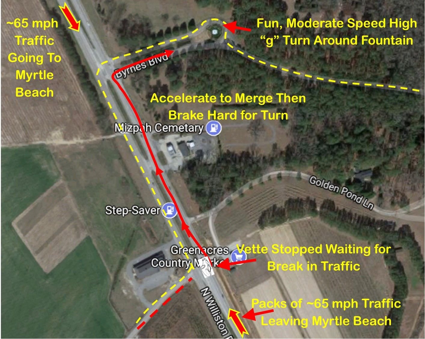

If that pad material is not uniform you get stick/slip friction and high frequency pad vibration that causes squeal especially on light slow speed stops. Also with performance pads it's important to periodically apply the brakes aggressively to maintain the uniform layer on the rotors. I do it at least once every day when i slow from a ~70 mph traffic on a 4 lane highway as I enter our 25 mph limit rural road. Folks behind don't have to slow for me as I turn and it's FUN!
Note I use Z-Mode and the DCT will automatically downshift several gears, rev matching each. Great sound!
