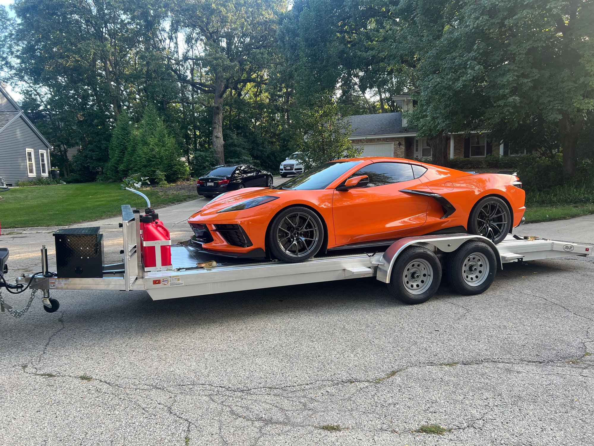

I have an Aluma open car hauler trailer that is the low profile model. 8216 LP Tilt
Given the about 60-40 rearward weight bias, should the C8 be placed on the trailer backwards to avoid too much rearward weight bias on the trailer?
Anyone with experience?

16’ Trailer is kinda crappy for these cars.
ideally you want the door edge centered between the axles but I’ve loaded it pretty far back on the trailer as well and never had it tow weird. I have a 20’ aluminum trailer.

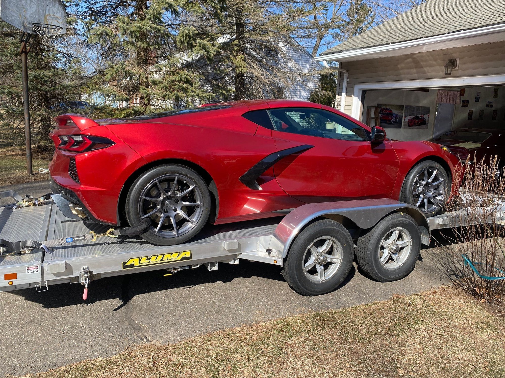

Same here. Aluma tilt, back on to get the weight distrubution correct. As a side note, I have a soler controller and put it in valet mode to keep the throttle response as slow as possible. I find that it really helps when backing on the trailer. I tilt the mirrors down to see how the tires align with the deck. Use the front lift and a couple of 2x6s to keep the nose off the ground (18 in rims for tracking).

This is where my car sits relative to the deck

Is that an 18 trailer?

Yes. I think what’s important is where the back of the car is compared to the trailer axels. Trailer tows straight with this loading.

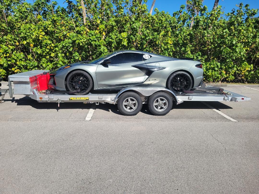

I have the 18 tilt. Drive on.
