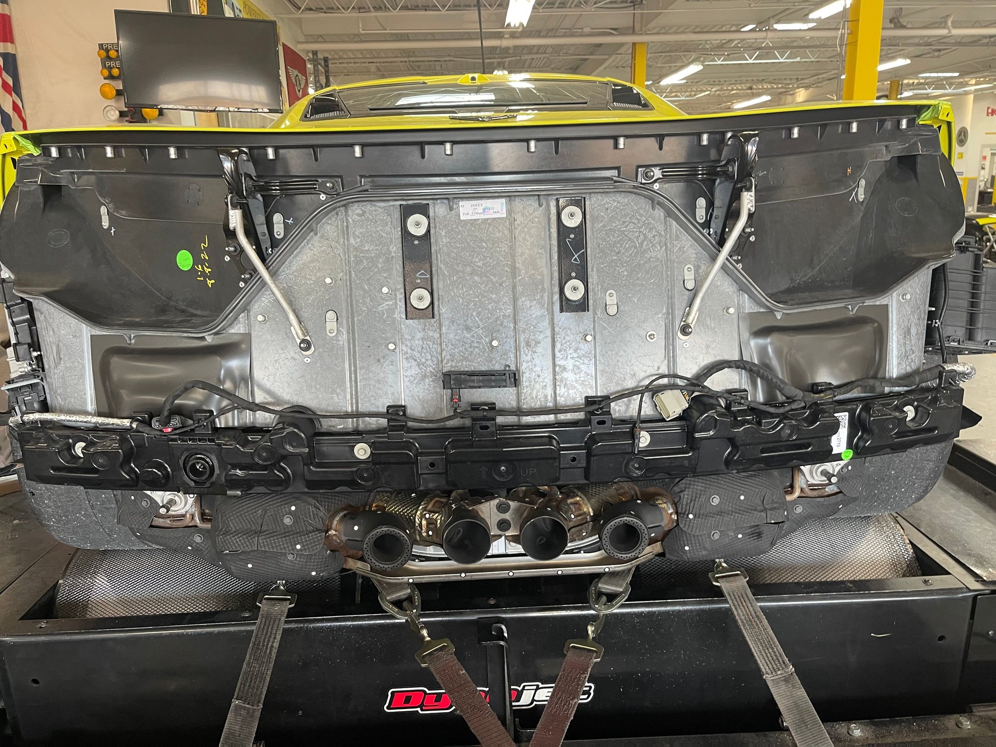

Initial dyno runs are complete, and the Z is torn down!
Any guesses on Stock WHP?

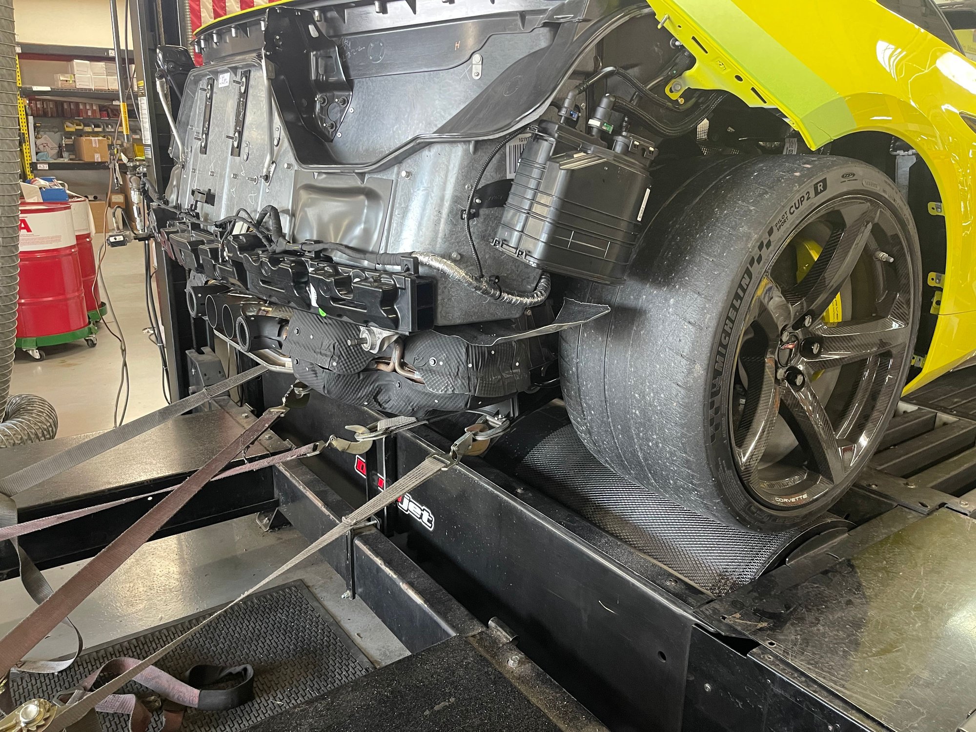

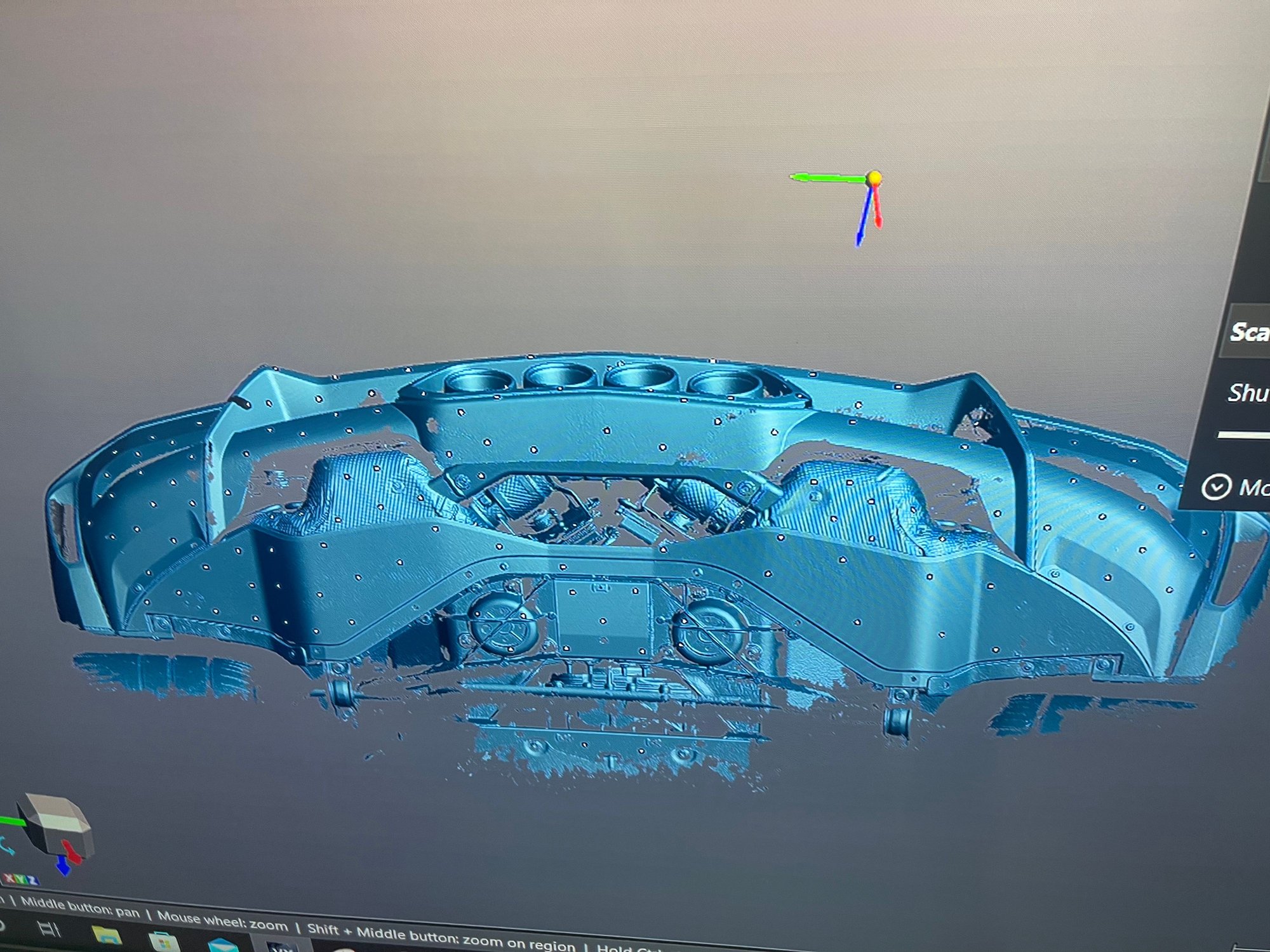

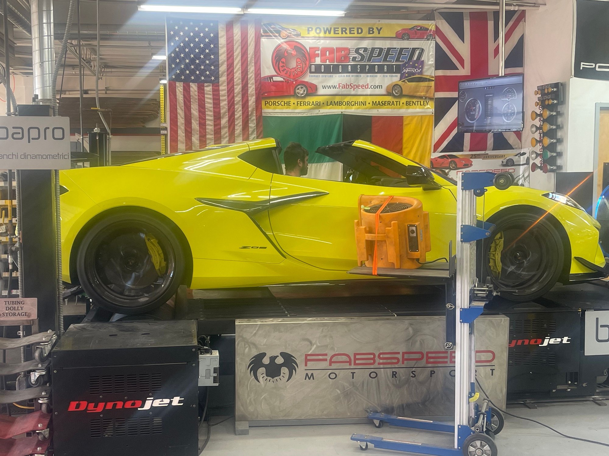

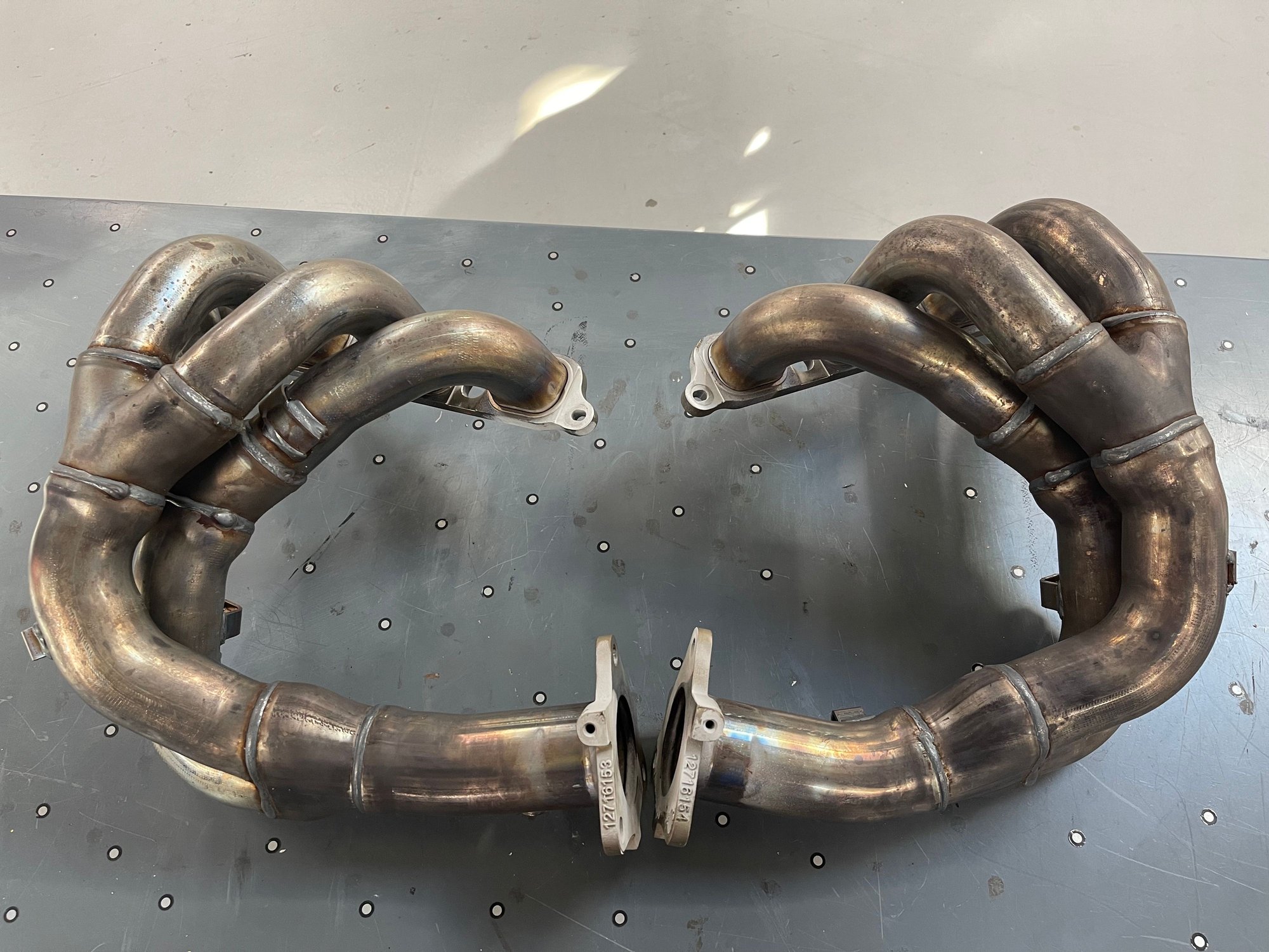

Just burning the midnight oil. Fabspeed engineering team “Exhausted” but stoked. The Z06 is awesomeness …….big-block Ferrari 458 is an understatement.
Completed these tasks so far :
Dyno bone stock C8Z06
3D scan develop CAD model for HJS German racing catalytic converters - install and Dyno with stock Z06 catback valvetronic . Z06 engine really liked the high-flow cats. Pops , crackles, flames and overrun its an IMSA GTLM car.
Develop rear lightweight non valved “Supersport” system - completed . Dyno again with stock cats and HJS cats

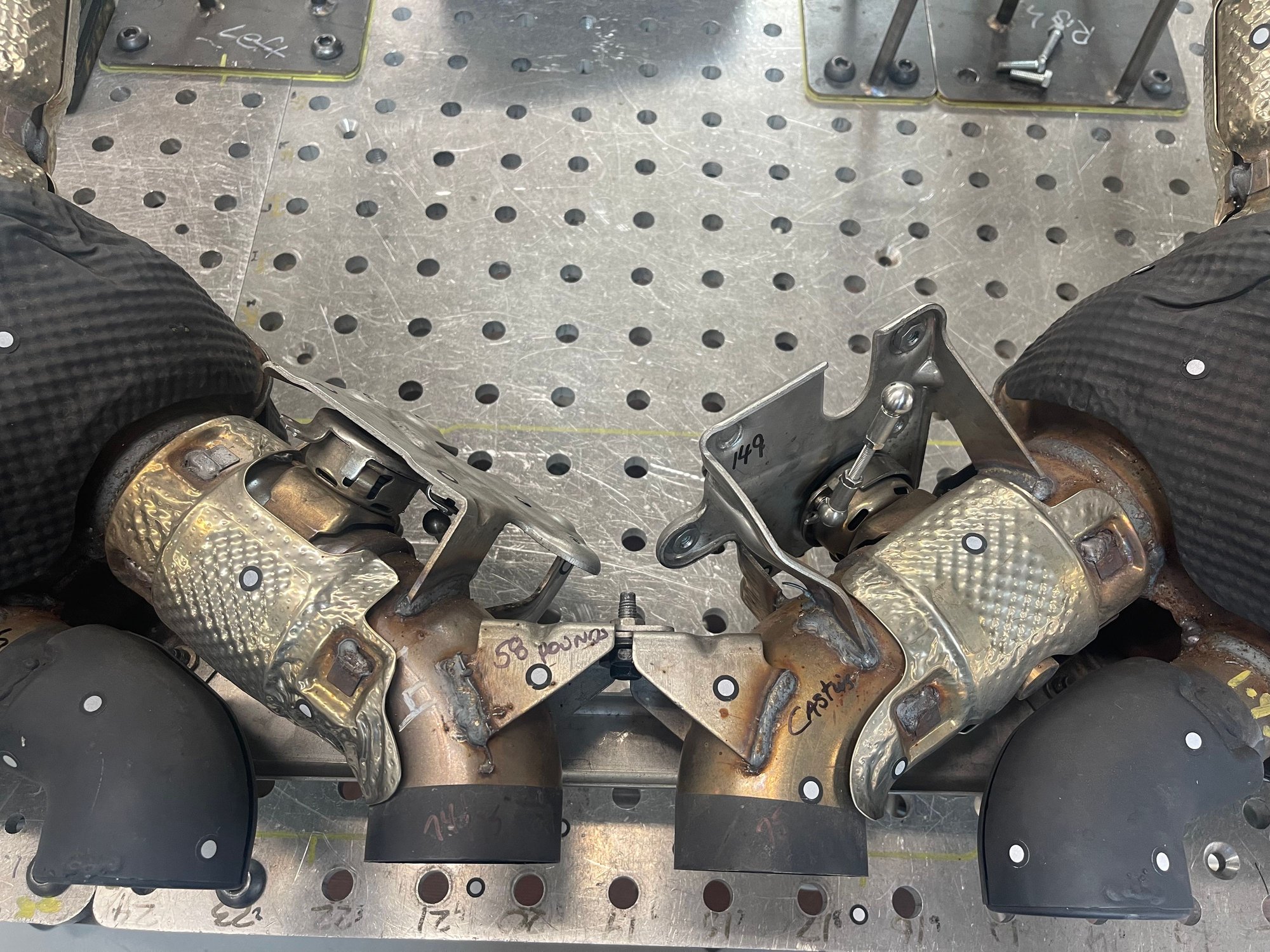

working on valvetronic lightweight system. FYI C8Z06 exhaust valves get cherry bright red on the Dyno and open and close constantly via load dictated by throttle. No cheap Asian exhaust valves can take the heat. Tenneco USA quality!
working on NASCAR tri-Y headers with 625 Inconel heat shields. FYI- GM wrapped the insulated the OEM headers, catalytic converters and pipes to rear mufflers a lot more than regular C8 cars. Fabspeed Motorsport will go beyond their thermal management standards to ensure radiant heat doesn’t damage Z06 ancillary components. YOU cant run the exhaust or headers with no thermal retention.
Working on carbon and Cnc aluminum pieces.
Working on a Ferrari style LED steering wheel upgrade.
Car sounds and accelerates great and is beautiful ………..we truly believe GM underrated engine power. Its a monster. We have a Z07 equipped car. Its a beast. I want one ……trade a low mileage GT3 for a Z06 70th anniversary HTC.
Fabspeed motorsport usa worlds very 1st company to DYNO develop performance systems for the C8Z06. Development partners HJS Menden Germany, Helical UK, Burn stainless, Ametek,. Looking for development and resale partners JOE@FABSPEED.COM
3D laser scanning . Scanned everything developed models. Next week GT4RS.

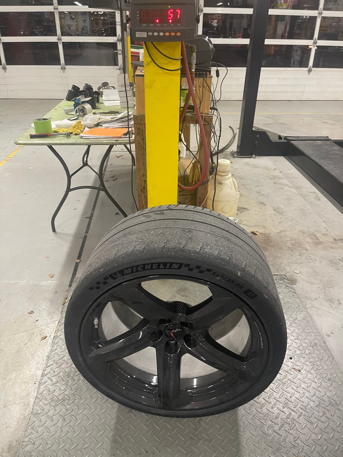

Rear wheel 57pounds total. tire is the heavy component . Wheel so very lightweight. 21” by 13wide 345/21 Fred flint stone wide tire! CARBON WHEELS & MICHELIN CUP2 R TIRES this aint no regular corvette . This Z06 is a Nordschelfei Road America, Road Atlanta machine . IMSA should remove BOP and let her run WFO.
Notice support struts for rear Z07 wing structural support. Developing IMSA FIA GT swan neck spoiler up high too!

Mikes Z06 makes way over 700HP. I personally believe GM powertrain understated the true power output from what we are witnessing. I was considering designing a GT1 style rear deck scoop to force cold air into the OEM airbox but i don't think guys will cut their cars decklid.
Michelin CUP2R - Z06 so wide almost did NOT fit on Dyno-jet rollers. This car is GM desired would blaze a 6’45sec time.
Dual electronic variable action exhaust valves
Z06 TRI Y headers. 2” 50mm primaries and then 2.25” 57mm secondary tubes. Mandrel bent hydro formed

The cars are SAE certified and you have to dyno them in 5th which isn’t 1:1. Did you adjust your dyno?
I'll admit, this is the only part that really caught my attention. From the factory, it looks like they already have Tri-Y headers. Is there anything stopping you guys from making the headers themselves from Inconel outside of price?
Second, there is a unique opportunity here with the engine placement and the exhaust location to come up with a rather unique 180-degree header design and really give it an absolutely wild exhaust note. Just saying.
