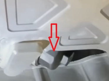

The Z06 has a cartidge filter like I have on my vehicle. It is held in by a plastic threaded retainer that will not shake off.
This is the retainer on the Z06:
