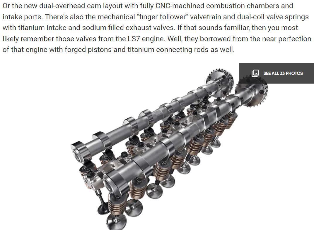

I had to chuckle at this from Motor Trend - especially in light of all the LS7 comments in this thread. I went through the early C6 Z06 broken valve spring issues that GM was able to correct fairly quickly, as well as the later valve misalignment issues. Valve springs in a high RPM motor (the LS7 was 7000 rpm) are especially critical and are often made of exotic materials that may have vulnerabilities if not operated in the regime for which they are designed (break-in, operating temperature, unloaded rpm, etc.). You could probably design a heavier, more durable (operator proof) spring, for example, but at the expense of optimum performance. I am only slightly concerned by the early LT6 failures (for whatever reason), as I know GM will fix the problem if there is one - like the LS1 ring tension improvement, early LS7 valve spring improvement, LS7 needle bearing failure fix, and - not so much - the LS7 head machining and dropped valve issue. I suspect there is an operator learning curve that will also help Hopefully early failures result in early fixes.

Originally Posted by mfain
Just an FYI, the LS7 did not have forged pistons.

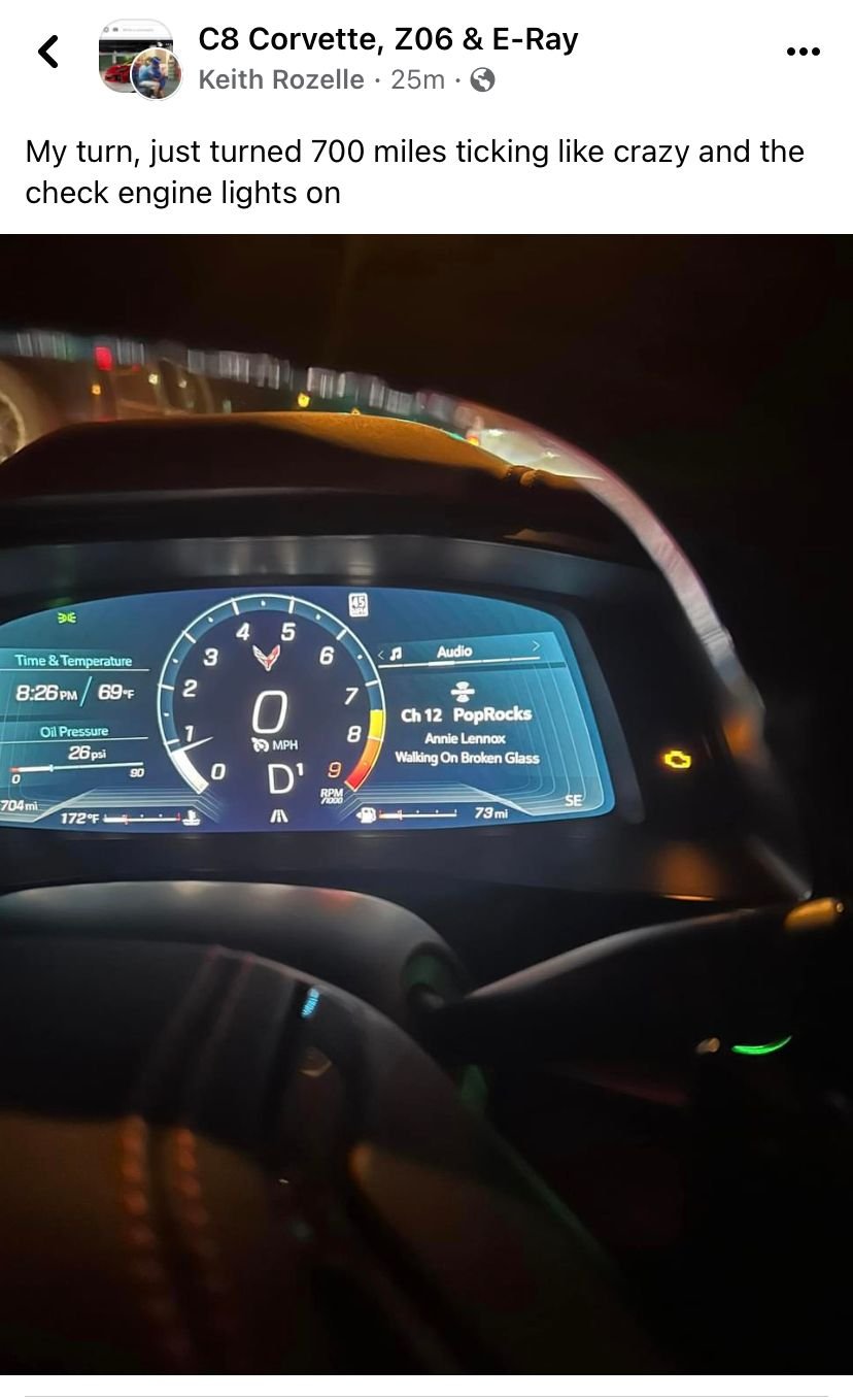

I would like to see the engine codes on the last reported failure. If they are misfire related on one bank like some (all?) of the others, and with the "ticking" sound, I still suspect valve train issues. Valve train components built to sustain 6400-7000 rpm are one thing - 8500 rpm is another. Exotic materials with closer tolerance on things like operating temperatures are required. I have been living the C6 LS7 "conspiracy theory" for 12 years. I am not anxious to go through that again. If one of these failure cars was mine, the first thing I would do is pull the valve covers and run a borescope down the spark plug holes and take a look. As far as I know, owner investigation (without disassembly) of a failure should not void your warranty! Inquiring minds want to know. There may not be a real issue, but if there is, I would appreciate GM being forthright and informing customers of the problem and the fix so we can get on with enjoying the car without lingering doubts about reliability. We know there have been failures, but keeping a secretive lid on the causes does not instill much confidence.
